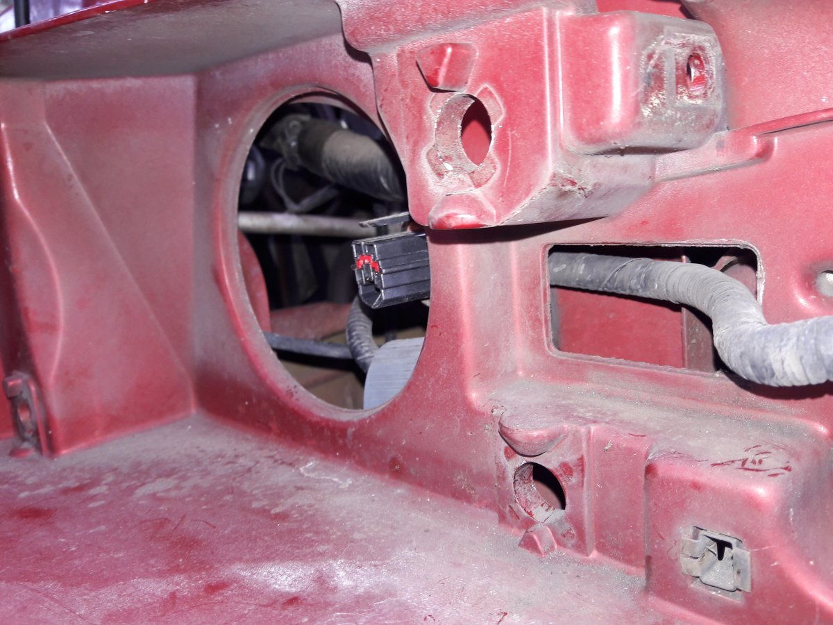

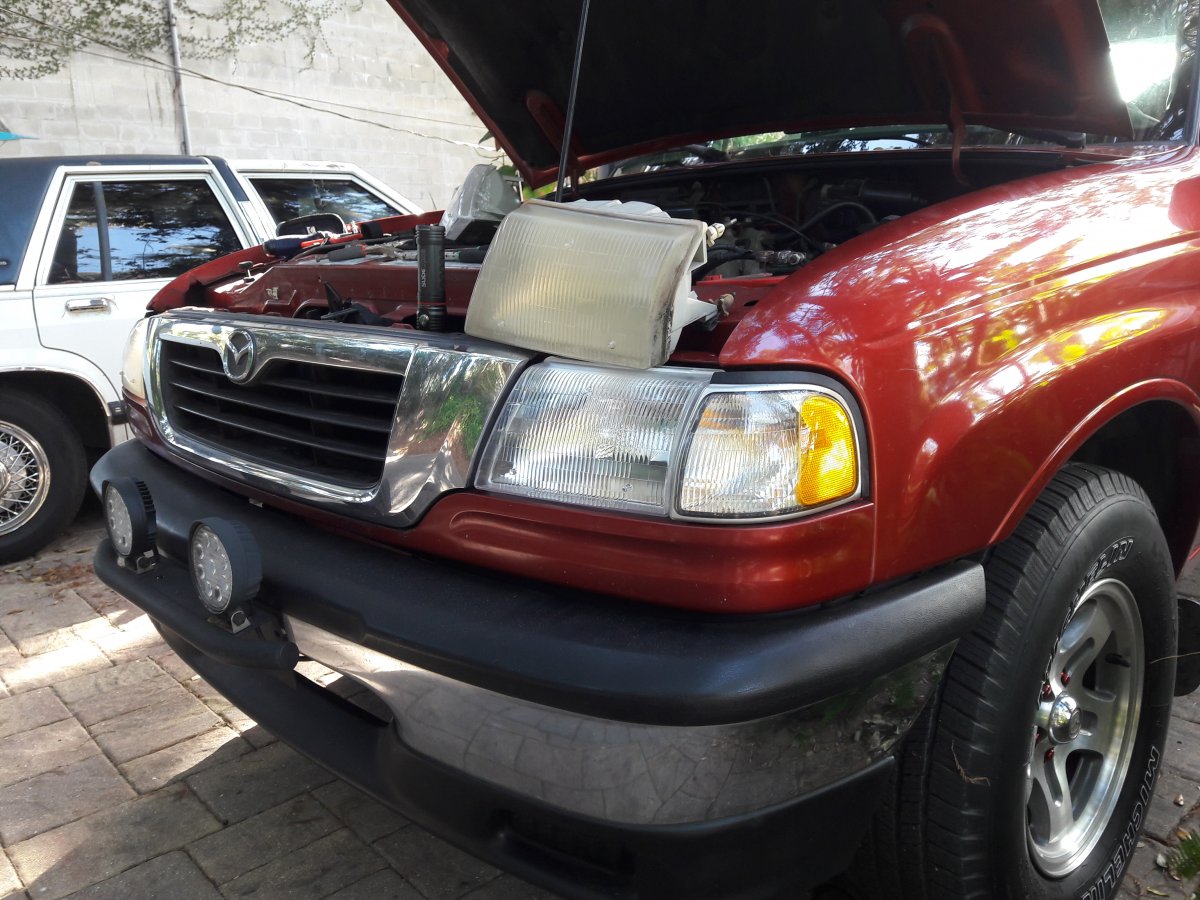

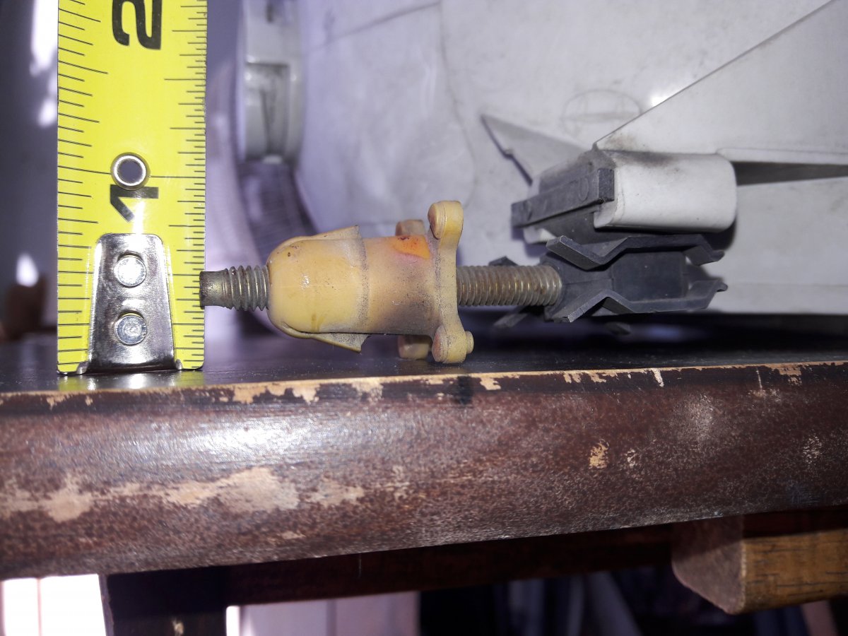

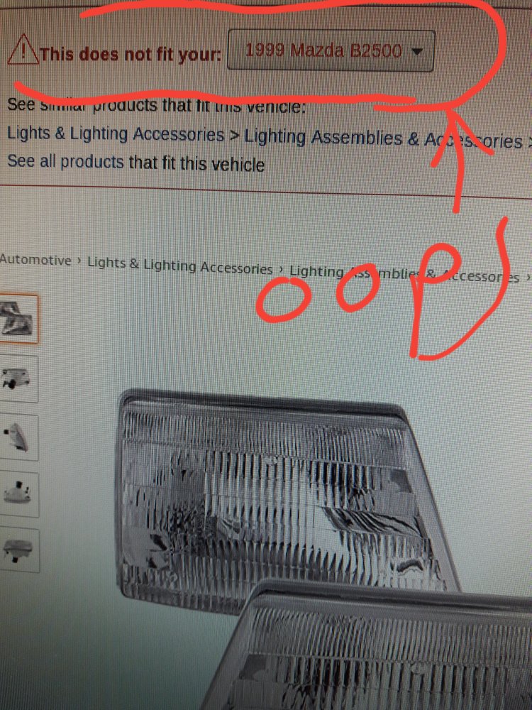

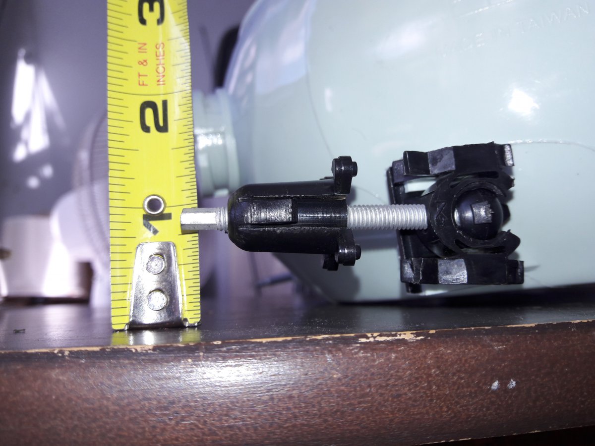

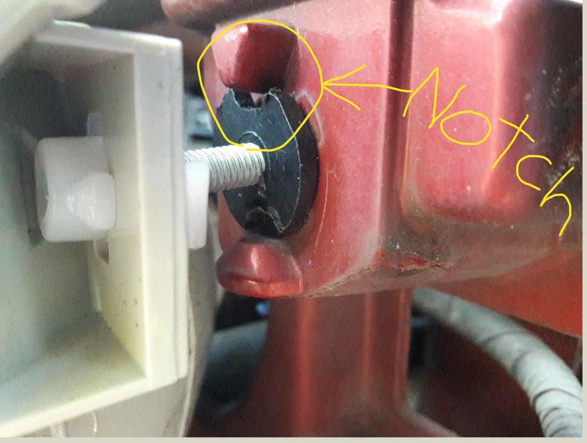

My fault completely for not doing the "check size fit for your vehicle" before ordering from Amazon. I assumed the Ford Ranger headlights would fit, but the clips are made different and the attachment positions are slightly different. I have a '99 Mazda and many parts are interchangeable with Ford, but with any kind of body parts, it must be double checked. See pics

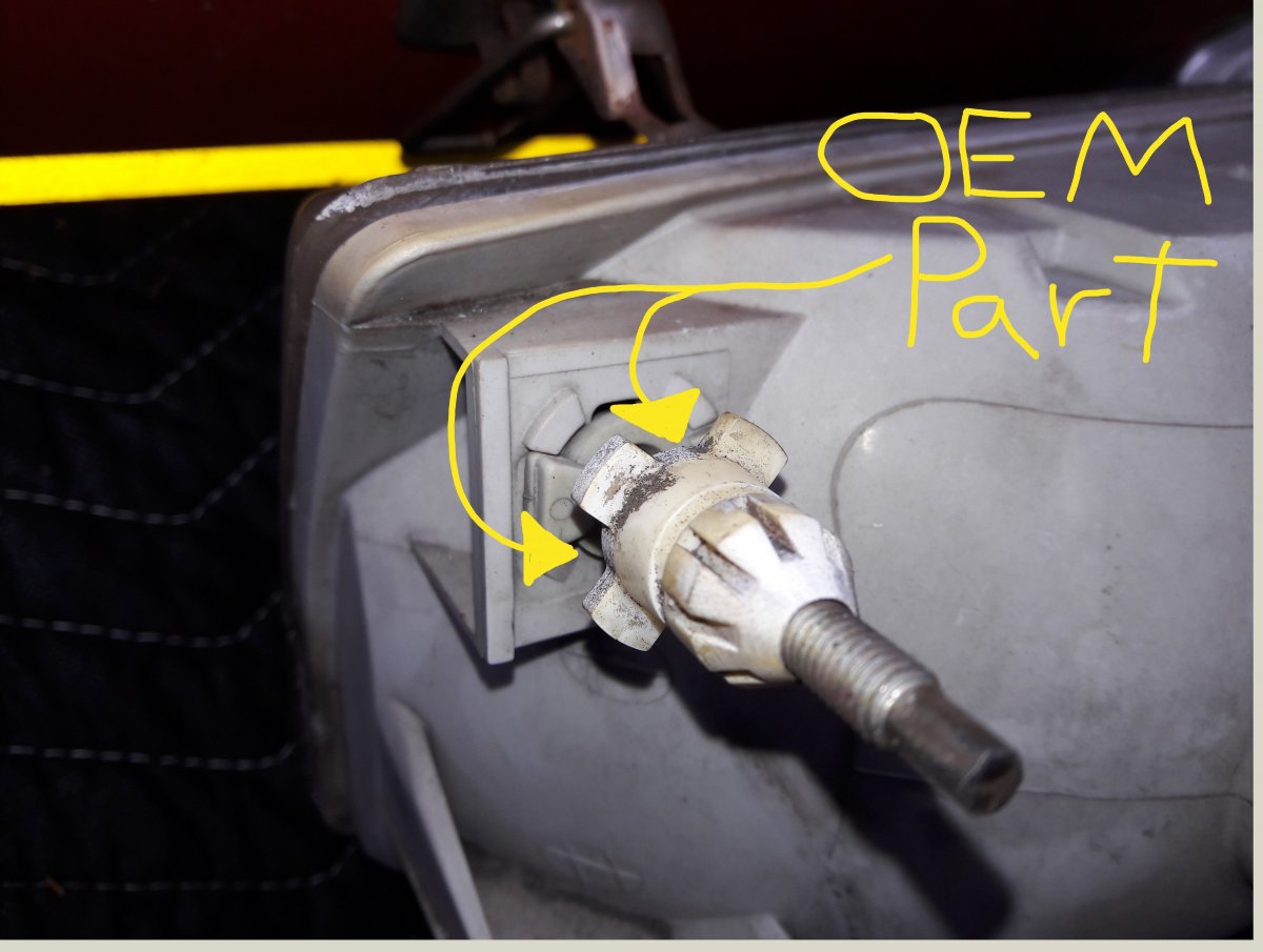

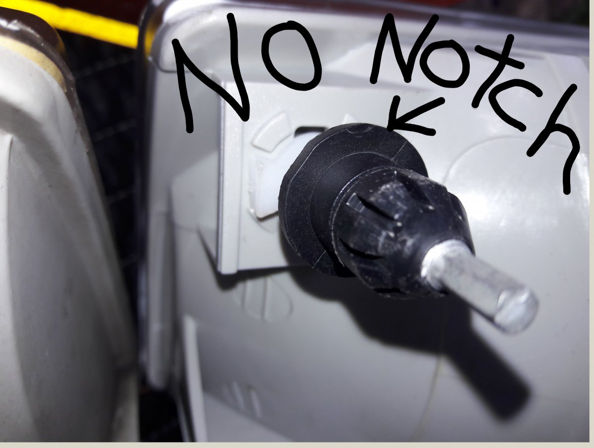

Update: correct Mazda headlights put in with minor adjustments. Parts from Amazon did not have adjustment notches and would not fit into space...needed to be notched, see pics
  • Amazon offers a way to check fit...opps I just assumed Ford headlight would fit Mazda.jpg

  • Original factor OEM headlight with notches to allow adjusting of headlight beam.jpg
