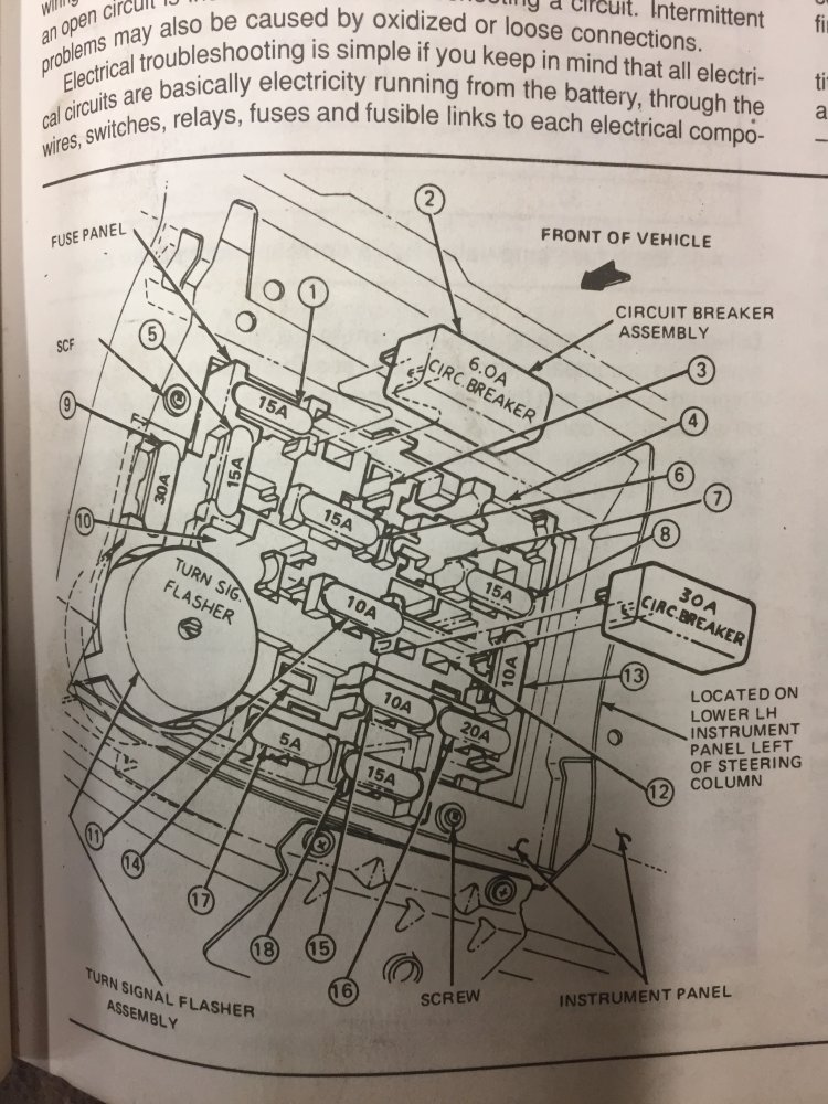

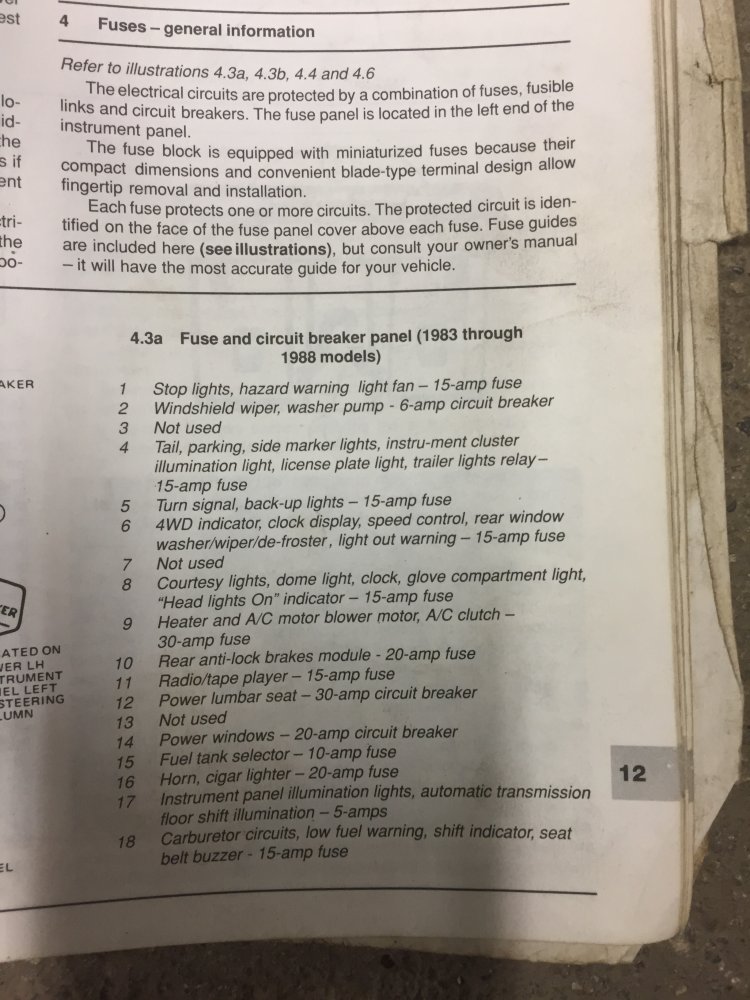

Fuse box panel amps and fuse box assignment please, Thanks Steved67
Haynes manual.
