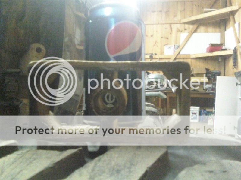

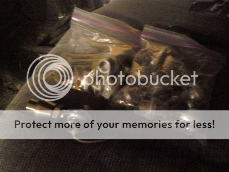

Got these off of Craigslist last night. $10 for the set of 8. 4 LH and 4 RH.
They are smaller though. The weld in bung is for a 1" ID tube and the hiem uses a 1/2" bolt. Not sure what I am going to do with them yet. He bought them from ballisitc fab so I need to look up more info. For $10 I could not pass it up. They might be good for a rear ladder bar...
My next project is to make new tube radius arms. I am pretty sure these will work for that task.

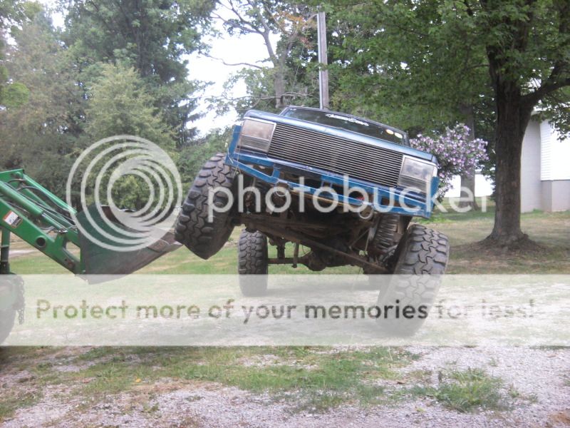

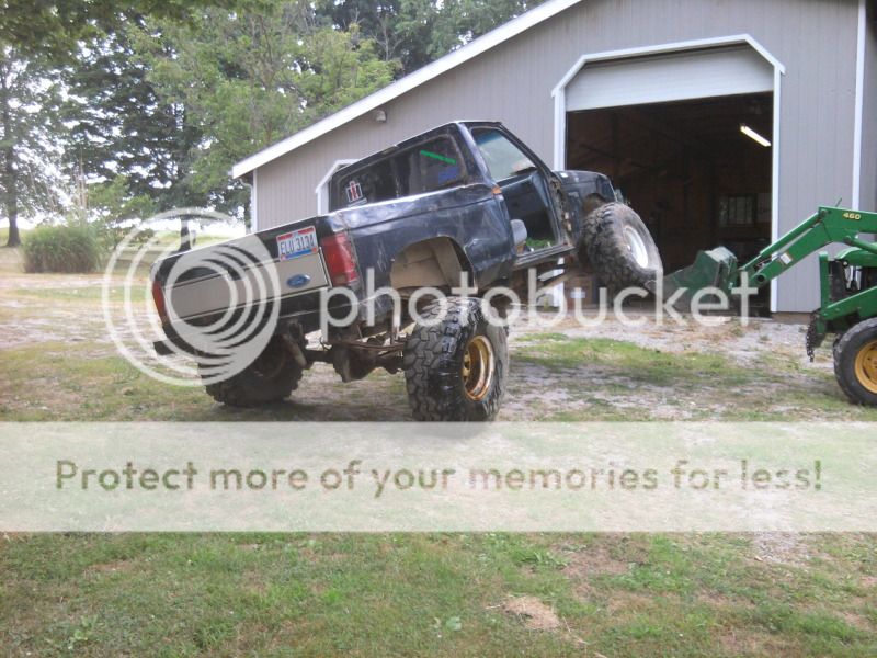

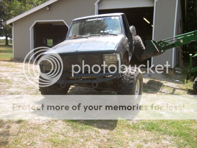

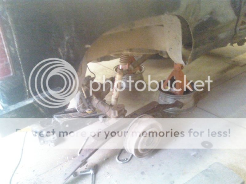

Two days before he was born, I picked up some stock 94 ranger rear leaf springs. Mine are super soft XJ ones. I am trying to get more flex out of my front end. 90% of my issue is probably due to my stock arm bushings, but I wanted to try stiffer rear springs and see what happens. They were $40 so why not. Now I just need to find the time to button it up and see how it does. Doubt it will work tho haha.
Also, with these new springs, I will be using the factory block again. Turns out my aluminum 1" did not hold up. The centering pin was gone haha.

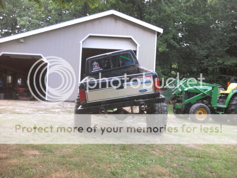

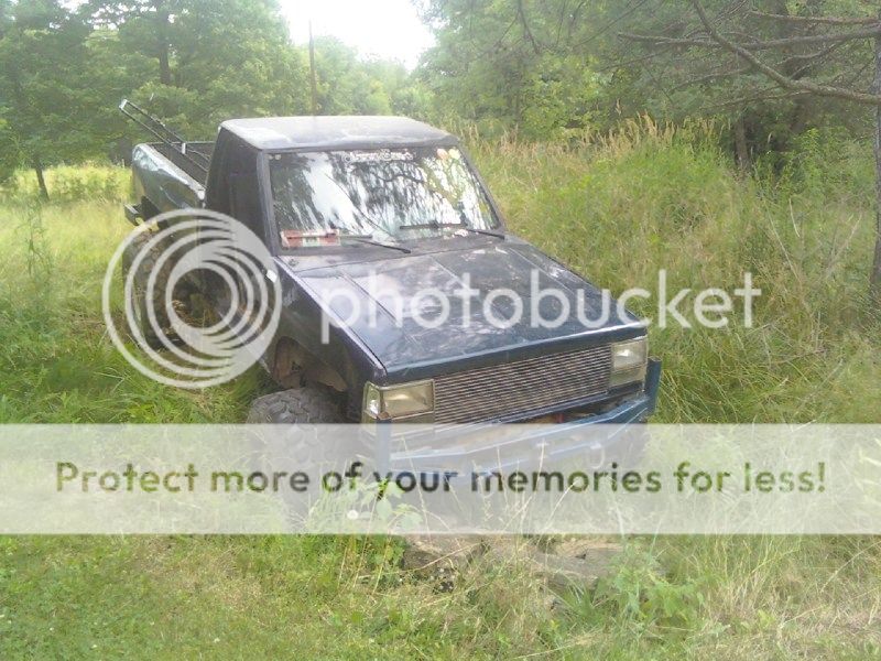

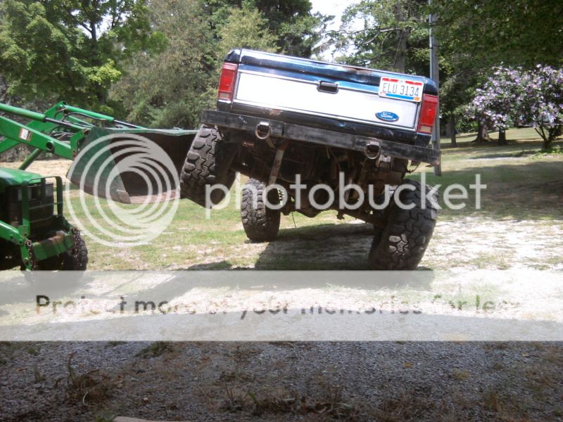

Also, before I took it apart, I decided to blaze through my field. Due to the tall grass, I miss judged the culvert and nailed it. Bent my steering wheel a bit and I didnt have a front drive shaft in. An embarrassing stuck...

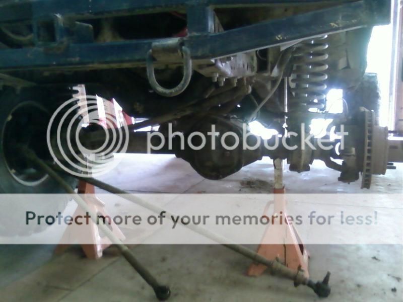

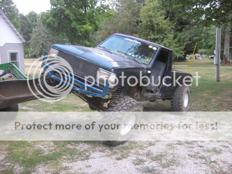

Got the stock Ranger leafs back in. The front does flex better, but I would not call it flexing. I am running 190ppi coils. The front should tuck easily.
I am going to get some tubing quotes from my tube vendors tomorrow. I am just going to cut the stock arms and sleeve them. Then use heim joints and make a new mount/cross member.

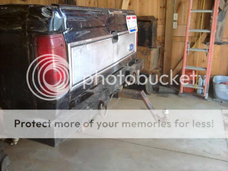

Also, since I dont currently have a tow rig, I welded on a 2" receiver to use as a step and to move my trailer around. Hopefully I have another tow rig soon.

The frist step is to get rid of my $15 junk yard steering off of a 1979 F-150. All of the joints are shot and most of the threads were shot. So I welded them instead of using nuts. It was only supposed to be temporary. But it worked (up to 35 mph) so I have been running that setup for 1.5 yrs. So I have pulled that off and I am going to make new steering. The current setup will become my emergency spare.
I ordered 1.5" OD x 0.25" wall DOM tube today. I got 9 feet for $65 shipped to work.
I am going to be using 4 of 8 rod ends/hiems i got of CL for $10. They are 3/4" Ballistic units with 1/2" misalignment spacers.

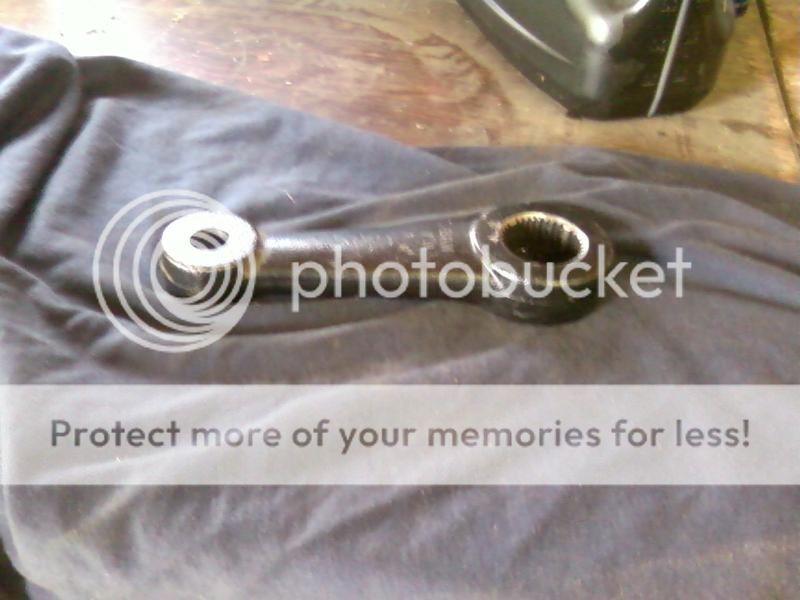

I will be drilling the tapered holes in my knuckles out to 3/4" OD. Have not figured out how to do that yet. I can bring them to work but I want to find an easier way. I will not be using the misalignment spacers on the the rod ends that attach to the knuckles.
For the drag link, I am going to use 5/8" bolts. I will be drilling the spacers out to 5/8" as well as my 2wd pitman arm. The drag link will attach to the cross tube/link via tabs.
I hope to keep it under $120. Should be an easy budget.
