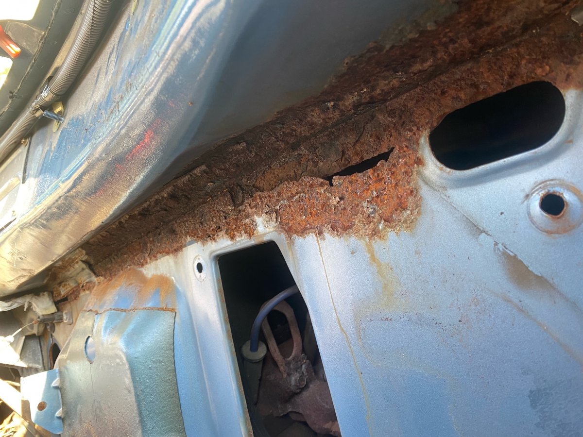

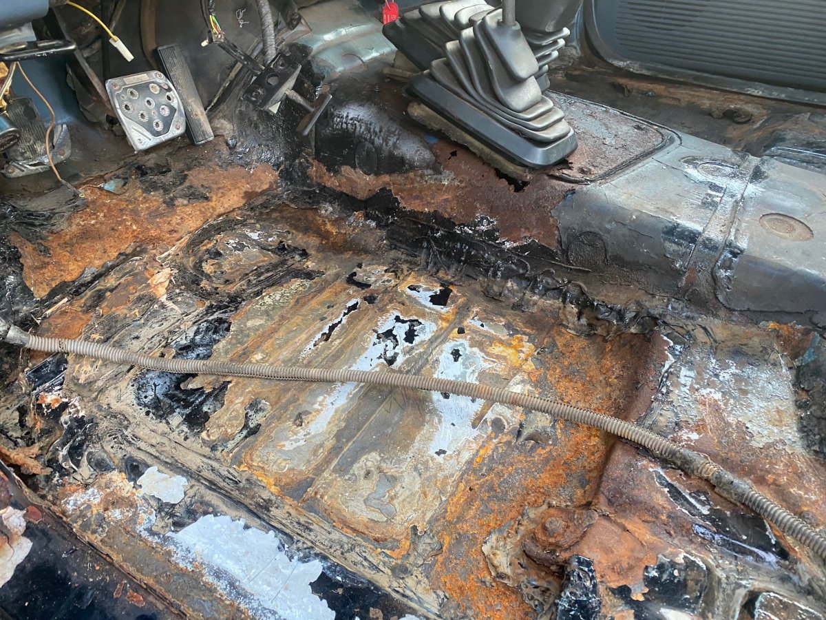

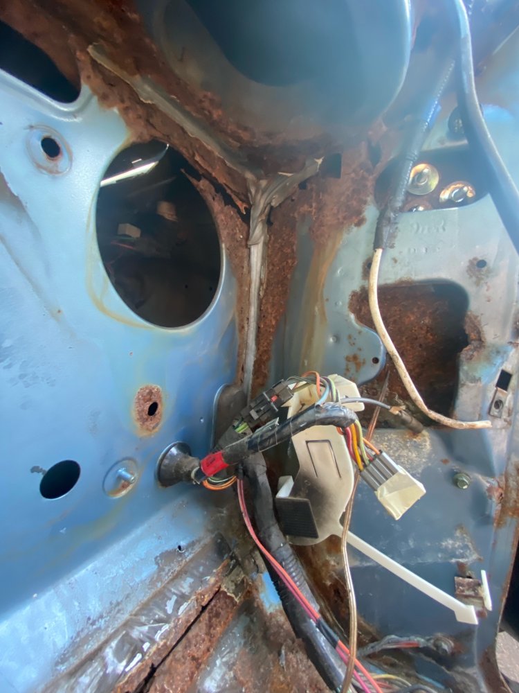

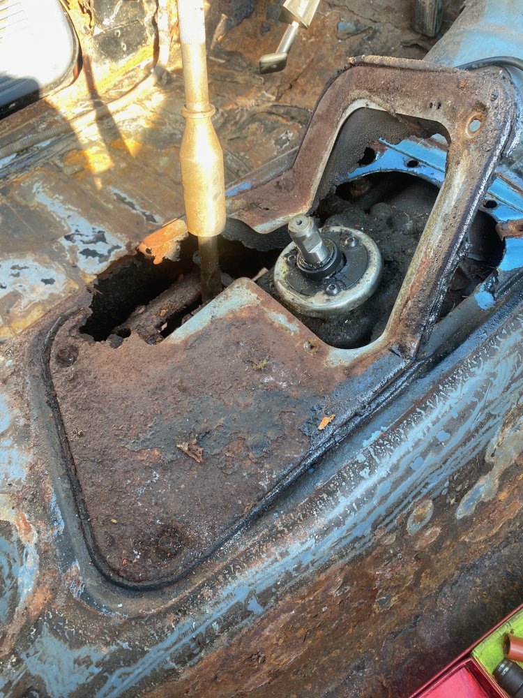

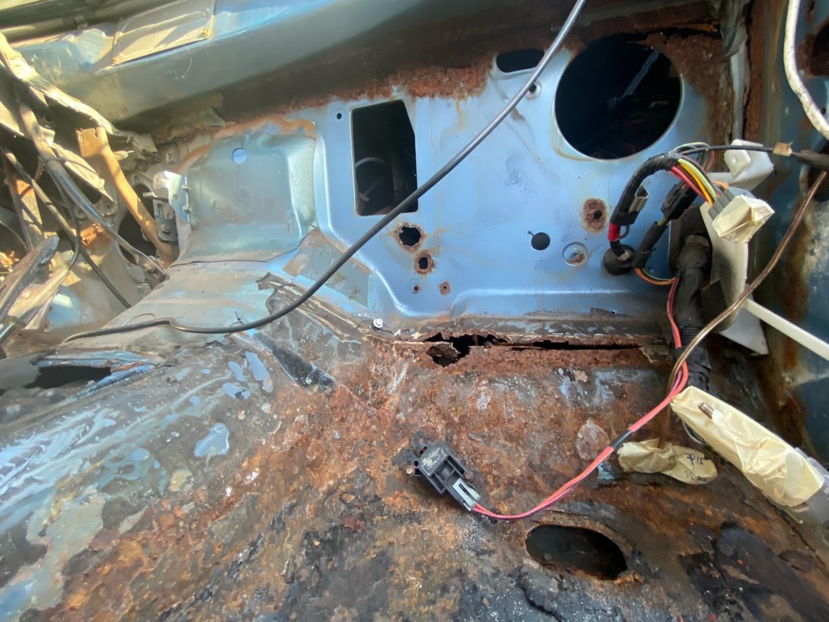

Hey folks,
I'm starting this thread to document and share my up-and-coming repairs on my newly acquired Ranger.
The body looks great on the exterior and the frame is still solid, but the cab could use a lot of work.
I recently posted a thread in the Introduction section that showed what happened to my fire wall on the highway. Ranger Danger is a thing.
Thread : Rusty Ranger Danger
Now I'm starting this thread for a more detailed documentation of my repairs as they are quite extensive. If anyone has dealt with similar issues I would love to hear how about it was fixed or modified.
As you can see that damage is pretty bad, a whole lot of rebuilding will be required for a proper restoration.
64742
64743
64741
64744
64745
There really is no easy fix for this either than a full cab replacement, but a new cab for this model is not as common as I would have hoped. Also, I can't afford it, so most of this restoration will be as budget friendly as possibly.
NEXT STEP : Clean all the rust with wire brush grinder and see what good metal is left.
(will update with pictures once done)
Has anyone ever delt with a similar restoration? If so i would love to hear about it to try and mitigate any future problems I might encounter doing so.
Happy grinding!
Holy crap dude. Where do you live? I am assuming that rust is from salty humid air? Looks like your cowl seams went first and kept the carpet soaked for quite a long time.
I really would consider writing that cab off. I can see extensive rust inside the A pillar where the door hinges bolt on and it looks like there's new hardware and washers in there already... how thin is the metal in places you can't see?
I am not afraid of rust repair and have done plenty of it, although I really would suggest finding a different cab. Might take some serious leg work on your end but another member had a rust free cab shipped from CA recently for about $1000. Consider your time and materials, what are they worth?
You are 100% correct, I live in East Coast Canada, they salt the roads during winter and the summer are hot and humid. Best of both worlds right...
I've looked for a cab but I'm not having much luck, they are either 2-3 years away from looking like mine, or quite expensive. But I am keeping an eye out. If I could get a rust-free cab for anything under 2000CAD I would deff consider it.
And yes, both A pillars would have to be redone completely on the outside where the hinges are. I've done it in the past with 2"x1" angle steel bar but had much more good material to work with. Both the A pillar and the corners under my windshield are my biggest uncertainties right now.
It's quite the restomod compared to what I worked on in the past. So I see it more as a hobby right now, or a "Challenge accepted" moment I might regret, but either way I'm giving it a try haha.
Thanks for the interest.
