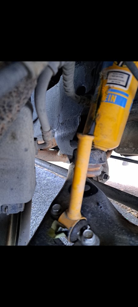

After having a bilstein 4600 front shock snap at the upper weld (shock body to CV-Clearance-Stick-Thingy,) I have been looking into full body shocks for my 2wd Edge.
Rancho offers a shock for torsion cranked rangers, with a 19.25in extended length and a 5.28in stroke.
Compare this to the b6 4600 with an extended length of 17.92in and a 4.2in stroke.
These are the numbers we're working with. Extended length is the important figure as it determines when my suspension will reach upper ball joint bind, followed by upper arm to frame contact (only if the shock breaks at a weld as I have seen first hand). Shock stroke is important because it gives us a ballpark estimate of gained suspension travel; I don't care for unnecessary uptravel potential. I know the bumpstops will prevent the suspension from reaching the maximum compressed length of a full body shock, which is a good thing.
In theory, so long as a shocks extended length does not exceed that of the Rancho's, and I don't do something ignorant such as adjust my torsion bars out of their nicely aligned, 1.5 inch torsion twisted state, it should only enhance ride quality by offering a modest increase to suspension travel. Getting it properly aligned with the adjustable camber bolts was expensive enough that I don't wanna touch my T-bars without necessity.
The candidate I have chosen for a full length front shock is the Bilstein 5100, part number 24-185493, for lifted TIB rangers. Extended length is 18.98 inches, with a stroke of 6.81 inches. I will be installing the bar pins myself.
The goal of using this shock instead of the b6 4600 or rancho shock spec'd for my truck is optimization. The 4×4 shocks are inherently weak at the welds, where the rod of CV-boot-rippage-avoidance was shoehorned into a crowded space on 4×4 vehicles. The short shock body has a lower volume of fluid, which reduces the volume available for cooling under heavy use- I am thinking long highway drives in 45 Celsius. The abysmal 4.2 inch stroke of the bilstein b6 4600 is pathetic, although an upgrade over parts store spec 4x4 ranger shocks which are about an inch and a half shorter, off the top of my head. I don't want to crank my torsion bars more, I want a modest increase in suspension travel, and a more robust front shock. This is about optimization
My truck's suspension is in better shape than the day it was made. The front has moog problem solver sway bar links w/ polyurethane sway bar bushings, new wheel bearings, Powerstop drilled/slotted rotors & Powdercoated calipers, a new production rack and pinion, new tie rods inner and outer, moog problem solver upper control arms, and greasable lower ball joints. The rear has lift shackles and new U-joints on the driveshaft
If somebody wants to talk me out of doing this, now is your time to shine. I'm gonna be grabbing a thicker front sway bar off of a level 2 fx4 in a local yard before pulling the trigger on these front shocks. I'll report back to this thread sometime this summer once I've got the shocks on
If somebody has recommendations for new bump stops, your input would also be appreciated.
  • Full-body bilstein 5100 front shocks for a 2wd Edge
Note the image is from a year ago, before my front end received its full makeover
