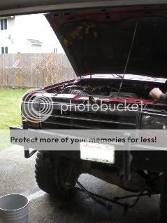

just got done pulling the motor out of the bronco. everything went good. found some more hacked up wiring..
i think tonight ill "try" to pull her into the garage and start working out the wiring issue.

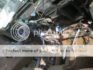

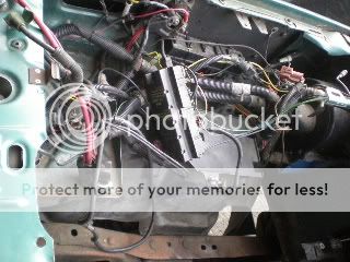

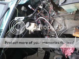

in these pictures all of the wiring you see is all of the bronco harness correct?
i dont need any of it? all of it can be pulled out and scrapped and ill just be swapping the whole harness over from the explorer.
i just wanna make sure before i tear it all out that i dont need to keep any of it.

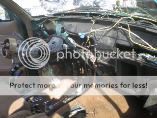

some wiring...
Full b2 build, 4.0, d35, 8.8.
more wiring...

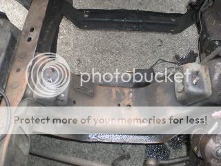

clean bay besides the wiring, and what looks like maybe james duff motor mounts? i heard that the motor mounts need to be drilled to fit the 4.0 and these haven't been drilled at all. i'm thinking that maybe they are conversion mounts.

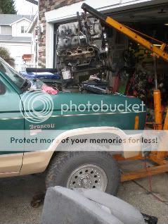

i got some work done on the motor swap today.
didnt get many pictures, but i got the radiator, intake and airbox, and started the lableling of all the wiring. i have tomorrow off so i think if i work through the night i can have the motor ready to be pulled for tomorrow!

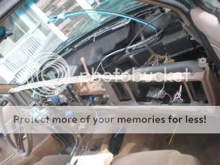

update:

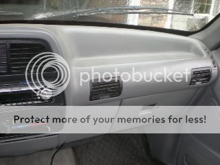

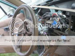

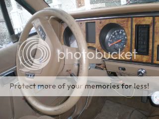

got some work done on the bronco, i got the entire dash and steering column out of the bronco. wasn't to bad, took several hours. i think its looking like the better way to go rather then splicing lots of wires. i also started work on the explorer dash. here's some pics.
old dash this morning;
several hours later;
after that i got the whole harness out of there and the steering column. :icon_bounceblue: can't wait to this the new dash all mounted in.

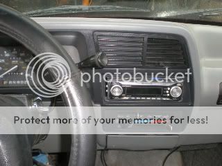

new dash;
hopefully i can get the explorer dash out and i'm going to push to get it mounted in tomorrow.

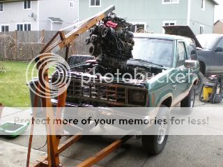

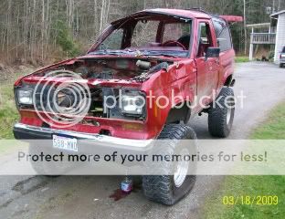

Also, i found a picture of my parts bronco we bought for the lift and tires, the tires are aired down so we could get the hoist high enough to lift the motor out lol.
