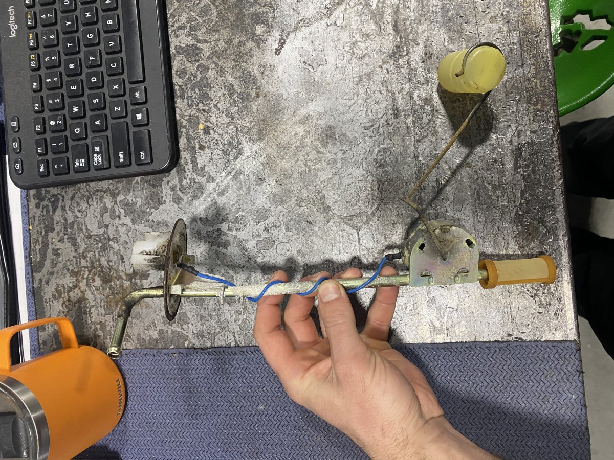

1984 long bed side mounted tank - ideally want an in-tank sender/pump to a regulator on the frame rail with a return line since carburetor only requires 5-7psi. The sender/float shown is what came out of the tank but I will need a cap with an in and out line. Any suggestions on what year sender is compatible and will work for my setup?
Is the sending unit hole in your tank the small one that's about 2" wide or the big one that's about 4-5" wide? Looks like the small one?
If it's the big one you can use a sending unit from an '86-88 truck of the same wheelbase as those had a low pressure pump in the tank. Pretty easy, cap off the return side and add power.
If you have the small hole type tank, you could modify your sending unit for an electric pump... or run an external clicky clacky pump... or buy a gas tank for a newer truck with the sending unit I mentioned. I don't think there's a drop in sending unit w/ electric pump made for the small hole tanks.

Correct - small hole. Is a clicky clacky like an in-line pump? Would a 2003 fit in my truck? https://southbend.craigslist.org/pts/d/la-porte-ford-ranger-fuel-tank-with-pump/7695502560.html
Pre-1989 Ranger fuel level senders use different OHMs then 1989 and up, so not interchangeable if you want the gauge to work, lol

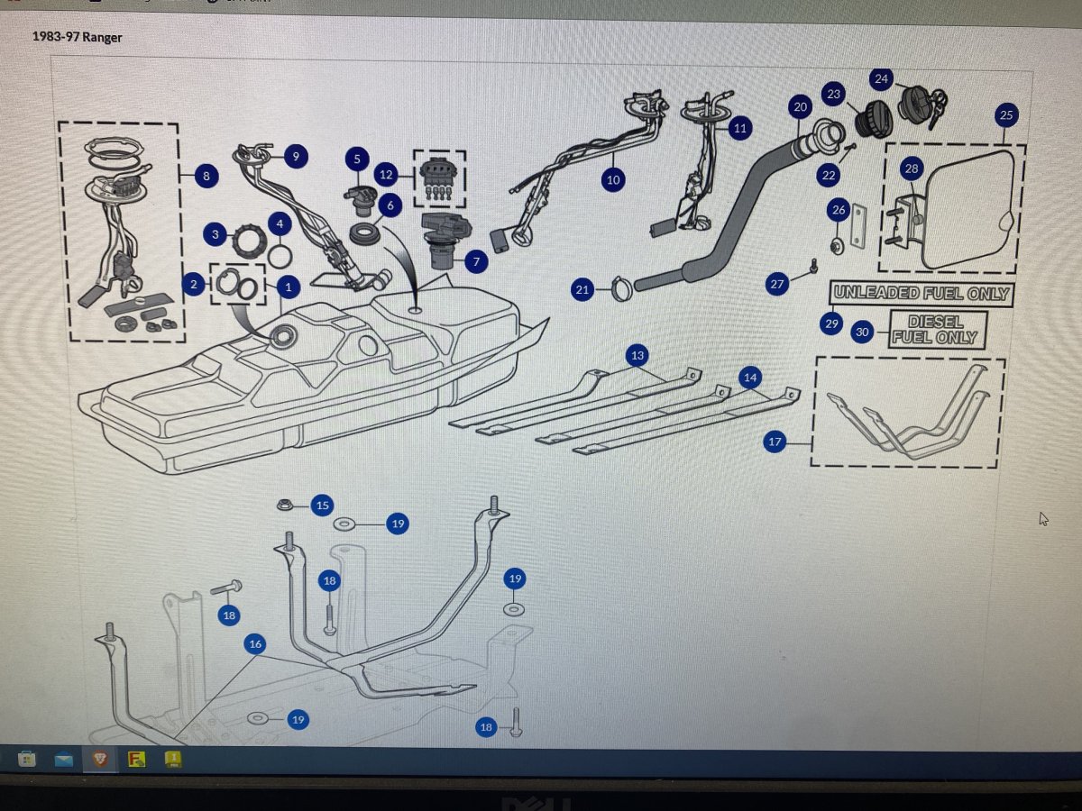

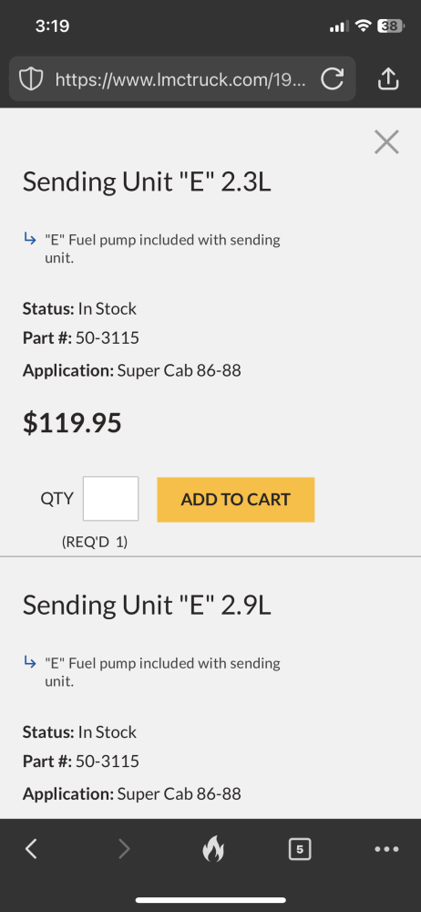

Could I just use an ‘86 in tank pump? What changed that year?
You certainly could use the '86 in tank pump, you just need the tank with it because '85 and later all had the big sending unit hole. That sending unit won't fit into your tank.
'86 was the first year of the super cab, that is the only relevant change besides EFI on the 2.9.
Good deal may go try my local pick a part for a tank that has the larger hole.
