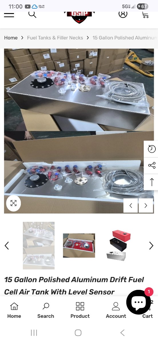

I'm looking into installing a aftermarket aluminum fuel tank and fuel lines on my 95 3.0. My question is what would I need to do to install new fittings to the oem fuel rail or do I not need to do anything special to it install new fittings to install braided fuel line from the filter to rail? (Sorry for that lengthy sentence). Also, the reason/ want to do it is because I'm worried about shit in the oem tank clogging lines and getting to the hardlines and injectors. I know that there is shit in it. As in 2024 I had to replace the pump and in doing so things got into the tank and last year in November replaced the fuel filter. Now I'm having issues with it not turning over. The pump still works too cause I hear the pump prime every time I do.
So I'm going to install a new tank fittings and lines from the tank to the filter and from the filter to rail(replacing hardlines with braided). Can I install new fittings to the rail with little problem or what do I need to make it work and what to do?
I added the kit I'm looking into buying to this post.

Can’t really tell what that kit has, but there’s a couple different kinds of braided line. Some of the cheapest is just rubber line with a braid on the outside. Ethanol has a bad tendency to pinhole the rubber line over time. Unless you buy only ethanol free gas, that’s a problem and since almost all gas has ethanol anymore, well…
I did braided PTFE line on my Green Ranger and Choptop. Did -6AN, just used adapters to match the braided lines on the fuel rails, those fittings are readily available for the push connects.
