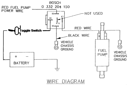

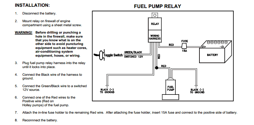

ok thanks man........i droped the tank yesterday to make sure there the pump wasn't bad, it was still good.:icon_thumby: so i think im just gonna wire the fuel pumps straight to the battery with a switch. thanks for the help i might have a few more questions for you guys in the next couple days if i can get a few pics posted up about stuff on my truck

sorry it took so long to get back to you guys..............but another question for you guys there is 4 wires coming from the fuel pump in the tank, Orange,yellow/white, pink/black,grey/black. can any one tell me witch wires are my power wire and my ground? and im gonna put a in-line fuze in, what size should i use?

The pos+ wire on both pumps are the pink/black stripe, and the neg- ground wires are both solid black and come directly off the pumps. The other wires are for the fuel gauge and FP relay.
