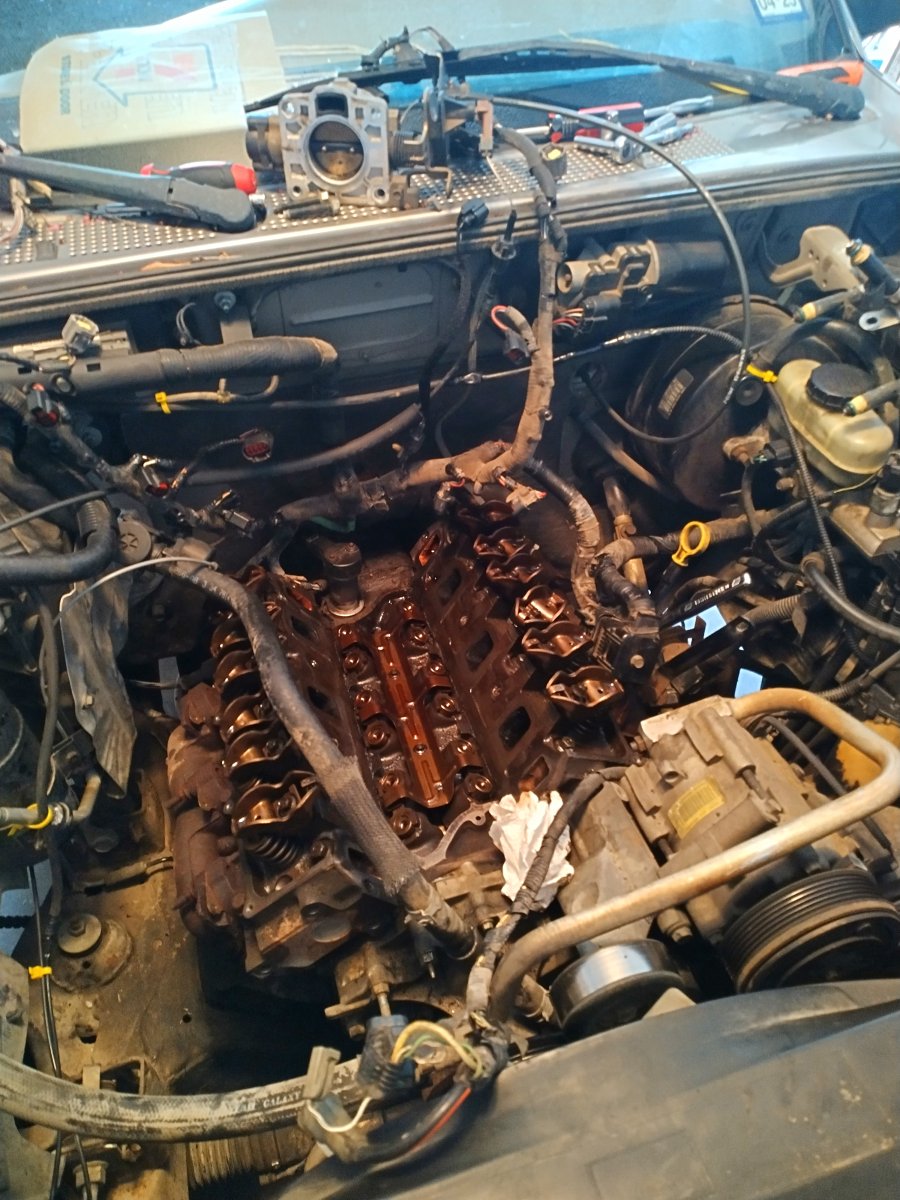

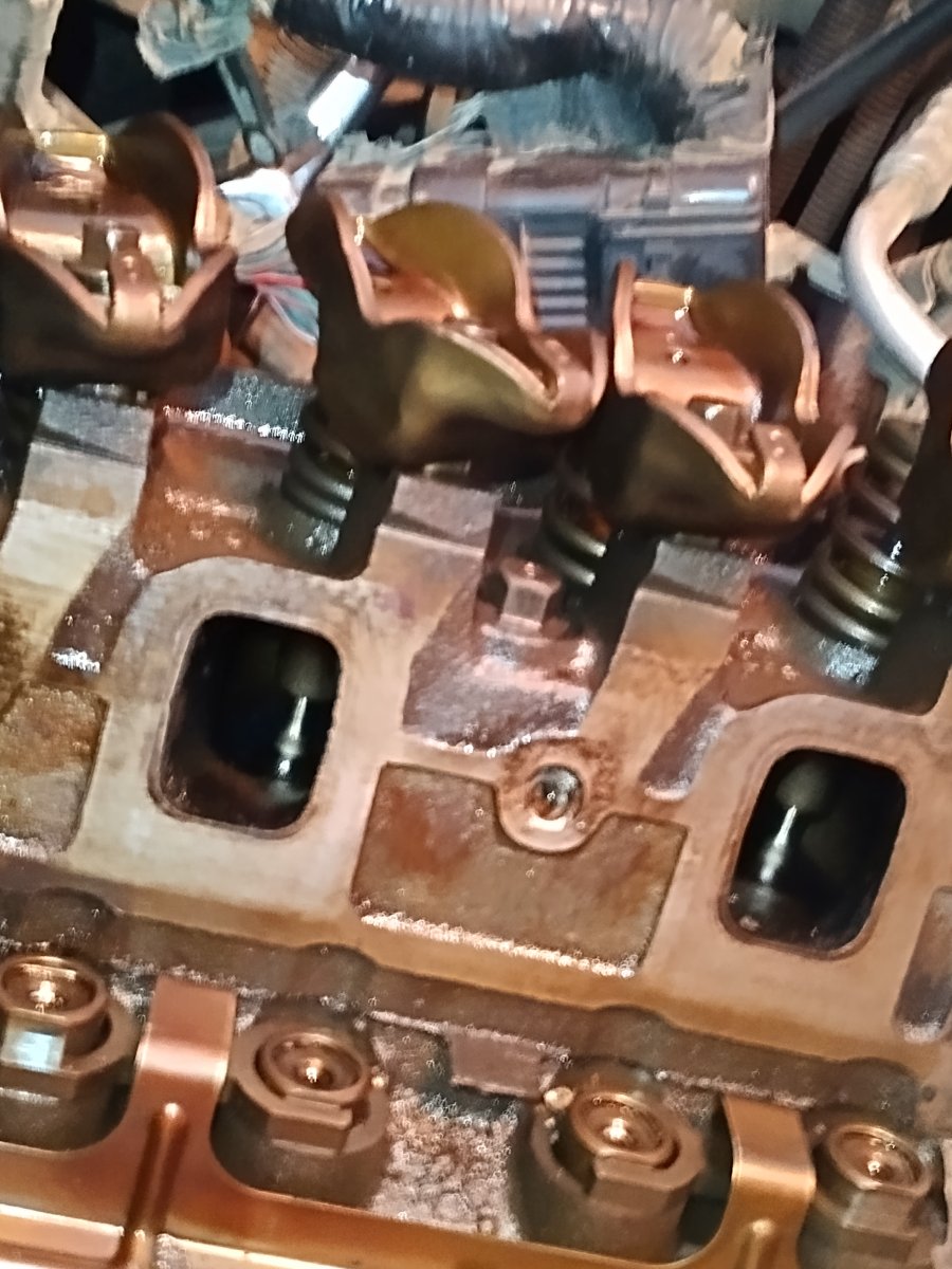

Someone decided to use two head gaskets :flipoff:
No wonder the head bolts were so easy to break loose!!!
Fortunately nothing looks to affected other than adding to the lovely mess I get to clean up.. :annoyed:
Valves upon closer inspection look very salvageable, going to replace the broken exhaust bolts. New Valve replacement parts with the gasket set so they will go on when I'm done cleaning.
For reference I'm using the Fel-Pro set but I'm going with non torx style heads because honestly I strongly dislike trying to torque them the normal bolt style just seems easier.

Really think someone was making poor choices as well, feeling more like a dentist brushing and cleaning everything 😩
The absolutely worst part is the pistons being caked in layers of carbon along with the heads AND block being just stuck with half the gasket and everything is being done by hand absolutely no power tools.
The valves after cleaning them up are actually in pretty darn good condition considering everything going wrong but they are definitely needing to have more cleaning new seals etc before reinstalling.
However if you needed this done and had no other vehicle to rely on and you got a job and not much experience, these heads aren't hard but taxing, especially the driver's side with AC if you don't have AC the workload is pretty similar on both heads.
Also myself having completely screwed up one Head Job before and it blew exactly one month of normal driving, yeah if you miss one step you got to do it all over again!
