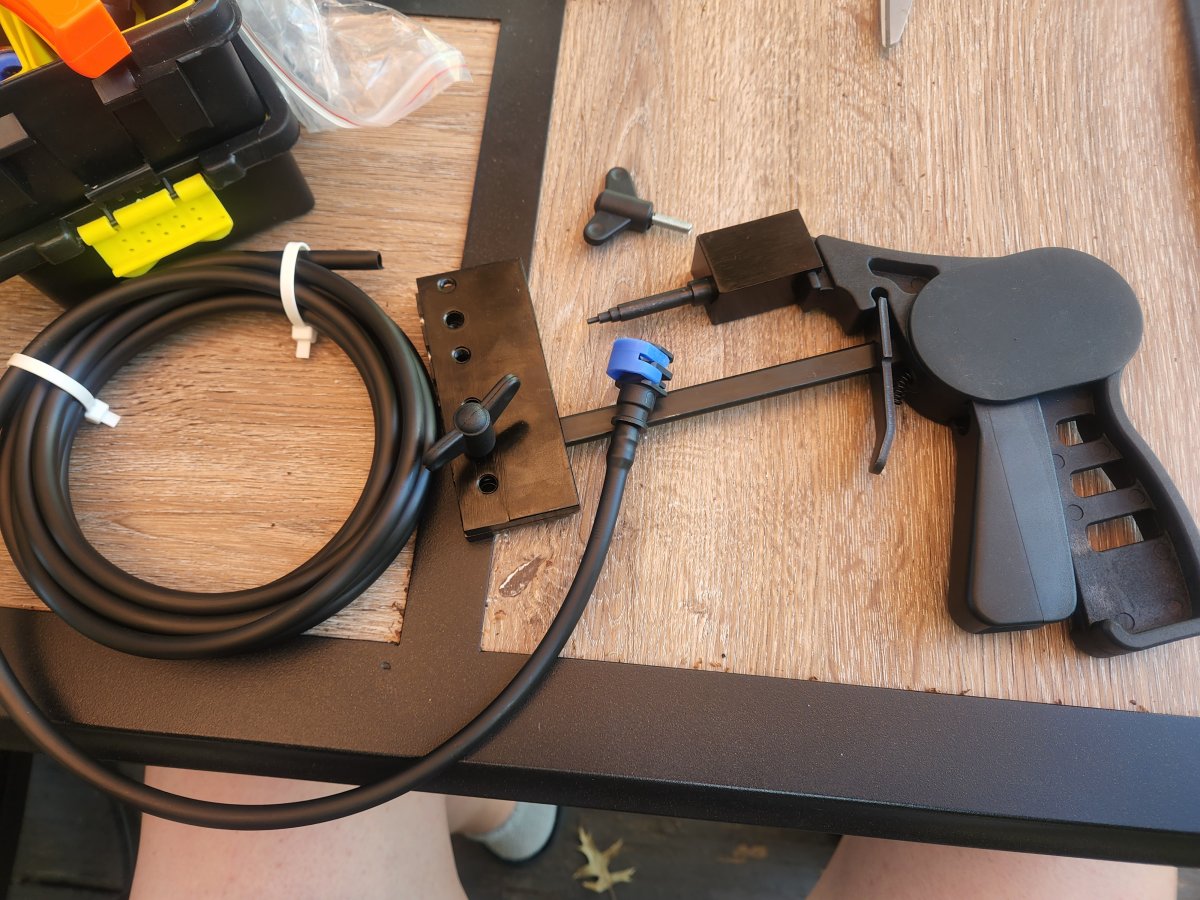

Oh dude that would be great, one other question when it comes to the fuel rail did you have to pull the disconnect out of the fuel rail? I'm seeing an quick disconnects on summit that may work but from what my measuring caliper says the tube is only 6mm in outer diameter. Probably a little less counting for thickness of metal one I see on summit says 12mm have no idea if thats length of insert or diameter of the side 1 fitting. But I at least got the 20 ft AN hose coming for it I think it was less than 52 dollars from evil energy but it's also not PTFE it's CPE but I'm not looking to run anymore than normal 30 to 45 psi so I think it'll be fine. Plus survivability will definitely increase by doing these things.

So… yes, I do intend to do the disconnects. I should be able to get mine apart. My green Ranger I couldn’t get it apart on the old rail when I did the engine swap which required me making AN from the disconnect on the engine I swapped in to the fuel filter. I should have gone all the way to the tank then because I started springing leaks after that with the lines back to the pump.

I did a bunch of looking around and settled on the PTFE line because I was hearing a lot of reports that ethanol was causing pinholes in the non-PTFE line. Just didn’t want to chance that. Not after seeing the rubber line that someone used to patch the leaking fuel line on my 92 turn into a sprinkler hose which is why I had to replace it with aluminum and fuel injection line.

Oh it's no problem I've got a lead tech at the shop who knows about some of the stuff needed so I was getting the basics before starting off and I found out that aluminum pipes are able to be used in Virginia for fuel pipes. So hey good news I'll be also getting that and the 32° flare tool for an lines
