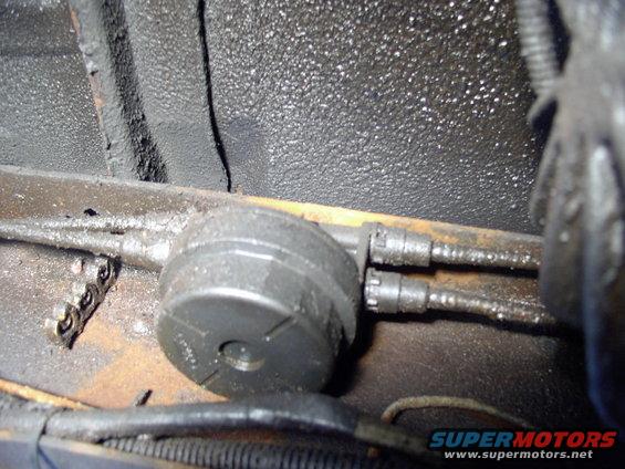

Alright, I have a 86 bronco ii fi with the black canister type fuel filter. Somehow, the damn thing cracked and leaks now, which is a pain because i cant find a replacement. However, I have found an easy solution to the fix but I need some help. There are two fuel lines that are on that frame rail. I have a fuel filter, the shiny inline filter that fits one of the lines. The other line, however is a just a bit bigger to fit on that filter, so I have to find another one that fits. Does anyone know what filter it is? Any other alternatives?
The piece you are talking about is still available at NAPA. Get the later one that doesn't have a real filter in it so that you don't have to worry about it breaking. The inline filter up by the engine is more than enough.
The one WITHOUT the filter in it says right on the case DO NOT OPEN. There is also a different one for duel tanks from what I remember.
The one for duel tanks is actually a selector valve. The fuel module he is looking for is actually to take the place of the selector on the single tank models so they didn't have to have 3 or 4 different fuel systems and line setups.
Really? What is it called then? I have been looking for the fuel filter housing on AutoZone and Napa and haven't found anything except for the inline filter.
This is what im talking about just to clarify.

i would just make jumpers/splices or get a later line to the hp filter.
take about 10 minutes to snag at a junkyard.
Will that cause an issue with not having the internal check valves that the reservoir has inside it?
What is it later one called?
no, its a b2 single tank from what i read of the op.
