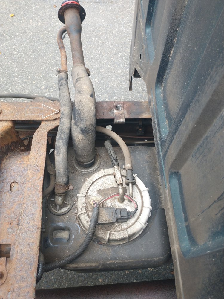

I need to replace the smaller fuel filler vent hose (next to larger fuel filler hose) but I can't find any replacements. Does anyone know where to buy a replacement hose, or what could work as a replacement? Could I cut my own vent hose from this product? thanks

Call your local ford dealer. Ask them for the part number fxxx-xxxx-xx
Verify a match to this since there is no picture.
Also search vintage part ( that’s a company) for the ford part number.
I have had good success finding parts as long as I know the actual ford part number.
fillernecksupply.com as well but they are down for maintenance
Yes, you can use off the shelf rubber hose that's fuel resistant, its just an air hose but will get fuel in it if you over fill the tank
So yes, the one in your link will work just fine, make sure its not too long or it can kink and block air getting out when filling so SLOW fill ups
It all looks pretty “used hard and put away wet”, figured a complete filler assembly might save a bed pull in the future for the big pipe.
Yeah, I have new replacements for all the other parts (fuel filler neck , fuel filler hose) but I couldn't find a replacement for the vent hose.
