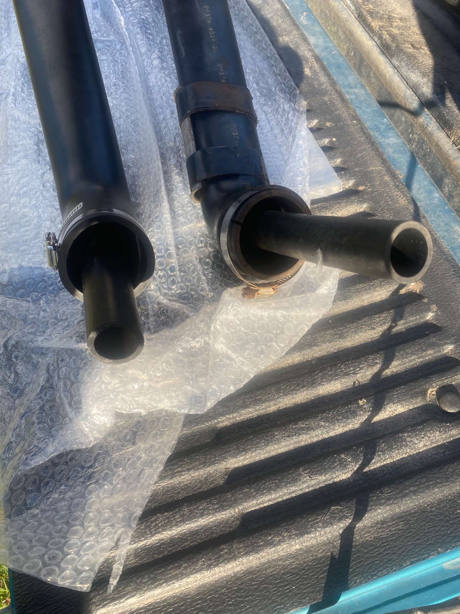

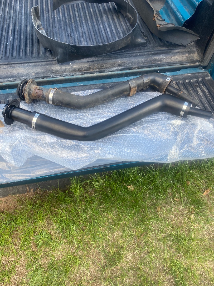

While I had the tank out of my 93 I decided I would order a new filler neck hose because the original one had some cracks in the base.
I bought the new one from rockauto ultra power brand. Well when I put it side by side with the old one the outer hose is a few inches longer. Do these hoses usually require trimming to fit? Should I return/exchange the hose for a different brand?
Thanks for the help

They probably make them that length to cover a wide variety of models. Just make it look like the old one. Start with the gas cap end, you could probably loosen the clamp and just push the hose on more. Then test fit or commit to chopping off the tip of the long, skinny, black hose.
Right on I’ll try that, thanks I appreciate the help!
Just take your time. A black hose of that size can be quite intimidating, and .. Ok Ok I'll stop, I'll stop. I swear I'm not a 12yr old
Yeah, trimming is a thing with those. I’ve also discovered a lot of new radiator hoses need trimmed these days too. It’s kinda weird.
I tried to buy one once for my '97 and whatever I got was like 3" too short, would you mind sharing what part number you ordered? I'd much rather have something too long than too short...
It was the ultra power 577902 from rockauto
