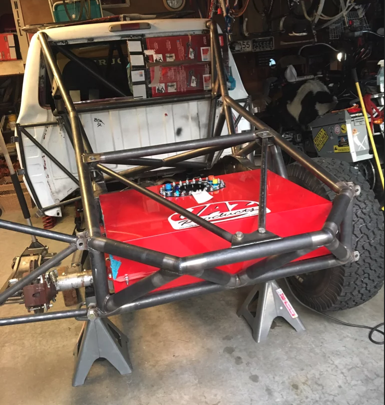

isspro.com will also make you a custom sender to match exact parameters and cell depth. thats what i used when i placed a jaz "jeep speed" cell in my truck
