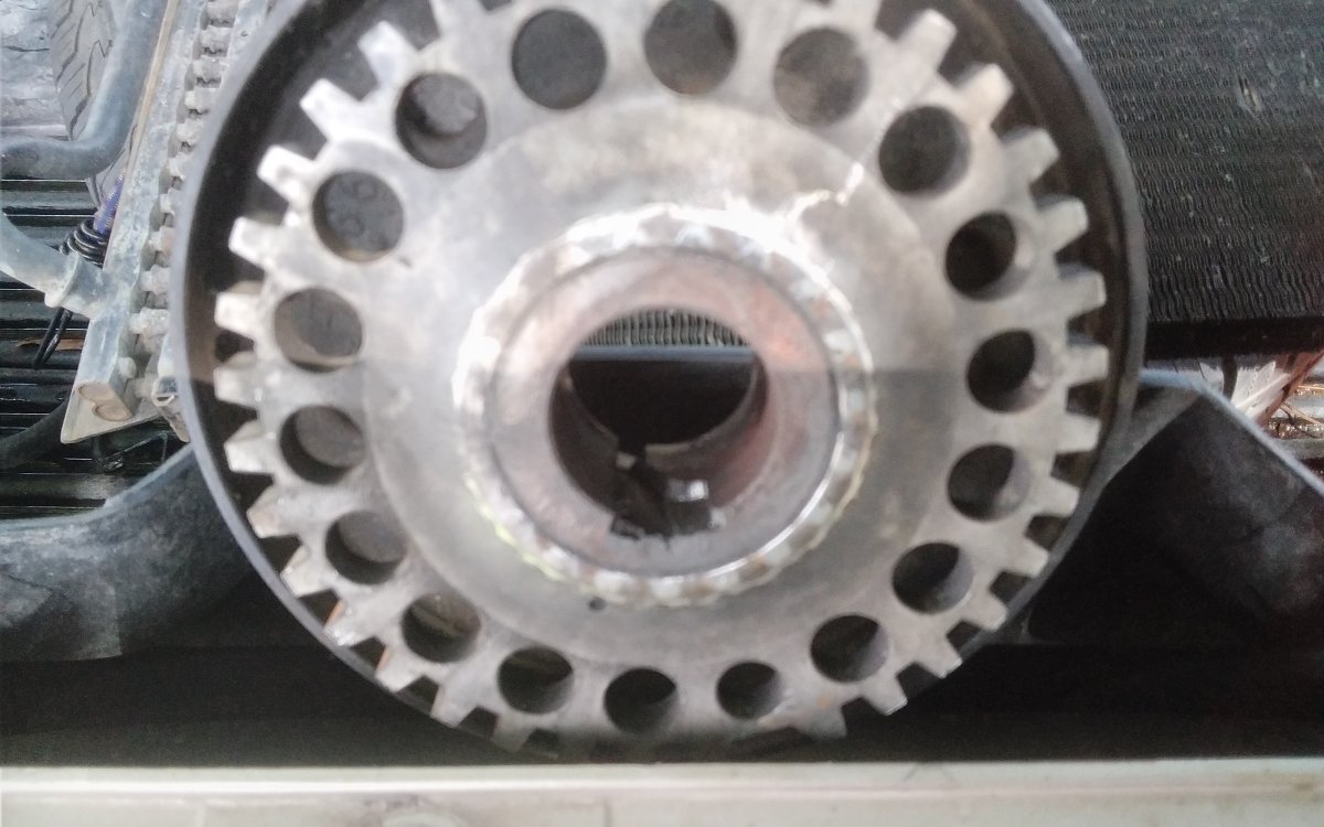

ok men and women. as suspected timing was as suspected. but you are not going to believe why. if i can send pics i will. my brother did not torque down the crankshaft bolt. the harmonic balancer was wondering around. crank position sensor had no idea.cam position sensor had no idea what to do. ladies and gentlemen double check your torgue specs. if i would have agreed to oh its ok with a lookey look in #1 cylinder. trust me. use a rubber hose. rise and fall. no brother, i am not doing this for failure. so, i pulled harmonic balancer off knowing there is true marks. low and behold the harmonic balancer has created its on keyway. the crank is chewed up. i hope you pros can view the pics. basically. lil brother questions big bro type B/S. dummy let the harmonic balancer walk toward the front. i guess it had to. im surprised it didnt shear the key. the only reason i can think of is because it didnt need to. oh now im his 😇😇😇😇😇🤣🤣🤣🤣🤣 is the crankshaft worth trying to save. can a weld fix the channel created. Thank You folks, yall saved my brother a fortune.

A friend told me he fixed a similar problem on his engine many years ago. The engine was still running a decade later with that fix. Used JBWeld to fill the hole. I would try that with a new balancer. Cant really hurt to try...
Yikes...
That's gonna be a tough fix...
I had similar happen once on my turbo 2.3L first time around... turns out the '85 blocks have a shallower hole for the crank bolt so the bolt was tight but a couple threads from contact... it broke the key and screwed up the balancer similar to that. There was still 1/4" of key sticking past the timing pulley so I went to the junkyard and got another balancer, shortened a crank bolt and just ran it... worked fine until I rebuilt the engine and fixed it better...

FWIW: On some Fords the harmonic balancer bolt is single use and torque to yield (example 2004 Explorer 4.0L), I would make sure I used a new Ford OEM bolt at this stage of the game.
