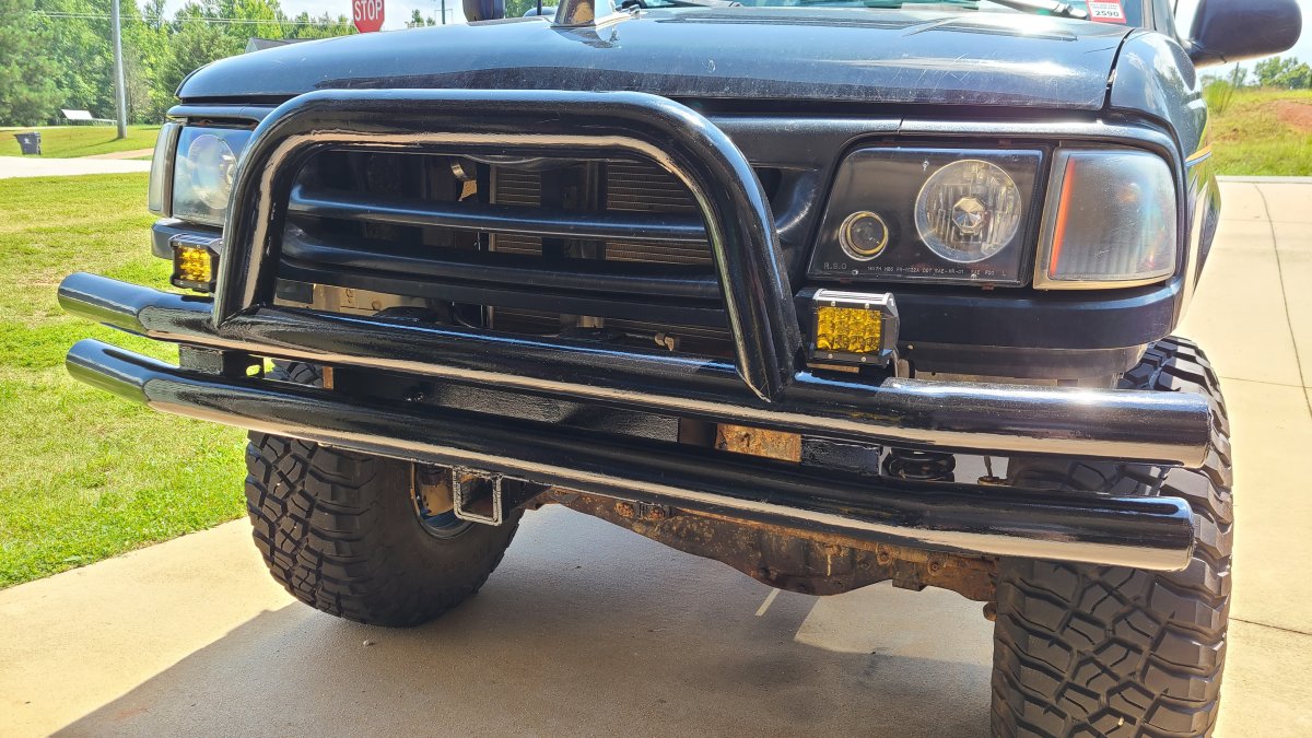

I welded a receiver to the bottom of my bumper and reinforced the bumper and mounts. I guess my bumper wouldn't look great on a 2020, though I would be willing to sell it to get some money towards a winch bumper.

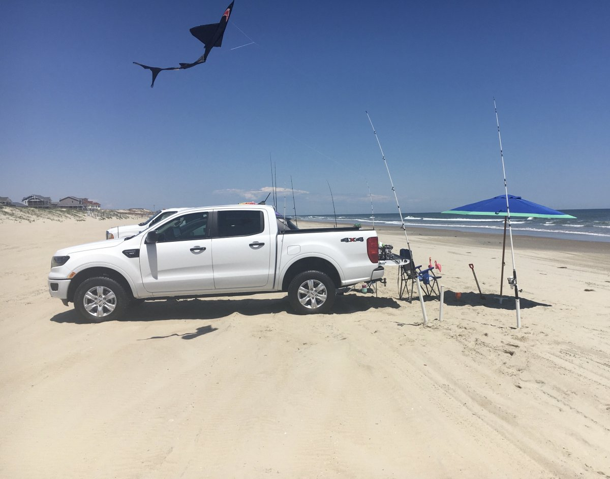

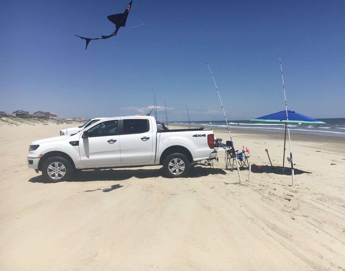

There was a fella that had a new white ranger... hooked up for surf fishing parked on the beach. Pretty sure he had a receiver up front. I searched but came up empty. Maybe that will jog your memory as to where it was?
This one? From the "What a difference 22 years makes" thread.

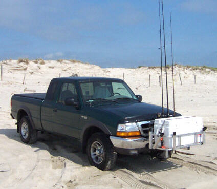

Usually surf fishing guys get front mount hitches to put cooler racks on like uncle gump said. I think that's what I remember seeing but again, can't find it...
They look like this...
Yeah, I vaguely remember that. This is all I could find.

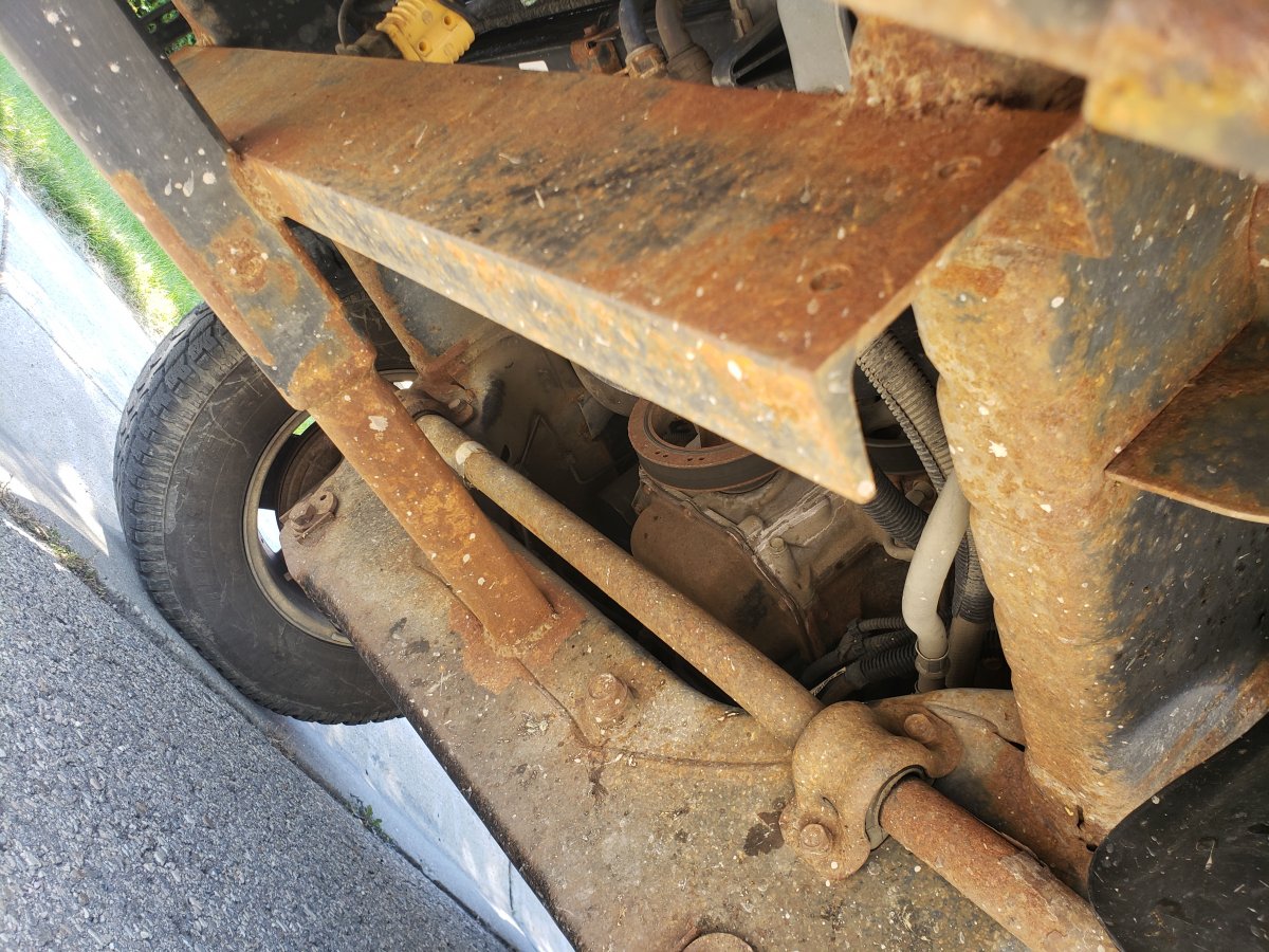

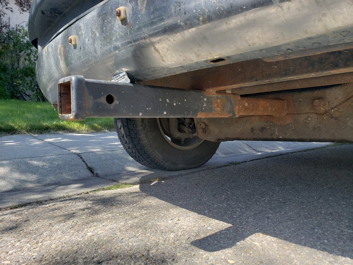

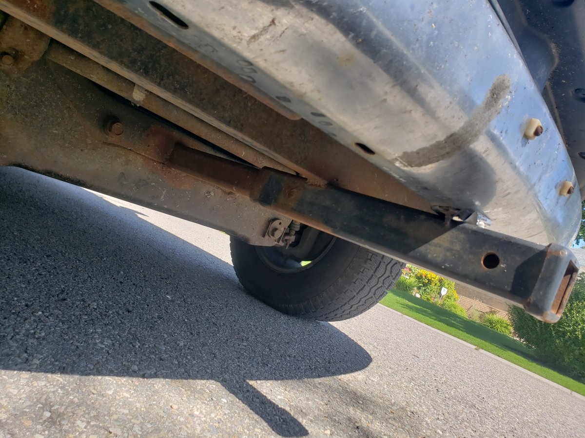

I've put a front receiver on my 86 b2, my 91 Ranger, and my 2006 Ram 1500. The b2 I adapted a rear receiver to bolt on. The other two I welded c-channel or square stock near the front bumper between the frame rails and ran receiver tube from just in front of the front bumper to the factory crossmember, also welded in. Seldom sees use but I do plow with a smaller homeowner style plow and no problems as yet.
