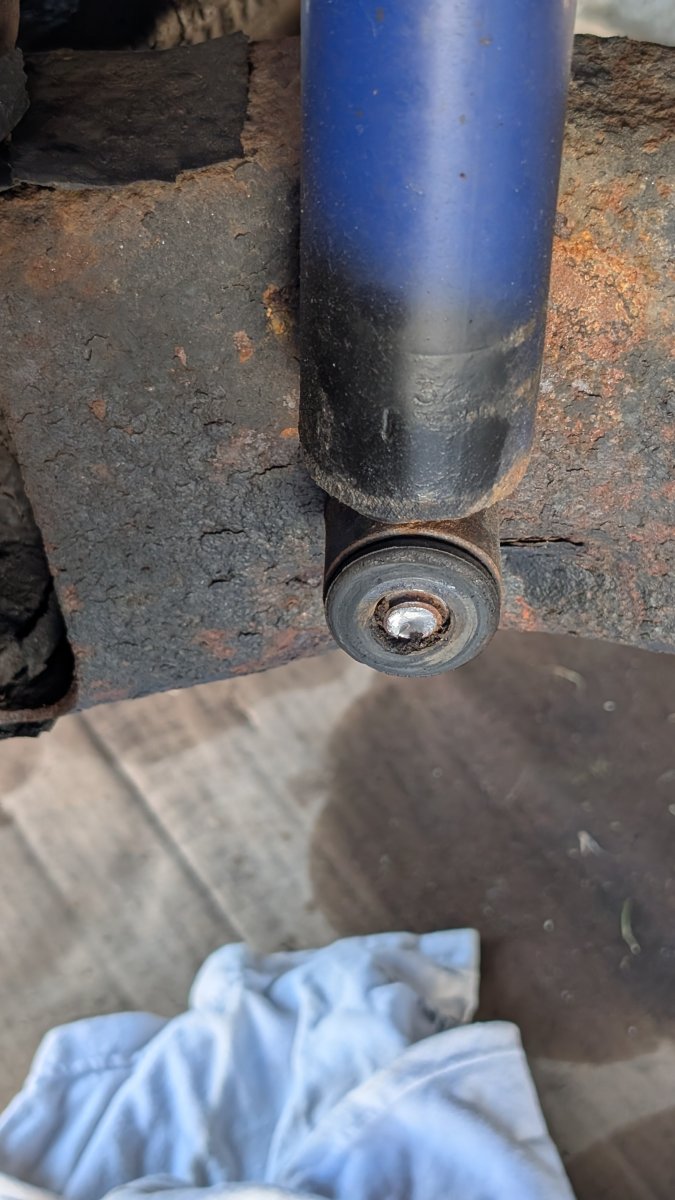

What is the best way to fix this ? I don't weld.

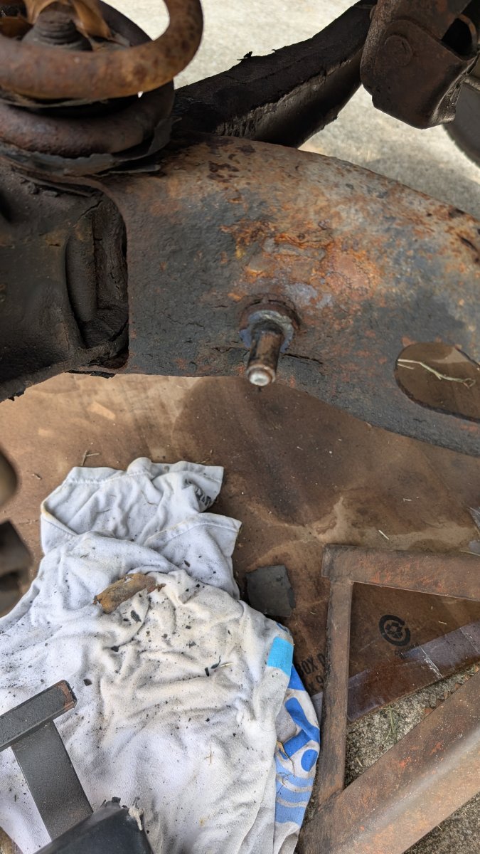

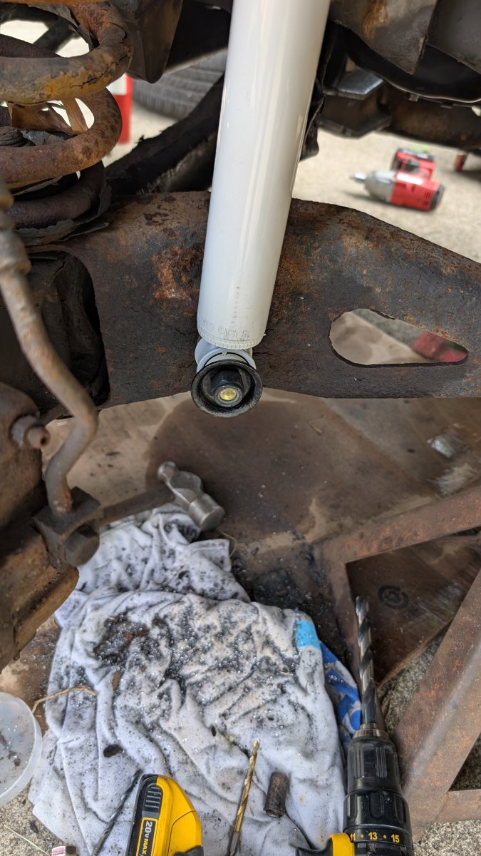

Drill or grind the stud until you can get the shock off, then do the same with the stud to remove it from the frame member it’s attached to.
Then you can replace it with a bolt and nut of the proper size. A nylon locknut would be ideal. Good Luck!
Yeah, you can drill/grind/punch that thing out. If I remember correctly that stud is just pressed into a hole in the arm. It can be replaced with a bolt. Not ideal, but it works if you don’t have access to a welder.
