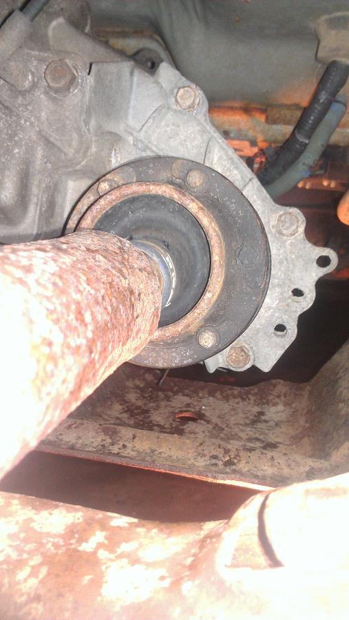

Im not sure if this is a dumb question or not but while I was under my truck the other day looking around, I happened to grab the front drive shaft and noticed there was a significant about of movement (up, down, side to side). Im assuming there shouldnt be any movement but not sure. This being said I have a distinct vibration from about 2300 rpm to 2600 rpm. could this be the cause? But at the same time the front hubs arent locked in so It shouldnt really be spinning I wouldnt think. any thoughts would be appreciated. Oh the trucks a 98 with a 4.0 auto trans.

That joint should not have much play, won't be zero, but it shouldn't be much. That being said, a vibration from that would require the front hubs be locked in, and would be related to ground speed, not RPM.
A vibration that is solely related to RPM is an engine issue.
Kind of what I thought for the vibration. Any suggestions as to what could cause the movement in the drive shaft? Should I start another thread in the 4.0 section for the vibration?
The drive shaft probably has a worn out CV joint.
