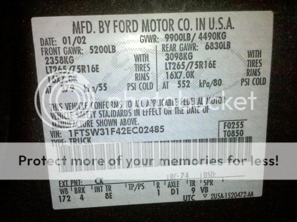

The tag on the door, or it will also match the ratio of the rear differential if it still has the tag. There is a chart to tell you what ratio in the tech library. Just click the tech library link directly under the TRS logo at the top of the page.
The tag looks like this (axle code = D1 on this tag):
