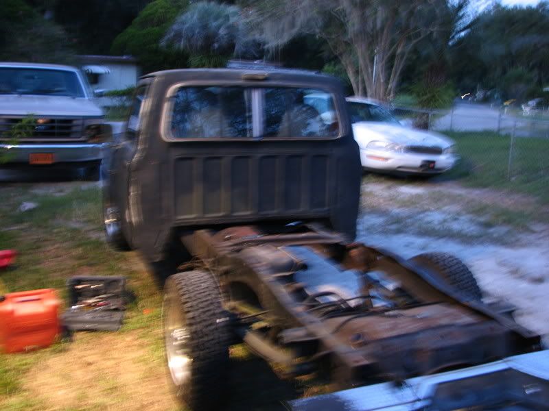

This is what I started with, more or less:
That is the earliest pic that I can find of the thing, its still about 5 or 6 months after I got it. it was rotted really bad, the driver side floor was about gone, and so was about half of the passenger side, there were no cab corners left and the radiator support was pretty much gone along with the fenders, doors, and the factory bed, which I tore off and scrapped as soon as I got it. It had no brakes either, but it ran pretty well for having 234,000 miles on the clock and not being ran in 5 years. It was pretty bare bones as far as options, it had a vinyl bench seat, AM/FM radio, power steering, 3.45 gears, an FM145, 1350 T case, 225/75/15 tires and the tow package, supposedly...

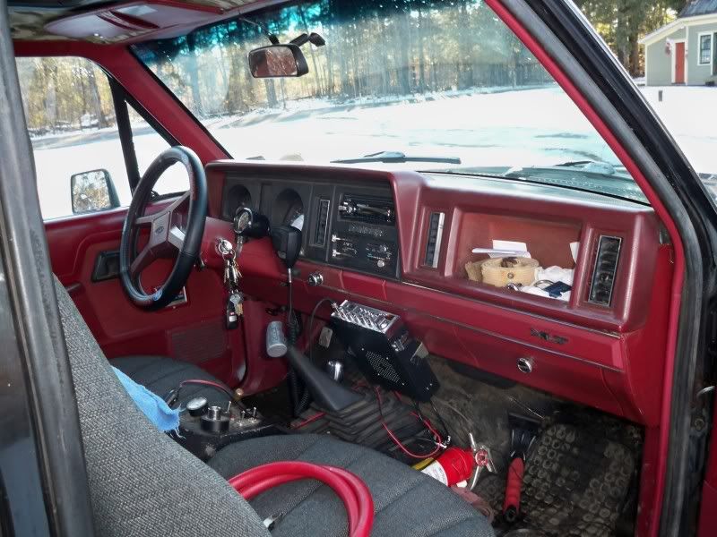

and some more recent pics:

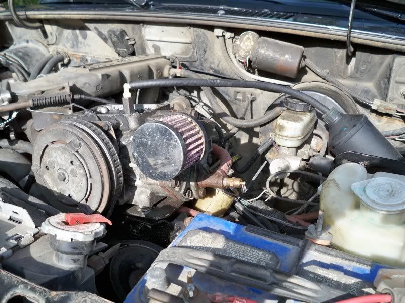

i like it, its kind of what im going to be goin for with the rescue ranger when it goes under the knife again. any pictures of the OBA set up?

This is the most recent one I have:
And the bracket:
