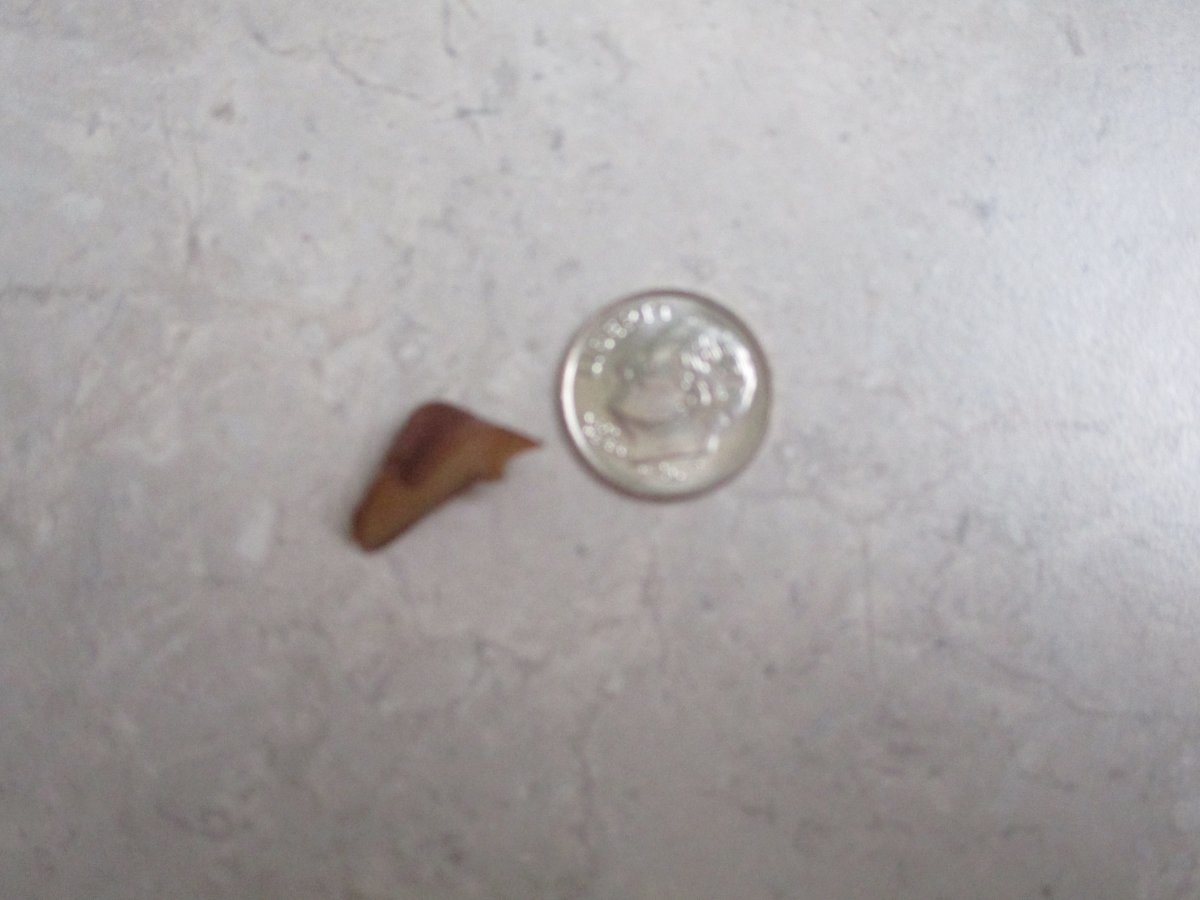

Took the oil pan off yesterday for a thorough cleaning and to replace the pan gasket and found this little gem inside. It reminds me of the old nylon timing gear teeth from way back but it doesn't look like a broken tooth. It's nylon but has a corner to it as though it broke off something. Engine runs fine, 139k on the 4.0 2001. Oil stained. What is it?

Seriously though, it may be a chip off a tensioner bracket for a timing chain.

That is about the only thing that is of any plastic in the engine, except for the tops of the roller lifters have a small plastic cup on them. If it isn't making any harm anywhere, I wouldn't worry about it. cheers
let me re-phrase that. I just noticed this is a 2001 engine i was thinking first gen 4L. I am not aware of what is in the newer engines. sorry
Given the propensity of the early 4.0 SOHC engines to suffer catastrophic timing chain tensioner and guide failure, and being that those guides are plastic...
It obviously came from one of these pieces...
I'd be a bit more concerned & would remove valve covers for a closer look. at the left+right TimingGuides.
That small chip from a timing guide could have
been there since the engine was first started at the factory, or a guide could have just given out last week.
How many miles since the OilPressurized TimingTensioners were changed?

That depends. Is the chain making any rattling on start up? Is it continuing to rattle while you drive? If no, then you should be good for now but I would recommend changing the external chain tensioners every 70,000 miles. If the chain tensioners and oil has been taken care of on a regular basis, you could drive it indefinitely.
There were some issues with the early 4.0 SOHC engines with the tensioners and the chain guides. If you can verify both have been attended to with improved parts, you shouldn't have any worries. If you don't know any of this, it may be worth your time finding out and to confirm that, that piece in the pan isn't part of your current chain guides.
If you are the original owner since 2001 and have never replaced the tensioners you should probably go buy a lottery ticket. :icon_rofl:
If the tensioners were updated and have been replaced on time the timing chain can last basically forever. Once the tensioners go the guides fail and at that point there is nothing you can do except pull the engine.
If he thought valve cover gaskets were a challenging job don't let him attempt tensioners or cassettes. If I found that on my engine and decided to let it go for a while it would strand me on the way home, I've recommended that customer get something fixed as soon as they can and they've driven another year with no problem. To quote Dirty Harry "do you feel lucky"

There is a rattle on startup every time and it stops within a second or two. And it's been there quite a while. I thought it was a fan belt noise...or a rat caught in the belt..
Time to talk to the mechanic...sigh.
The tensioners themselves are pretty easy, but at this point if the guides are busted it's a much bigger job.
