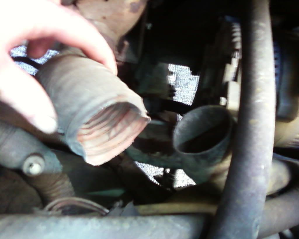

First the hard pipe comes off of the air intake behind the headlight, the flexible hose connects to the exhaust. They were disconnected when i found them.... WTF?

first pic.... thats a pre heat hose for cold weather starts, and yes it gose on the head shied of the exh manifold so that is right...
not every connecter is used on every truck.. may go to a higher trim package truck.....

Ok , so then should I reattach the hose?

you dont need that tube from the exhaust manifold...
