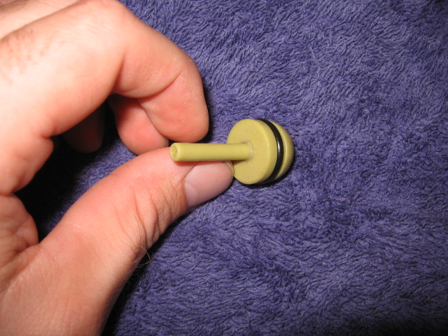

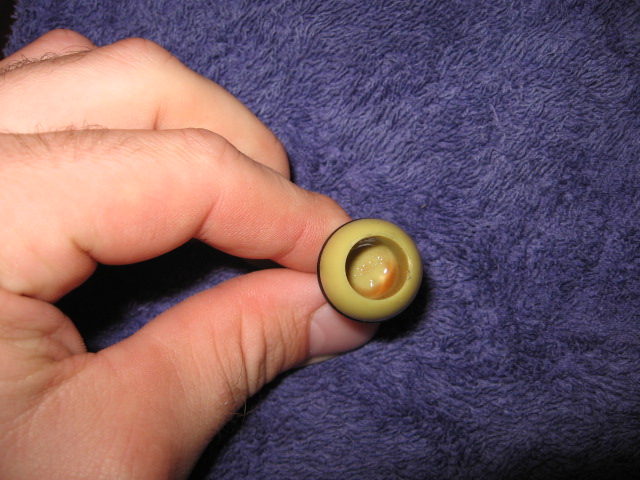

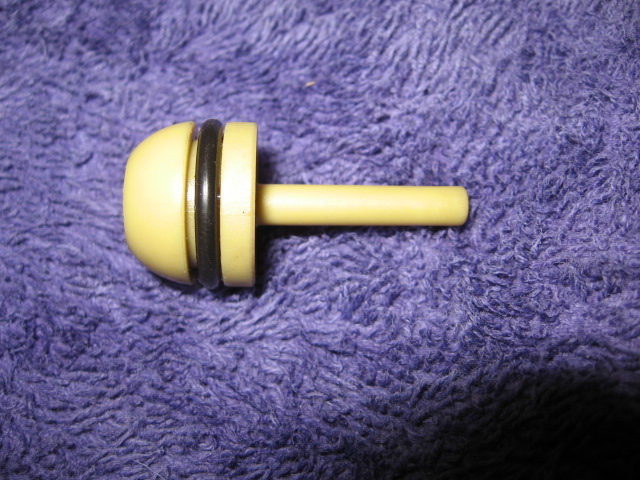

Ok, so I wasn't really sure where this belongs (urgent help, transmission, engine swaps, etc), so its here (mods can move it if they are moved to do so).
Since dad has been getting anxious to get his Ranger on the road, I started giving him things to putter around with to work towards getting it ready. (2000 Ranger extended cab 4x4 auto power everything that originally had a 4.0 in it - we swapped a 5.0L from a 1999 Mercury Mountaineer along with the auto trans and the awd t-case).
So today he dropped the transmission pan and went to change the filter (figured it would be a good idea to do it now rather than later). So he said that he dropped the pan and started dumping out the fluid from the pan when he came across this strange little plastic part with an O ring on it laying in the bottom of the pan. He couldn't figure out where it went and our one neighbor who is a mechanic stopped by and said that he couldn't figure it out either.
I've never seen such a thing before. :icon_confused:
Hopefully someone on here has seen it and knows what it's purpose is though....

Congrats, your trans has never been serviced :yahoo:
It plugs the dipstick hole before the trans is installed for the first time, when the tube is installed the plug pops into the pan where it waits harmlessly until it is serviced.

85 is right to a point. He is right about what it is, and it's presence does mean the pan has never been off before. But there are correct and effective methods of servicing the trans that don't involve pan removal.
