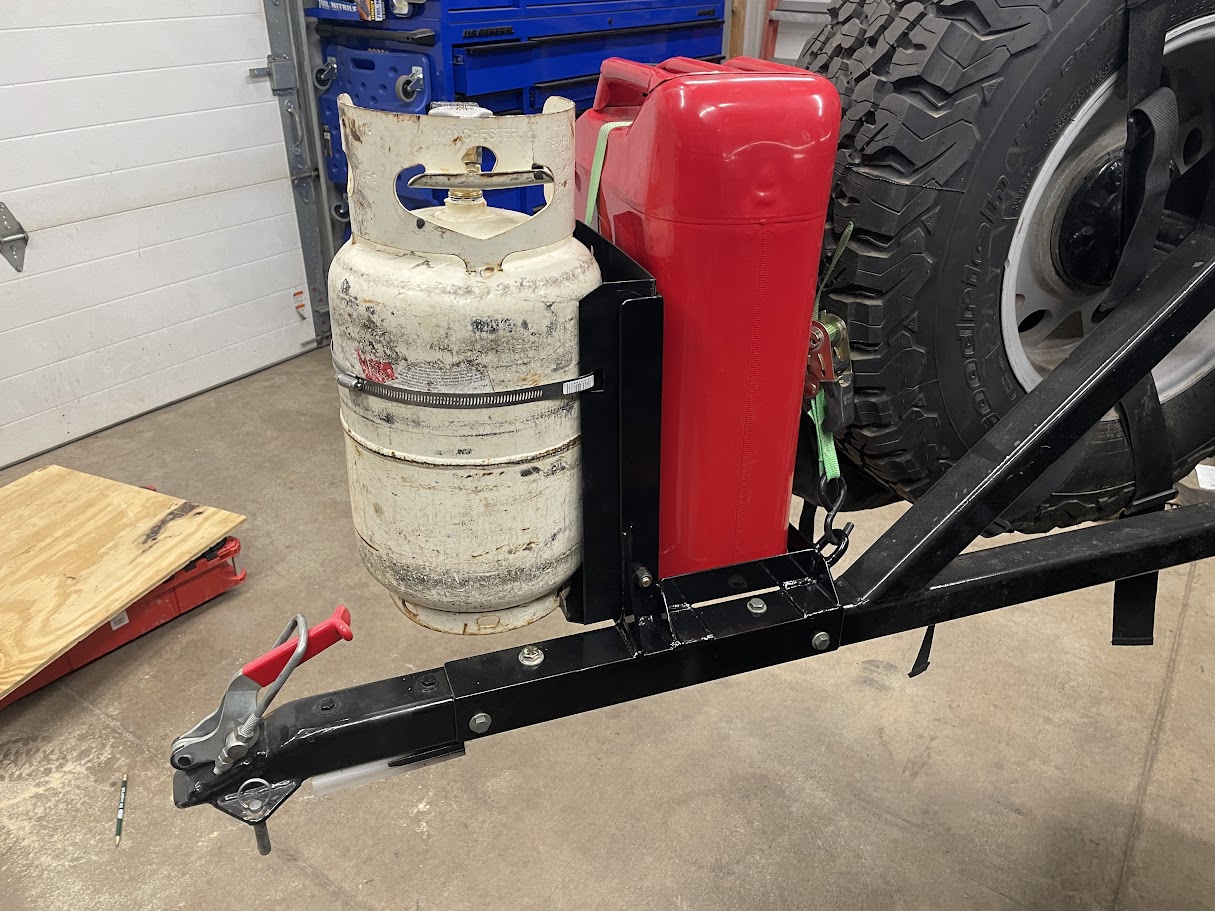

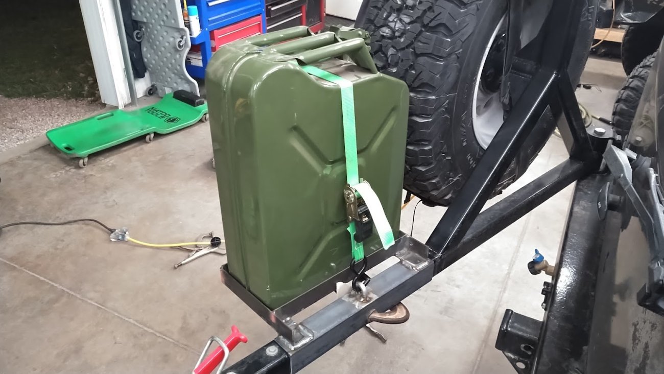

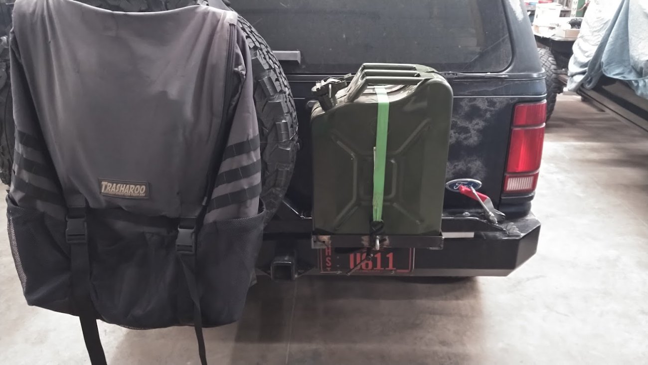

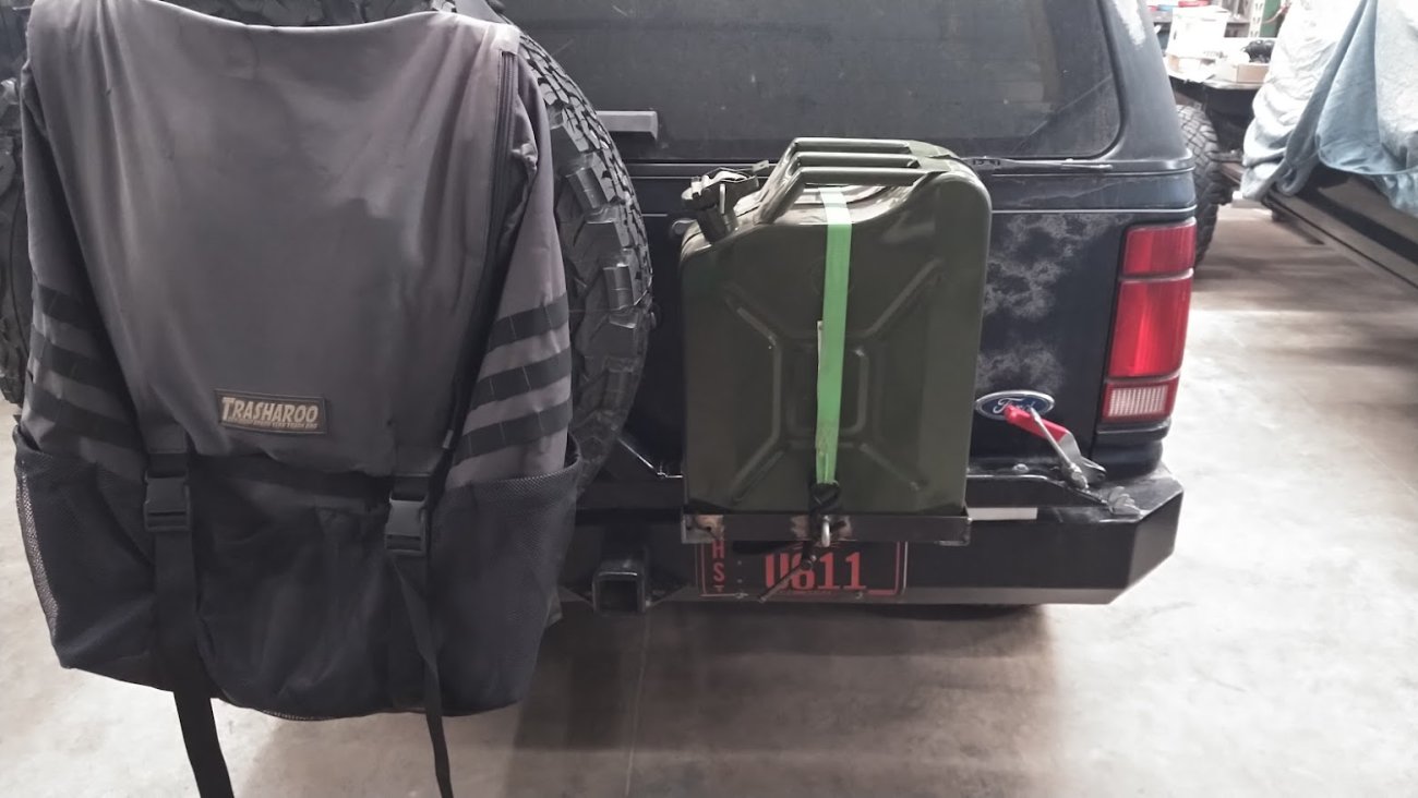

I built a gas can mount back in 2022:
At the time I was pretty happy with it but I found that those green gas cans kinda suck. Namely the lid grommet... gasoline turns them to goo, and the "good" aftermarket ones are too thick. So I scored a Blitz jerry can but the damn thing is just a hair too big to fit! Have to rebuild my mount... why not integrate a propane tank holder into it too? I had a 5lb propane tank in my shower Packout box but keeping the propane outside is a little safer and frees up room inside.

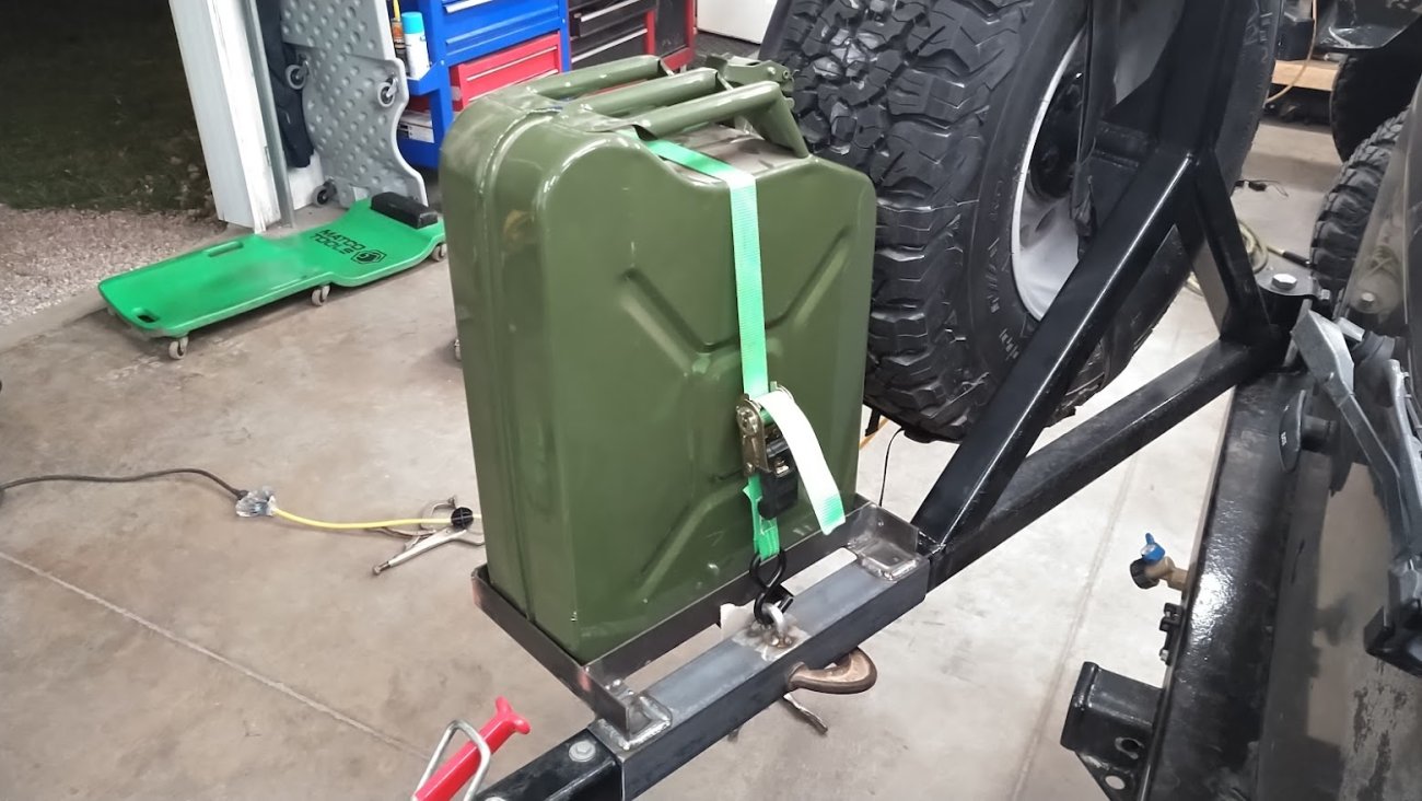

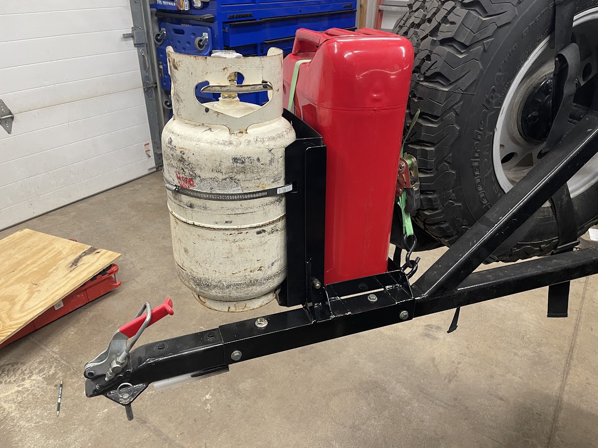

Here's what I am working on - not quite done yet but this is the general idea:

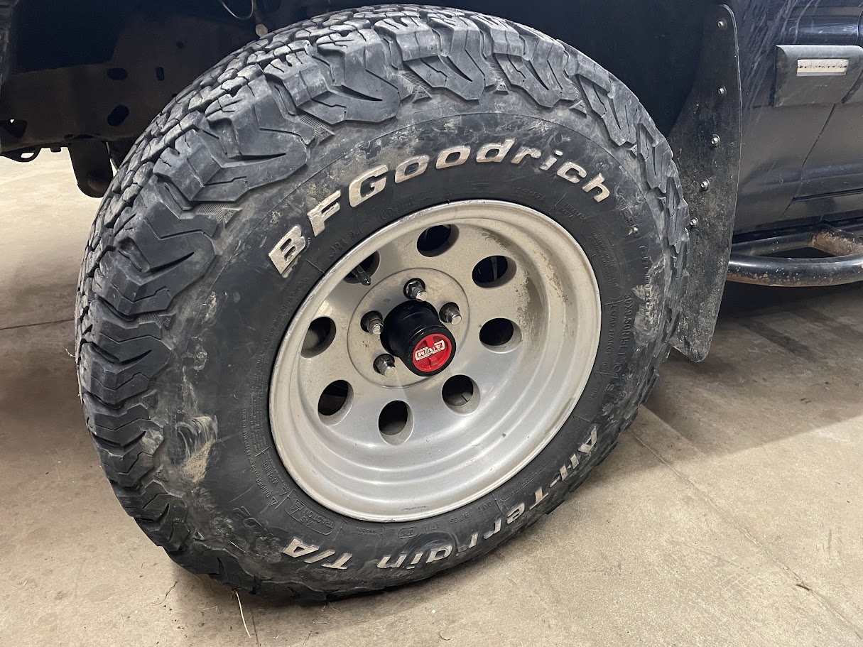

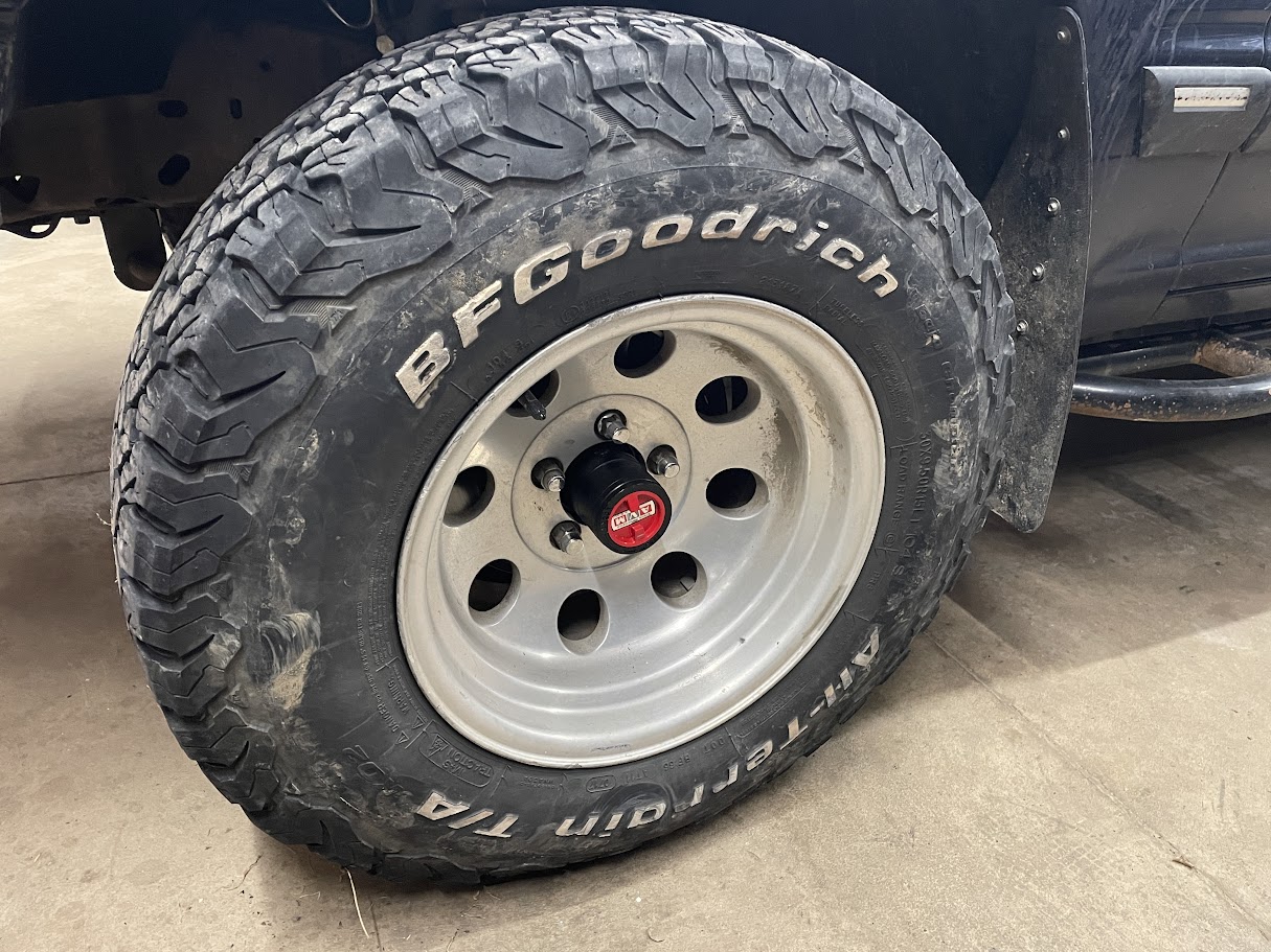

Also got me some of those fancy AVM locking hubs. These things are legit. Probably moving the weak link in the axle to the u-joints now but that's OK, I have a lot of D35 shafts and Spicer u-joints are cheap. Factory locking hubs are plentiful in my collection but if I don't have to destroy them, I won't.
I've been thinking about ordering a pair. How would you compare them to other hubs you've used?
My immediate impression is that they look very well made. The main piece is steel or cast iron so it’s going to be much harder to break that vs the Ford hubs that are zinc/aluminum/whatever they are. I would say go for it!
@4x4junkie is the only other person I’ve seen on here that has them and has some trail time on them.

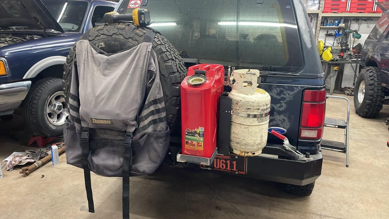

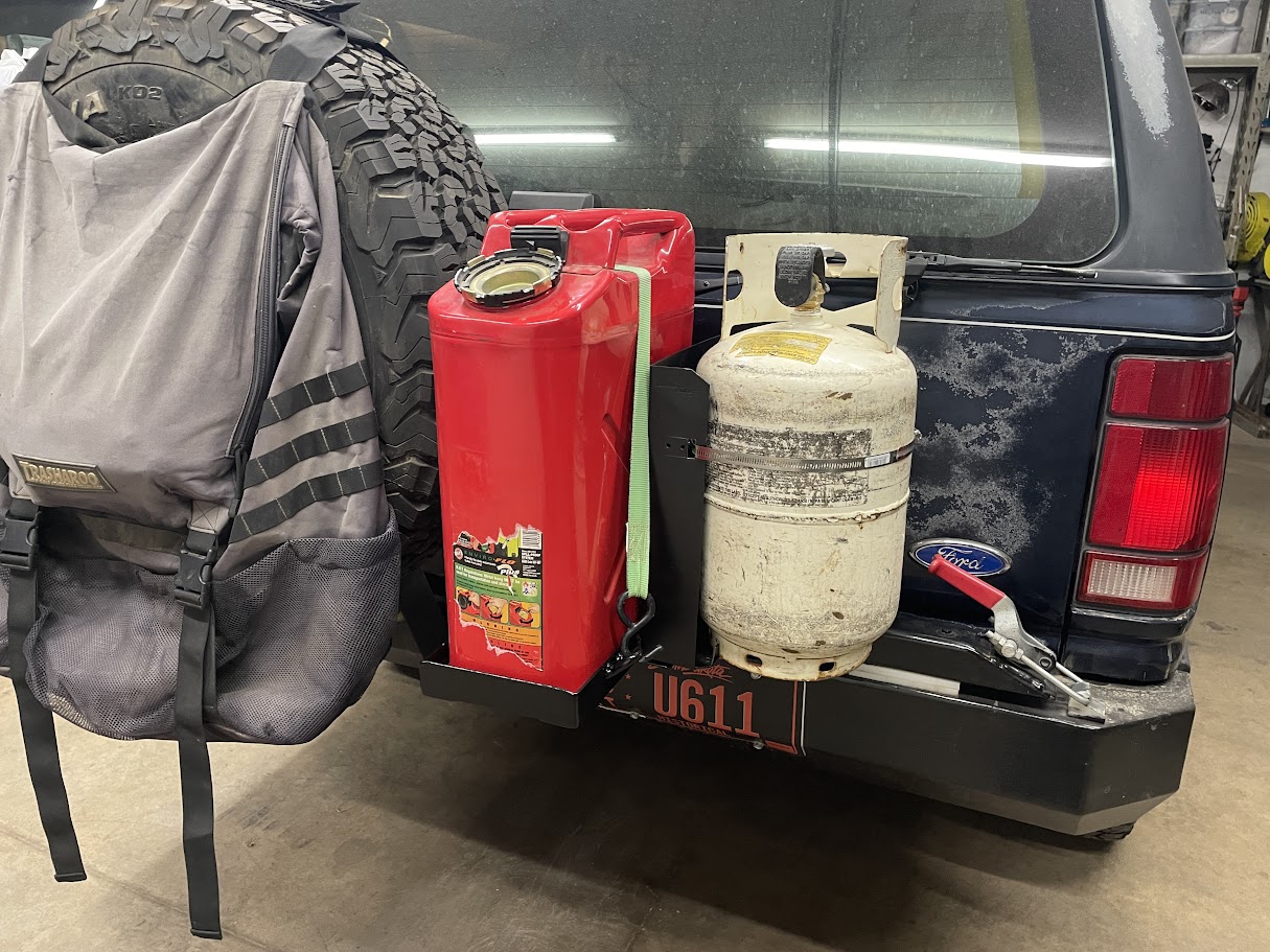

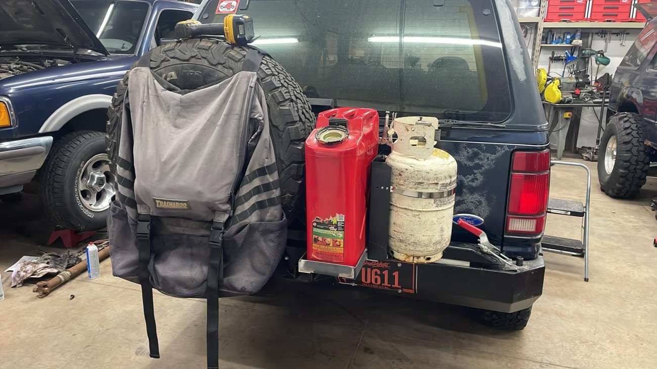

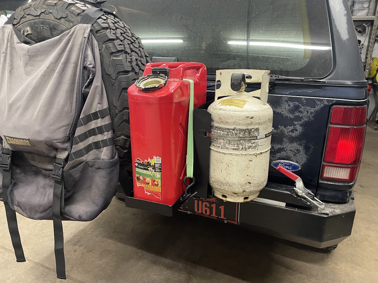

Finally got my propane tank back from getting a new valve, and assembled the whole deal onto my tire carrier swingout. I used a couple of big hose clamps to hold the propane tank onto the mount, hopefully that and a cable will keep it secure and prevent easy theft.
View attachment 123457View attachment 123458
Not that I think dot or cops will care too much, but carrying a tank like you are is not legal. At least in Canada. That said, I plan on doing very similar with my RV. Putting some type of cover over it would probably help too... If nobody sees it, how can it be illegal?...lol.
and the jerry can is much more likely to rupture in an accident.
Edit; looked at your mounting... Probably 80 lbs of gas and propane hanging off that. You sure it will stand up to vibrations and shocks while traveling?
I'll beg forgiveness on that. I don't know if it's legal or not in the US. I guess I don't see it being any different than putting one on the hitch of a camper trailer or on the back bumper... I see that a lot on trailers of any age.
I think the mount is OK. I was figuring about 60lbs. I may revise two of the bolts slightly - the horizontal ones - I may drill all the way through the tire carrier arm and use two larger, long bolts there. Right now all four are short bolts into rivnuts. The old mount survived a couple years of wheeling and I had no issues with it but there is more weight and more leverage here.
