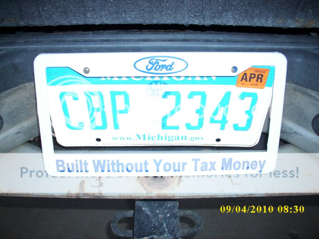

i went over to my buddys house last night and came home with a new license plate frame. his dad works for ford and one of his friends that recently retired from ford BUILT all the jigs and molds in his home garage and hand made these for his friends still working in the plant. i couldnt get the bolts out of my plate when i took the picture because all i had to work with was a quarter to turn the screw and my fingers to hold the nut but that shit was already rusty.

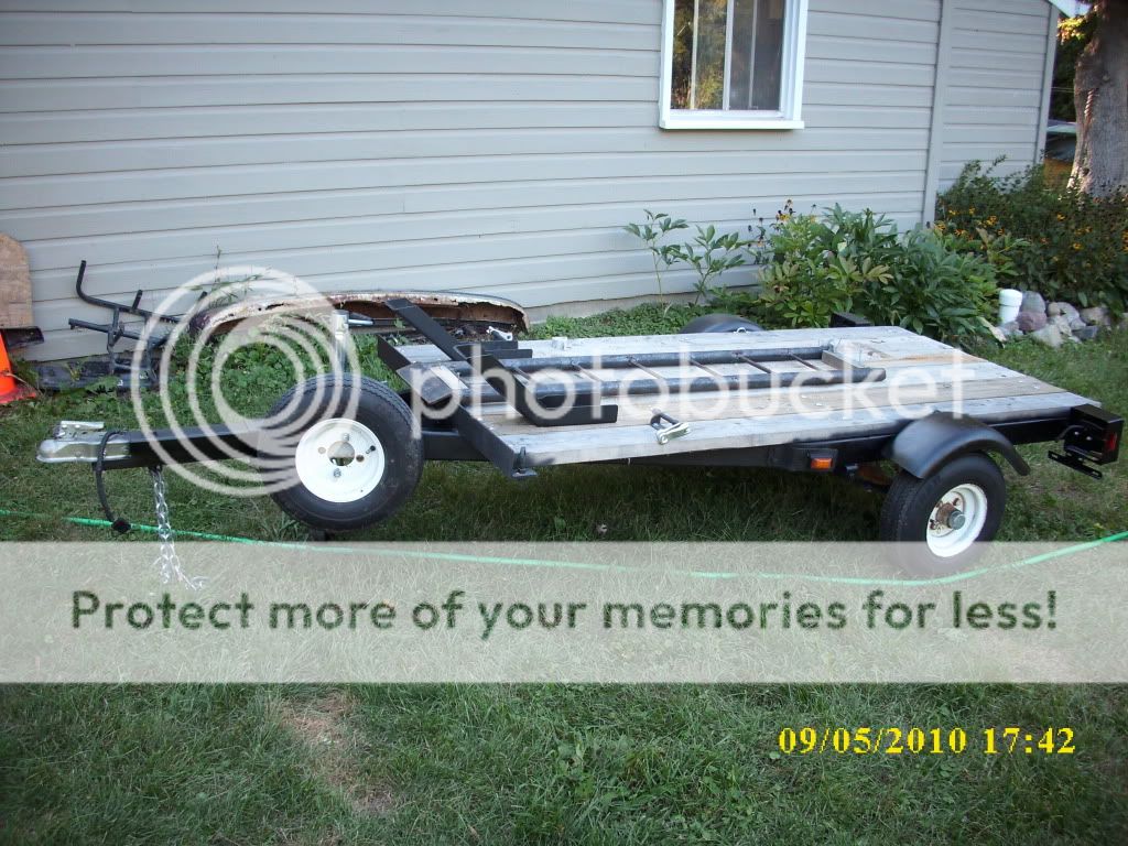

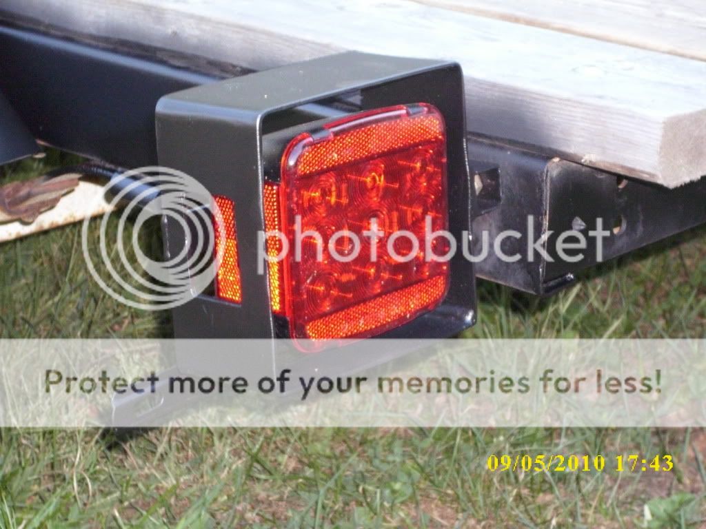

ive been getting ready to go riding up north next weekend and one of the things on my list was to get my trailer lights replaced and make guards to mount them to so they will be protected from my brother and other dangerous objects. i still need to make extendable outer tie down spots, but its coming together quickly.

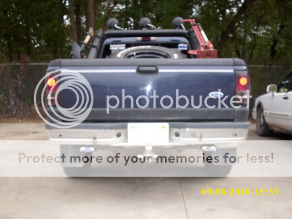

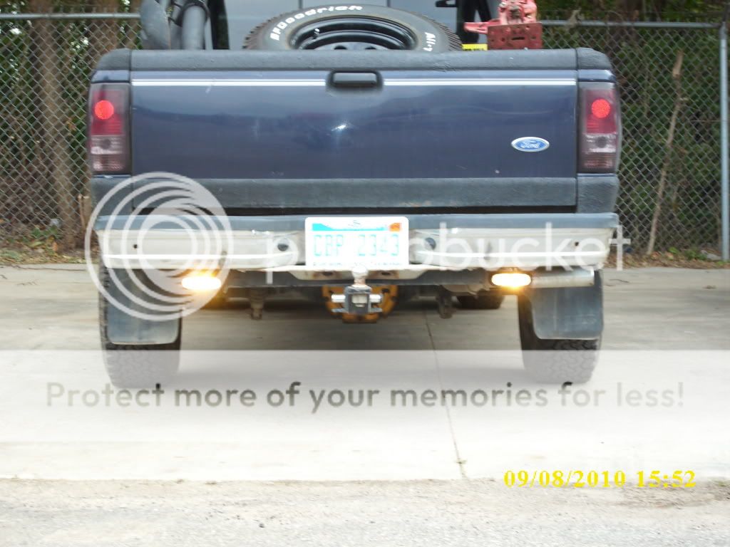

after driving around for a few weeks with only one back up light working, i decided to order some slimmer halogen lights and mount them flush with the hitch. they are yellow but i figured it would be less blinding to others while still allowing me enough light to see where im going.
youre so thoughtful :icon_thumby:
well..... kinda. theyre wide beams so one will be aimed low to the ground so i can really see, then ill pull another average sized car about 1 car length behind me and aim the light carefully at the drivers windshield, that way when the next dumb girl in her prius is talking on her cell phone and gets so close to me that i can see her past my spare i can "show her the light" so to say.:D
hmm, now thats a good solution to a problem i get a lot too.
What... Customs and Border Protection??
I haven't seen you 'round here :icon_twisted:...
hes referring to the other boarder, those canadians are a rowdy bunch.

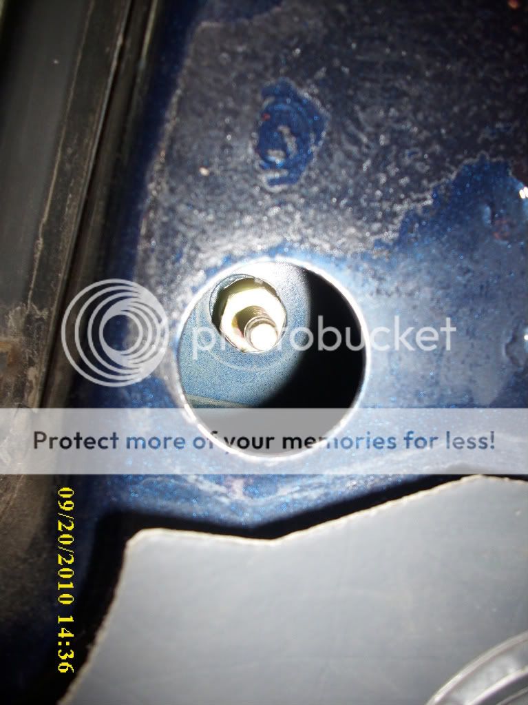

now youll need the drill with the 1/2" bit to enlarge the mounting holes, which is necessary to the clear the mounting studs on the new mirror. it should look like this now

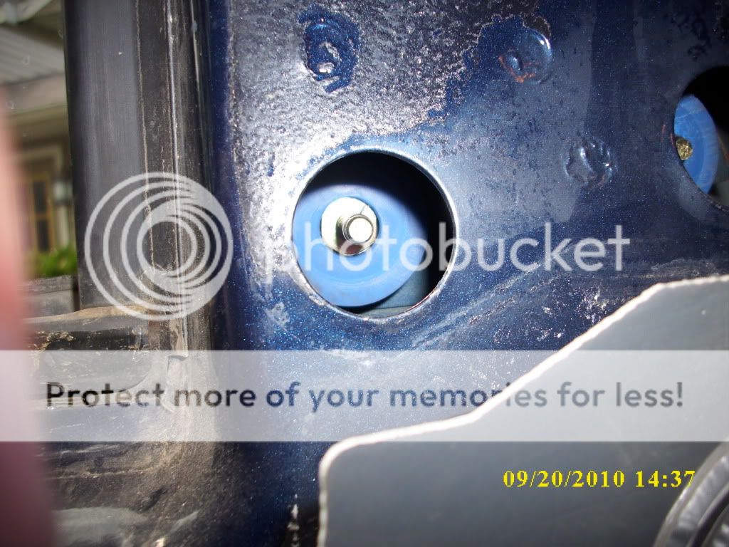

now that youre all wired up reinstall the mirror but only put the top nut on and leave it loose for now. take the bushings you cut in half, reach inside the door through the speacker hole and place them on the studs.
