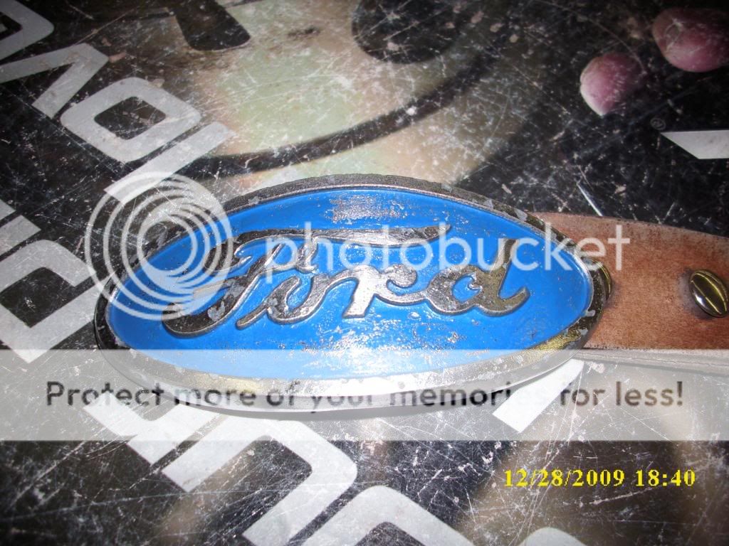

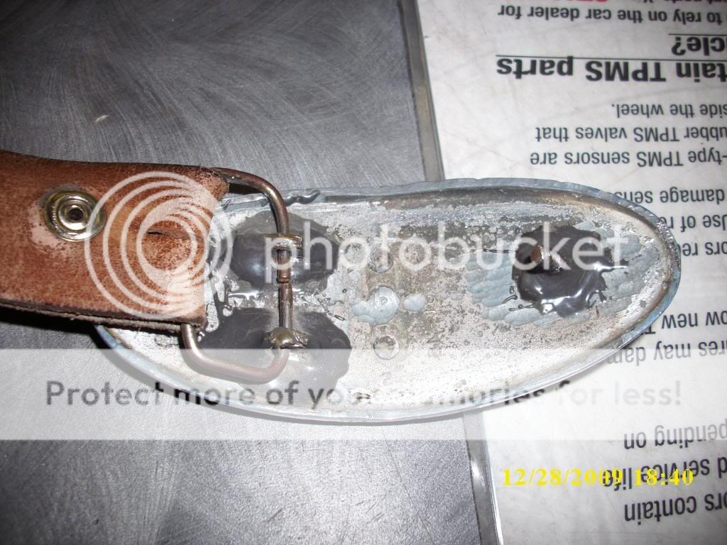

heres a pic of my other belt buckle that i have worn every day since july of 2005. it is the front emblem off from a ford 8n tractor that i found in the woods when i scouting some property out for small game hunting. i jb welded some 10-32 nuts to it, a phillips head machine screw with a custom bend, and bent up a coat hanger from my old uniform service. the jb weld held good until i decided to get drunk while fishing one day and then went for a swim cause it was hot. once i was out of the boat i realized i was too drunk to get back in so i stayed in the water until i drifted to shore with my boat. by the time i got home the jb had softened and my buckle fell apart, so i got some permatex cold weld and its been fine ever since.

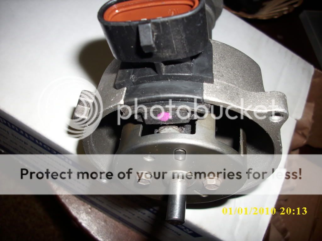

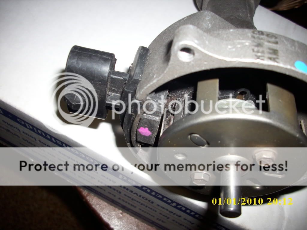

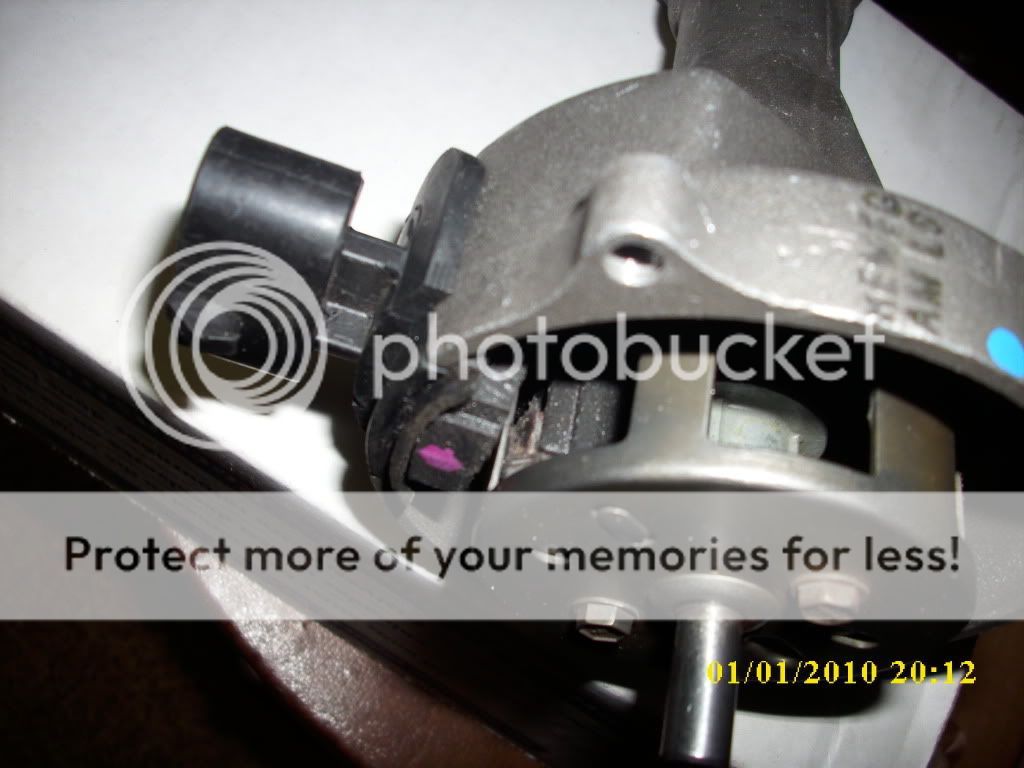

ok, thumpers alive again and all is well. it turned out to be another faulty distributor, but this time the magnet broke away from the pick up module and was sticking to the reluctor wheel everytime it passed by. hopefully this one will be trouble free, but it did make me wonder if these remaned units get new pick up modules or if they just plug them into a test machine and say "yep it passed, put it back in". if thats the case these units probably have pick ups that are 300,000 mi + on them since these 3.0ls run for so long!

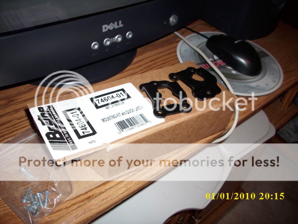

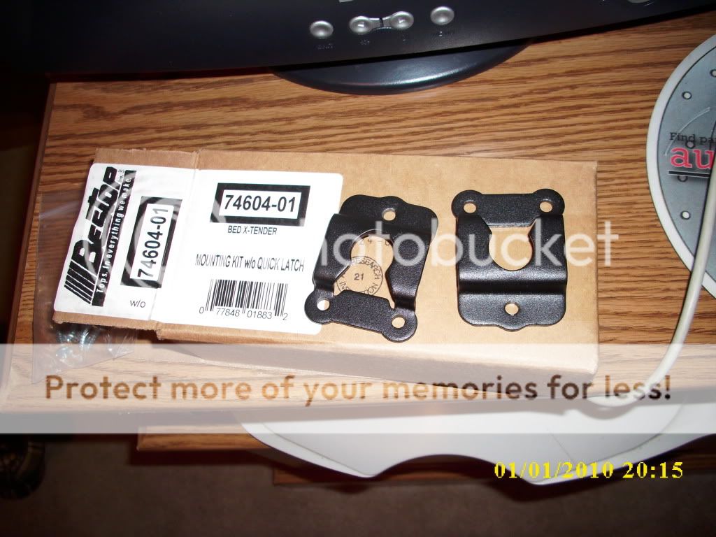

i also got my brakcets in the mail for my bed xtender, they shipped them in this box, which was inside of another box, which was filled with packing peanuts. i think they went a little over board, but i got them quickly and in undamaged condition.
