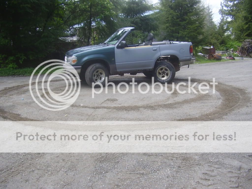

thanks....beats working.
steer
turning circle...this was just driving easy unitl the last little bit where you can see i goosed it a bit.:icon_bounceblue:

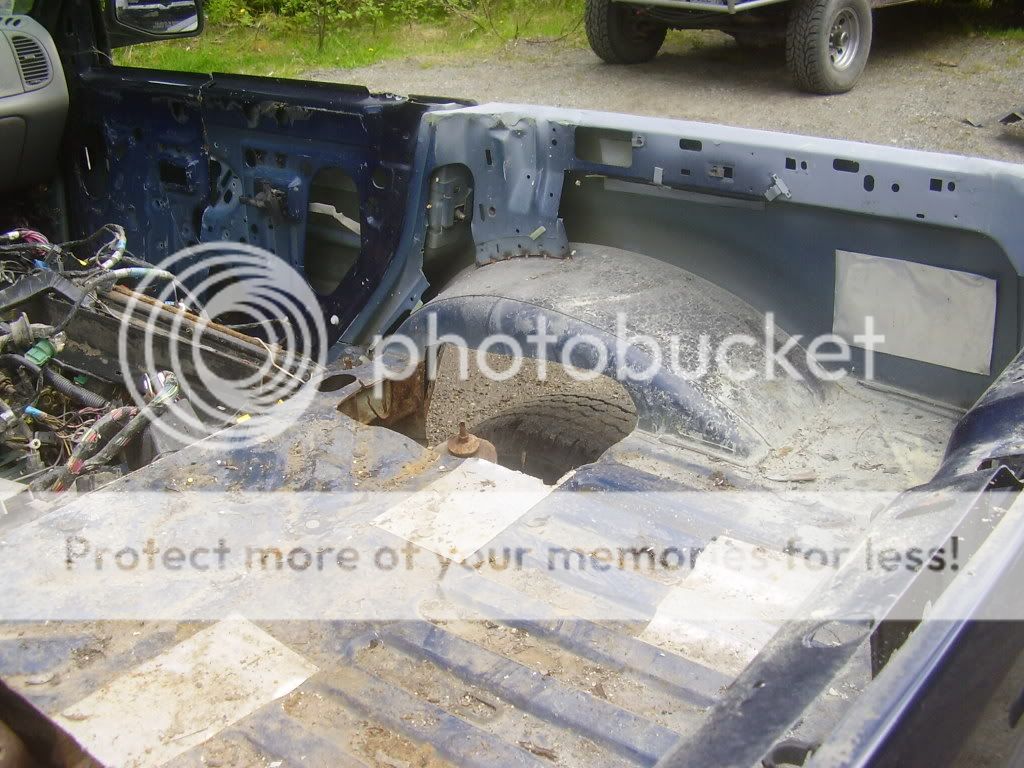

rear floor,just had to notch the wheelwell to clear shock and upper arm,very easy to cover over:icon_welder:

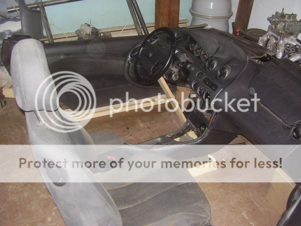

wait till i get the bodywork done and throw some paint on.i want it to look like it could have come from the factory like this.keeping the stock tires and height,and making a tonneau to cover the rear area.interior from a 00 cougar is going in,sports it up a bit.

this is the dash/seats/door panels going into the interior.
