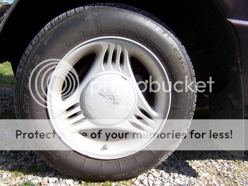

The split 3 spoke GT wheels from a 94/95 GT fit and you can use the center caps as well.
They fit much better on a 2nd gen, but a 5th gen, they are too inboard for my liking, but they work without rubbing. I'll get the 5th gen shots up after my event on Sunday.

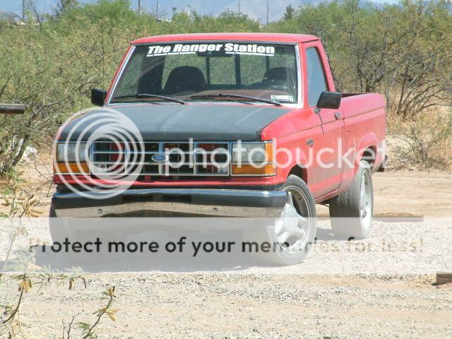

91 Ranger, 2wd. The tires are 245/45/17

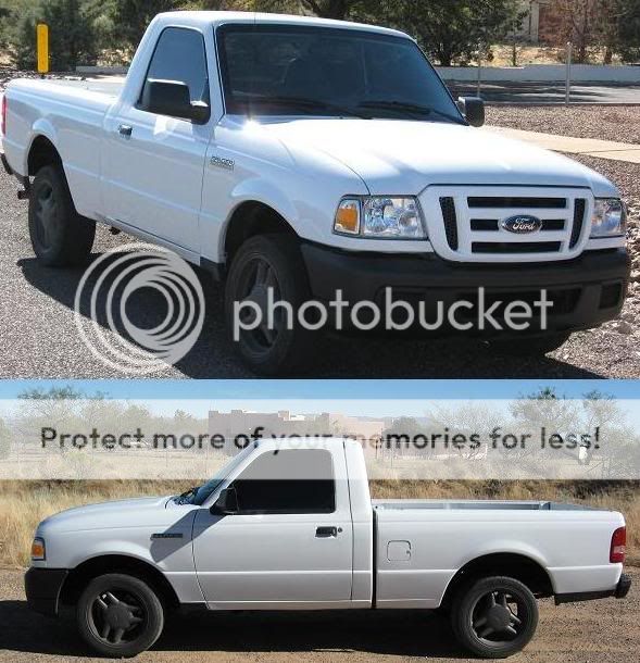

03 Ranger, 2wd. The tires are Kumho Ecsta SPT 245/45/17. The truck is in a hardish turn right now so the wheel gap is used up a little, but you get an idea.

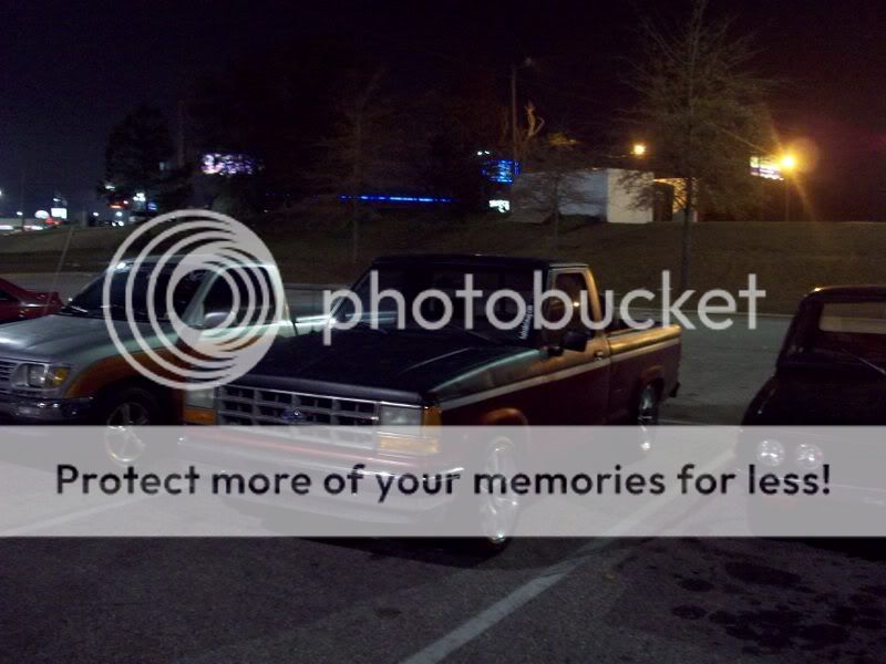

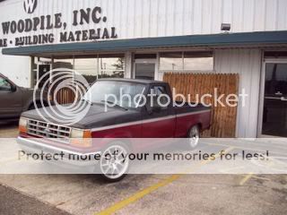

-I have 17x9 AFS bullet replicas on my '88 Gen I with 245/45/17 and the center cap goes on fine. no clearance issue unless i turn hard left to lock, then it will rub slightly....:icon_idea:
as seen in my avatar.......

07 2wd Ranger XL.
17" 94-95 GT's w/ 245/45/17 Ecsta SPT. They fit better on the 07 than the 03. Again, no modification required. 255/45/17 would look better but it would push me into a different class.
