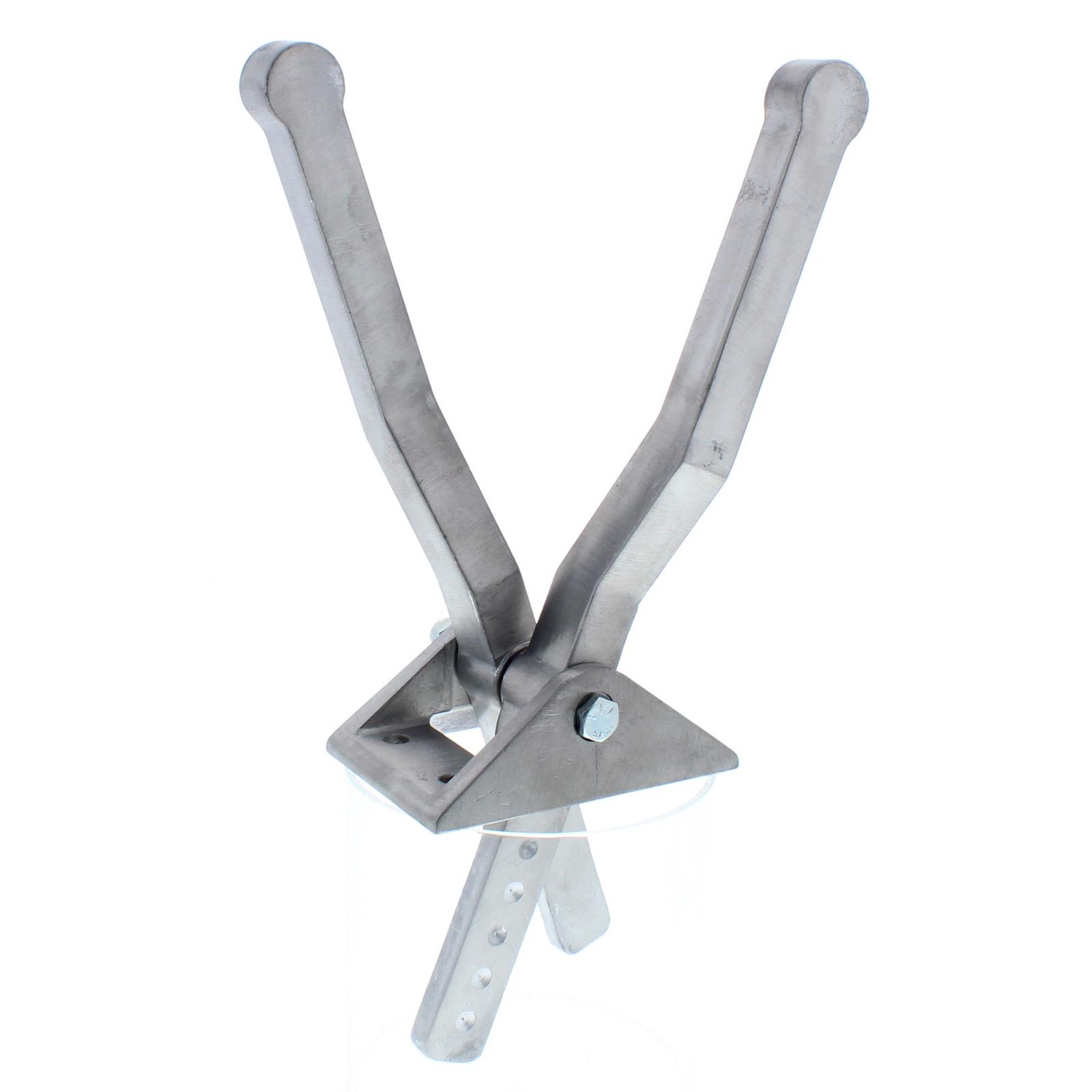

If I ever twin stick a 205, My plan is to use this shifter setup from Speedway motors for $20...
38960
Do you have a part number for anyone interested? That would greatly simplify the DIY portion of it...
Great company to work with too and if you are ever around Lincoln NE they have an awesome car museum. :icon_thumby:
Speedway motors economy shifter 91021950
