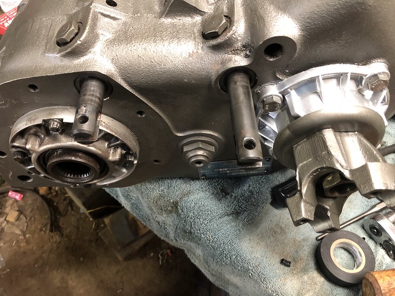

3. There are two shift rails, we are picking on the one nearest the input/rear output. For this mod there is no reason to pick on the other one. Using the punch tap out the small soft plug and let it fall into the case. Loosen the 3/4" hex plug near the soft plug you just tapped out and move the shift rail so you can see a roll pin on the shift rail inside the t-case. Using the roll pin punch, tap out the roll pin (it is actually a spiral pin) and let it fall into the case.
Ford NP205 Twin Stick
4. Remove the loosened hex headed plug. The spring should come out with the plug, use the magnet to remove the ball. Put in safe place (magnetic tray, Ziploc bag... do not leave loose because they will probably run away)
5. It will take a little finagling because the shift fork will want to bind but pull the shift rail out of the case. Be gentle, keep playing with it.
6. Remove soft plug and spiral pin from case thru the PTO hole. You may have to move the case around to get them to roll towards the hole. Put in safe place with other small parts from step 4.

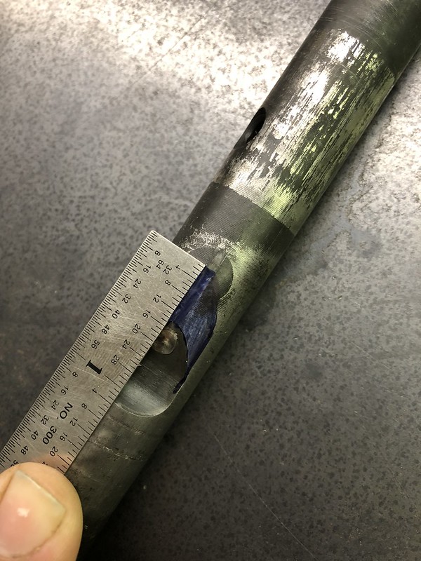

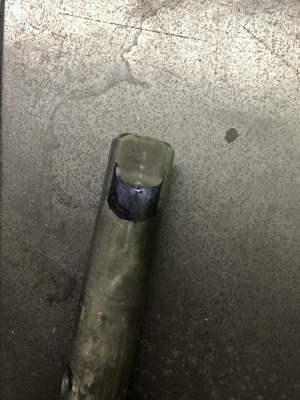

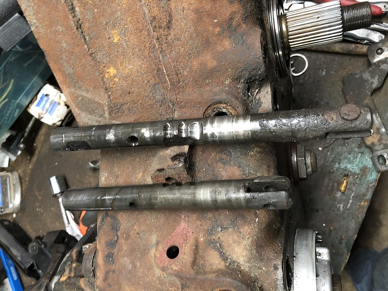

7. Clean the 40-50 years worth of dried grease off the rail. Using your measuring device of choice and a sharpie measure back 7/16" on the center notch. I drew a line from the flat of the "valley" on each side and then one from the peak in the center to try to get the somewhat the same dimensions for the ramp. Fill the whole thing in with marker, try to simulate how you want the ramp to be. Being very careful grind out what you have marked. Remember going back and grinding more is easier than welding it back up and trying it again. Also note you have to have the grinder tipped quite a bit to not catch the other side of the valley (you can see I nicked it a little)
8. At the other end, mark inwards 3/8" of an inch using the same technique. It is easier going and I managed to make mine look somewhat professional.

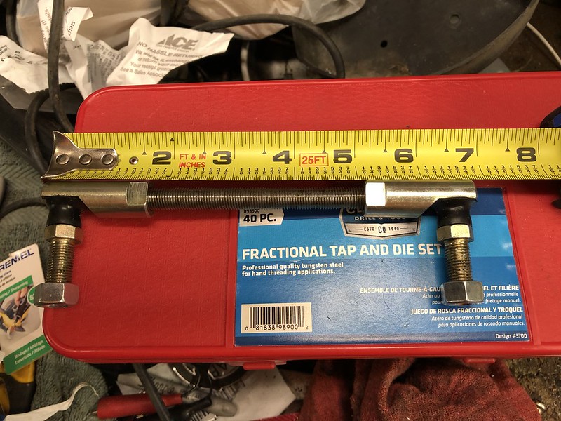

9. If you are going to change the seals do it now. Hook type seal puller works great, National 2287 for the seal. Both rails use the same seal but I am unsure of the "correct" procedure for the front shift rail seal without tearing it all apart.
10. Tip the t-case on the back with the input pointed up. Watching down the shift rail hole with the penlight and reaching into thru the PTO hole get the shift fork lined up so the shaft will go in it. If you get too far over and lose the fork set the t-case back upright and wiggle it around, you will hear the fork will fall back into place (it did for me anyway)
11. Slide the rail back in. Again it will want to bind with the shift fork but keep working it and it will go.
12. Position the shift rail and fork (use a punch to line up the fork) so you can see them in the hole the soft plug came out of to reinstall the spiral pin.
13. Reinstall the detent ball and lightly install the spring and plug to hold the rail in place (a notch will line up and put the spiral pin holes in line with the soft plug hole) Lightly installing the plug makes it easier test shift without the 2' long lever.
14. Lightly tape the spiral pin to the roll pin punch with the electrical tape. You want it to be able to pull off and stay with the punch so don't go too crazy with it. Go ahead and tap it in, you can get it a good ways in and switch to the bigger flat punch so you don't go too far and start tapping it on thru.
15. Moment of truth, see how it shifts. You can go ahead and loosen the hex cap on the other side so it is easier to shift with the lever. MAKE SURE YOU CAN NOT PUT IN OPPOSITE RANGES OR YOU WILL GRENADE YOUR CASE!!
All the way in is low, middle is neutral and all the way out is high. If you can get the front in say high and the rear in low (or vice versa) you went too far with the grinder. You should be able to shift one side or the other into gear with the opposite side in the same range or neutral.
In mine the front has to be in neutral before I can shift the rear. Once the rear is in gear the front will easily follow suit.

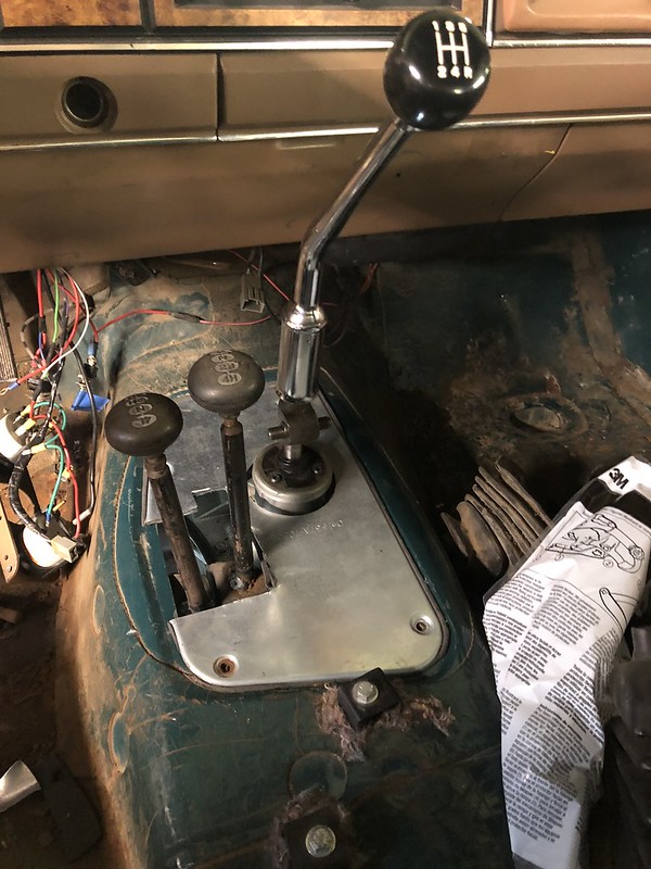

You will need to either fab your own levers (you will need two levers now, hence "twin stick") or buy a lever kit.

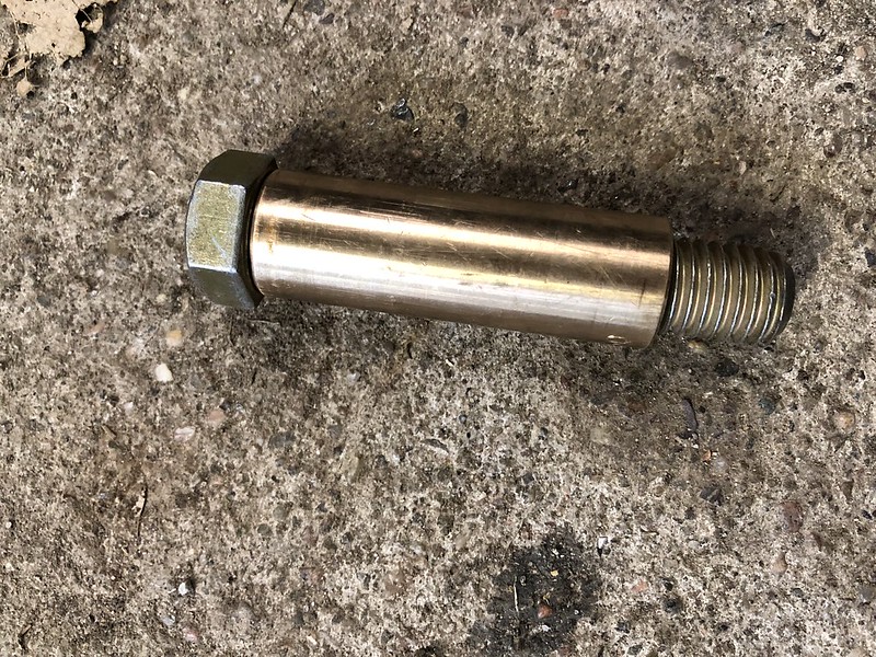

- Two NP-205 Shift Levers w/plastic bushings
- 9/16"x3/4"x2.5" Baum Hydraulic part # CB09-1218
- Bolt

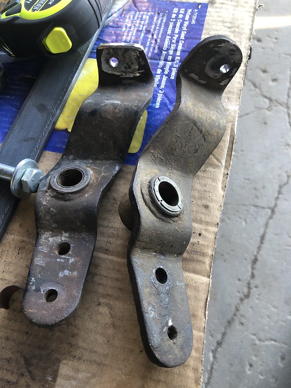

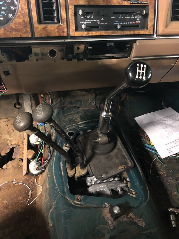

Step 1. Mount the levers on the transmission, see how they interact with things in the cab. The dash, the seat, other shifters, your leg etc. I used one lever from a married NP205 and another one from a divorced.
Purely unintentional but they had slightly different angles/height which helped keep them apart.

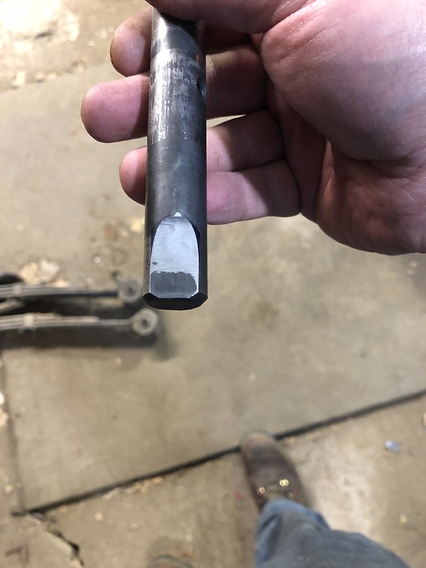

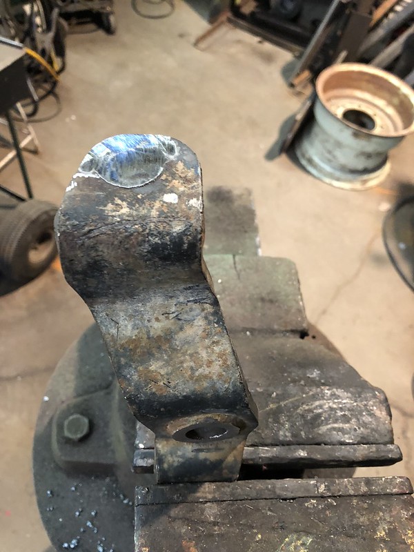

Step 2. Remove the levers from the trans, cut the bar off the bent part and grind it flat.

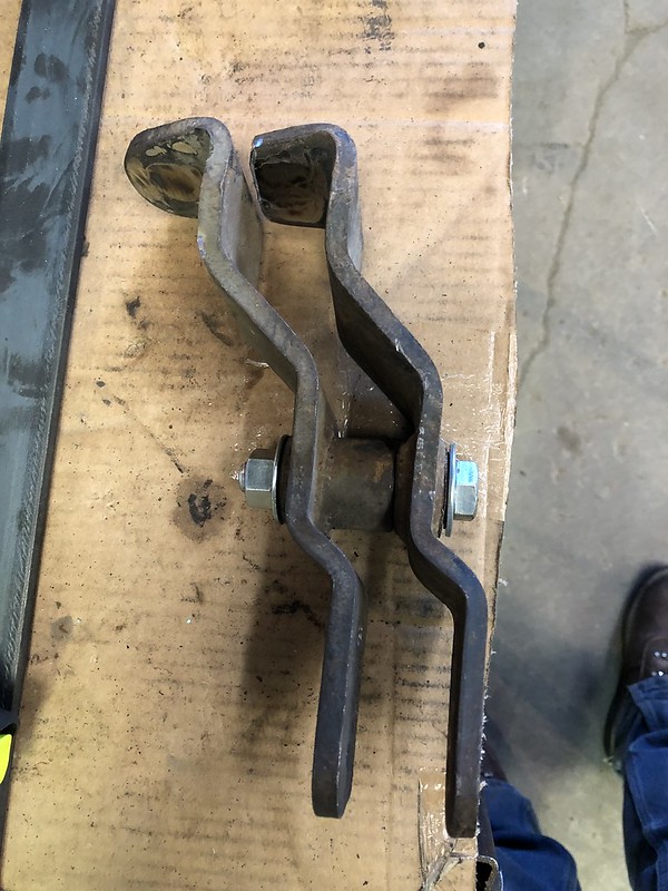

Whichever one you want for your outside lever needs to be have part of the base shortened up to fit right, cut/grind that down so you can still have one plastic bushing in it, the bronze bushing should protrude slightly with both levers on it.
The inside lever will need some clearancing at the top so it doesn't bind with the outside lever. Mr angle grinder to the rescue again.

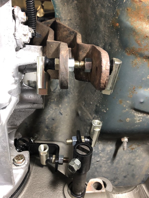

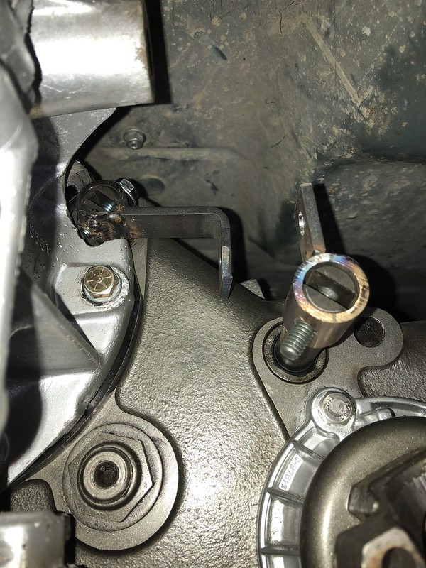

Drill holes in the seamless tube so they can be bolted onto the shift rails. Bend the straps so they line up with their respective levers using the torch and bench vice and vice grips. Drill a 3/8" hole on the outer end.

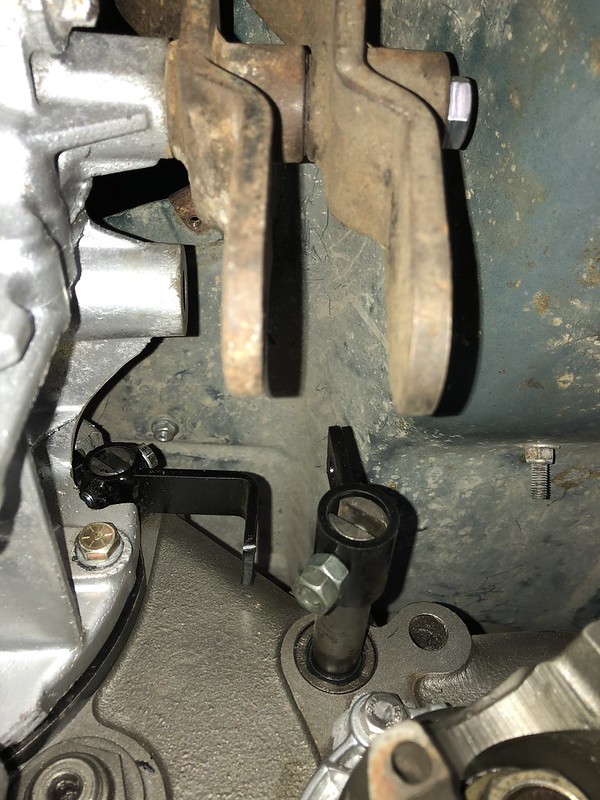

Install the joints on the levers and brackets. Put the t-case in neutral and kinda figure where you want the levers to be in neutral (the middle adjustment) Put the t-case in high and low and eyeball the levers movement and see if you want to adjust anything. Remember for a street driven truck the left lever will be in the center and the right lever will be to the back (2HI) most of the time.

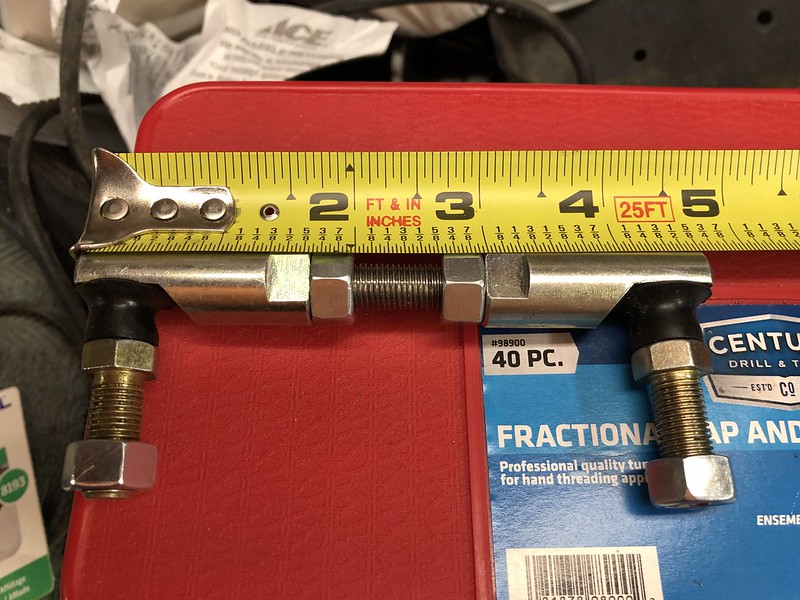

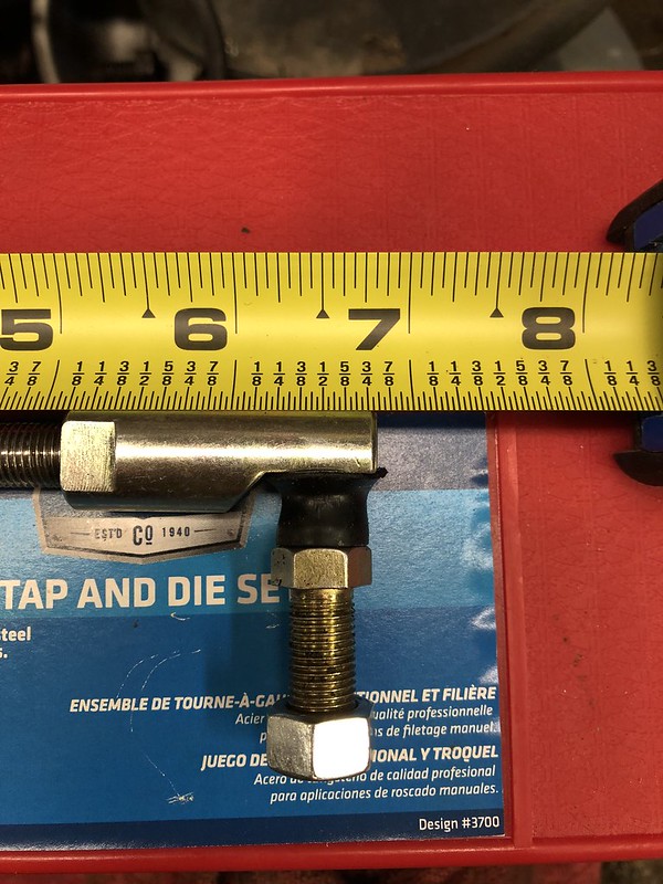

Measure for the threaded rod, remember it needs to go inside the joints and that is easier to make it shorter than it is to make it longer. Here is what I ended up for actual working lengths, your results will vary.

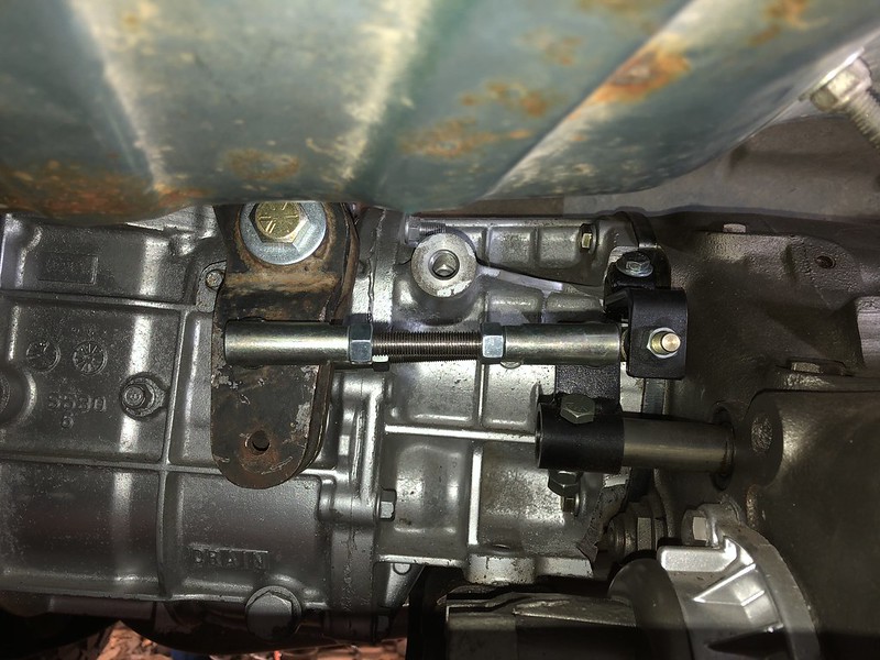

Clean up the threads with the die after you cut the threaded rod and install with nuts. Make sure you are happy with how everything works, you have some adjustment with the threaded rod if you need it. Then trim floor plate to fit the lever travel and install.

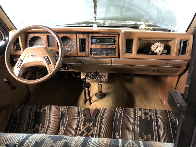

Reinstall your interior, add shift boots if wanted and have fun!

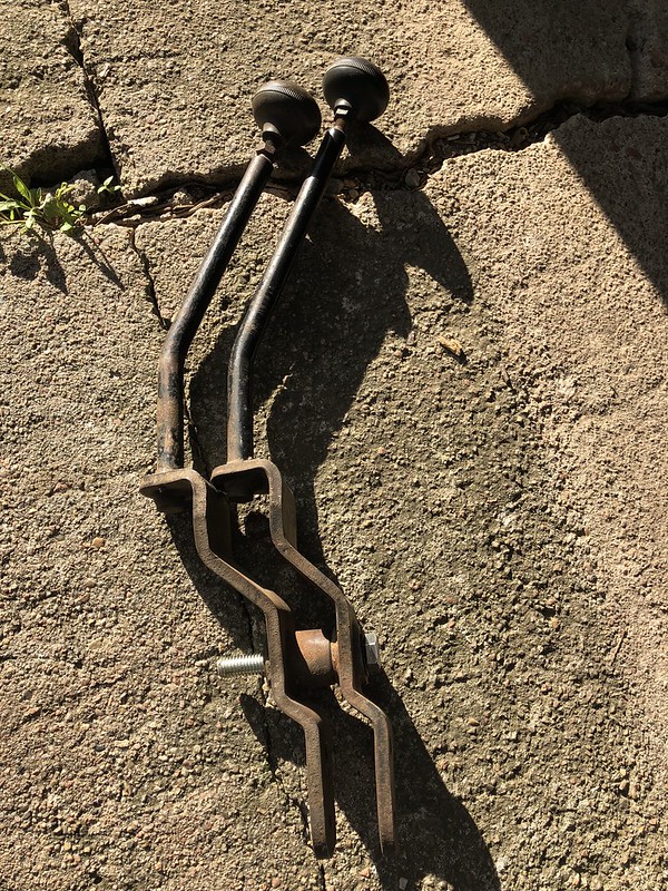

Great work... factory 205 shifters are a dime a dozen and that method is an excellent option. If your budget allows and/or you're just a lazy dirtbag like me, JB Fab makes a whole kit. It requires same same shifter rail mod or replacement (I replaced mine, it was easier, and they ended up being really worn anyway.) I had to send my shifters back and have them shortened because they were way too long, they're stainless or I would have just cut them off myself but it only cost me shipping - JB's customer service is just awesome. Here's a little pic dump from my twin stick conversion. I used front dig (FWD) several times last summer and it was sure a game changer on several obstacles.
Before shortening (WAY too tall)
After:
I fell in love with mine on the trail ride. Because M5OD I was running in low range, I went to turn around (down by the lake) so I kicked the front wheels in neutral and just turned around in 2lo. Then once turned around back into 4lo it went. Being able to do that on the fly without monkeying around was awesome, no unlocking of hubs, no weaving the 4wd lever thru its thing to 2hi... just moving one lever one click back and then one click ahead.
I need to get the parking brakes hooked up so I can try the dig thing, might be needed in situations a little above my truck's pay grade but is still interesting:
I blew a rear u-joint a couple years ago on the highway. I had to have a 5/16" wrench brought out to me to get the rear shaft off on the side of the highway (which is a PITA under ideal conditions) so I could limp it home in FWD. Now I could just wire the driveshaft out of the way, lock the hubs in, kick the rear into neutral and the front into gear and motor on.
:wub: That's so cool. I had to work my way around one rock in particular and my truck is so long...basically did that same thing, I didn't even have to hold the brakes though, just turned the wheels all the way and let it claw the front over.
I think my Explorer crawler rig is going to have an Atlas t-case and selectable lockers in both ends and possibly line locks on the rear brakes - that way I can lock the brakes on both or one or the other and use it as a parking brake too.
I have a NP-208 that didn't make the cut for my Ranger (too wide) and my thought was to use it in a potential cross country family offroader build V8 Explorer.
After being around my '205 I don't think it is going to happen... I haven't looked into an Atlas much to really compare with one of those though.

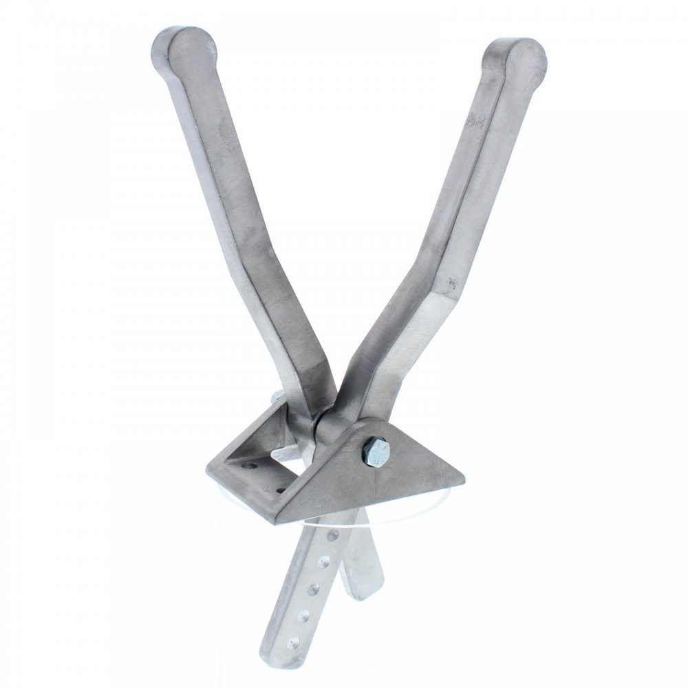

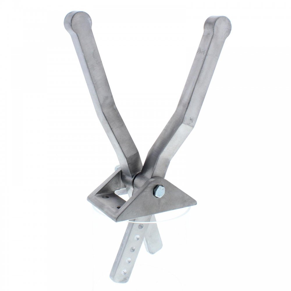

If I ever twin stick a 205, My plan is to use this shifter setup from Speedway motors for $20...
38960
Do you have a part number for anyone interested? That would greatly simplify the DIY portion of it...
Great company to work with too and if you are ever around Lincoln NE they have an awesome car museum. :icon_thumby:
Speedway motors economy shifter 91021950
