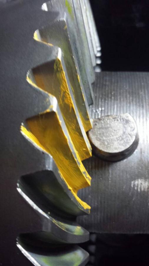

I'm looking for a Lil help.
I've got a new ring and pinion with all new bearings and new bearings on the carrier as well.
I've got the pinion preload at 19-20 spec calls for 14-19 with a .025 pinion shim (OE depth)
Back lash at 11 spec is 12-16
And here's my pattern
Thanks in advance
Hard to really see what's going on with the pattern on that (maybe pinion too shallow, but can't tell for sure).
Try rotating the carrier with a wrench on a ring gear bolt to get your pattern (putting some resistance on the pinion flange with your hand if necessary). This usually creates a higher-contrast pattern than turning it by the pinion.
