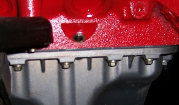

i'll see if i can snap a picture of the hole. it looks stock.. definatly not a custom drilled hole (at least from what it looks like to me)
Well that is certainly a '68' casting. Don't think Ford went to the four bolt dampener till '70-72". Got a casting number on the dampener? Hard telling what's really in that block. That hole you show looks like it was burned in there. Dhould look like below
