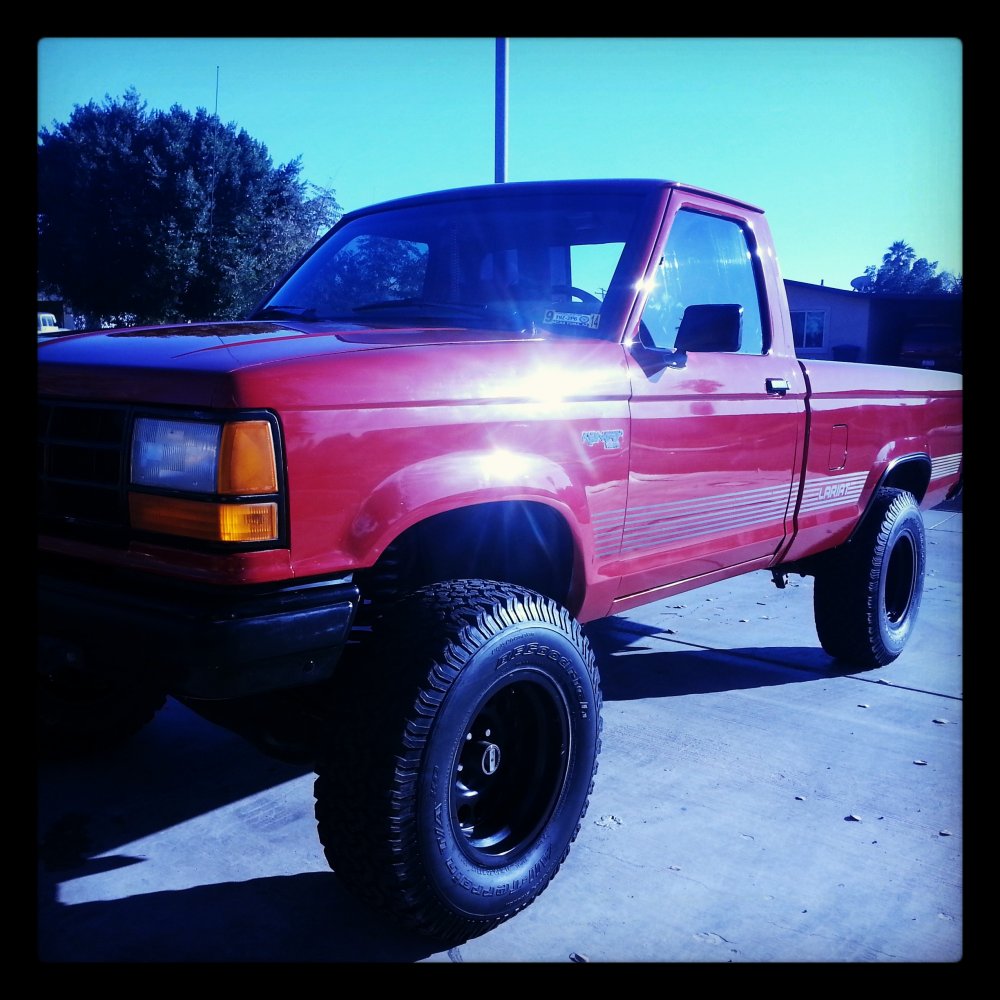

I have a 1990 ford ranger 2.9 5 speed 4x4 long bed that had the radiator fan crumble on I really don’t want to switch to an electric fan I could really use some help on finding one that fits becuase I can’t seem to find one anywhere is there any universal type option or will the 4.0 fan be a direct replacement as they seem to be readily available any help is greatly appreciated thank you
