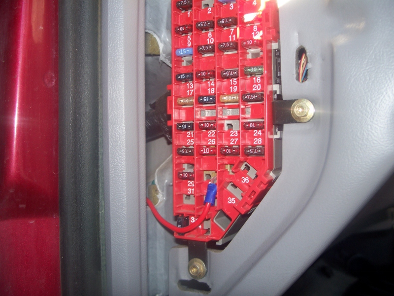

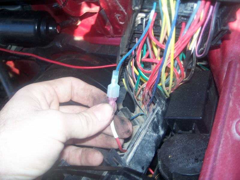

Well I was able to get my fog lights to come on with OUT any of the other lights just the key. Here is what I did. Disconnect NEG side of battery. Under the Power distribution box you will find a butt load of wires. Find the Dark blue DK BLU wire with the Light green LT GRN stripe. Cut that wire in two. The half of the wire that goes back to the truck I capped it off. The one that goes back into the power distribution box is where you connect a wire to. I ran the wire that I connected to the Dark blue/light green wire to the fuse box inside the truck to a key on power. Reconnect the battery and you should be all good to go. Try the fog light switch it should / will work just like it did when you had your headlights on, only now it does it with just the key on. No lights/running lights/low lights/high lights/just the key on and off with the key off.
