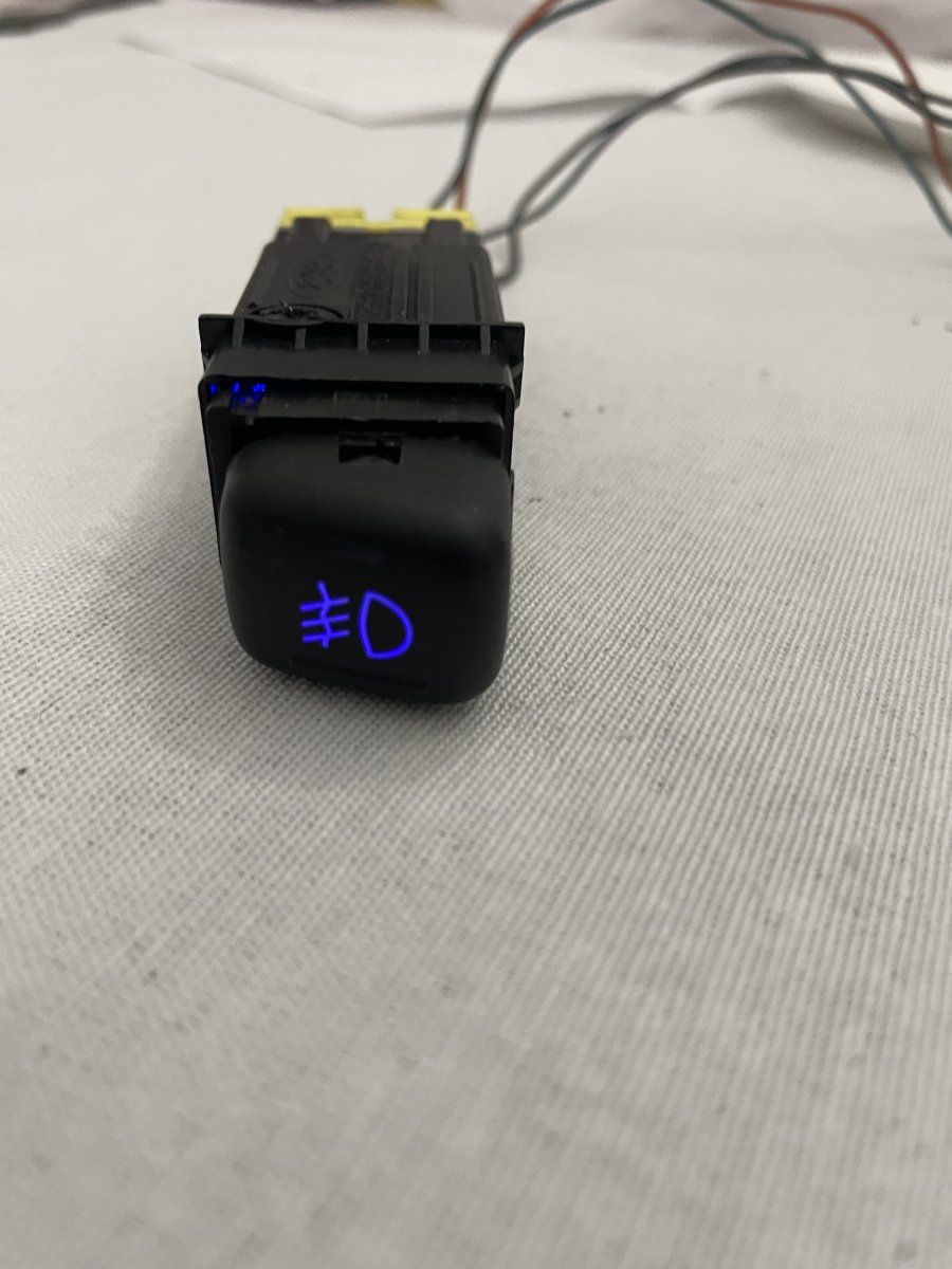

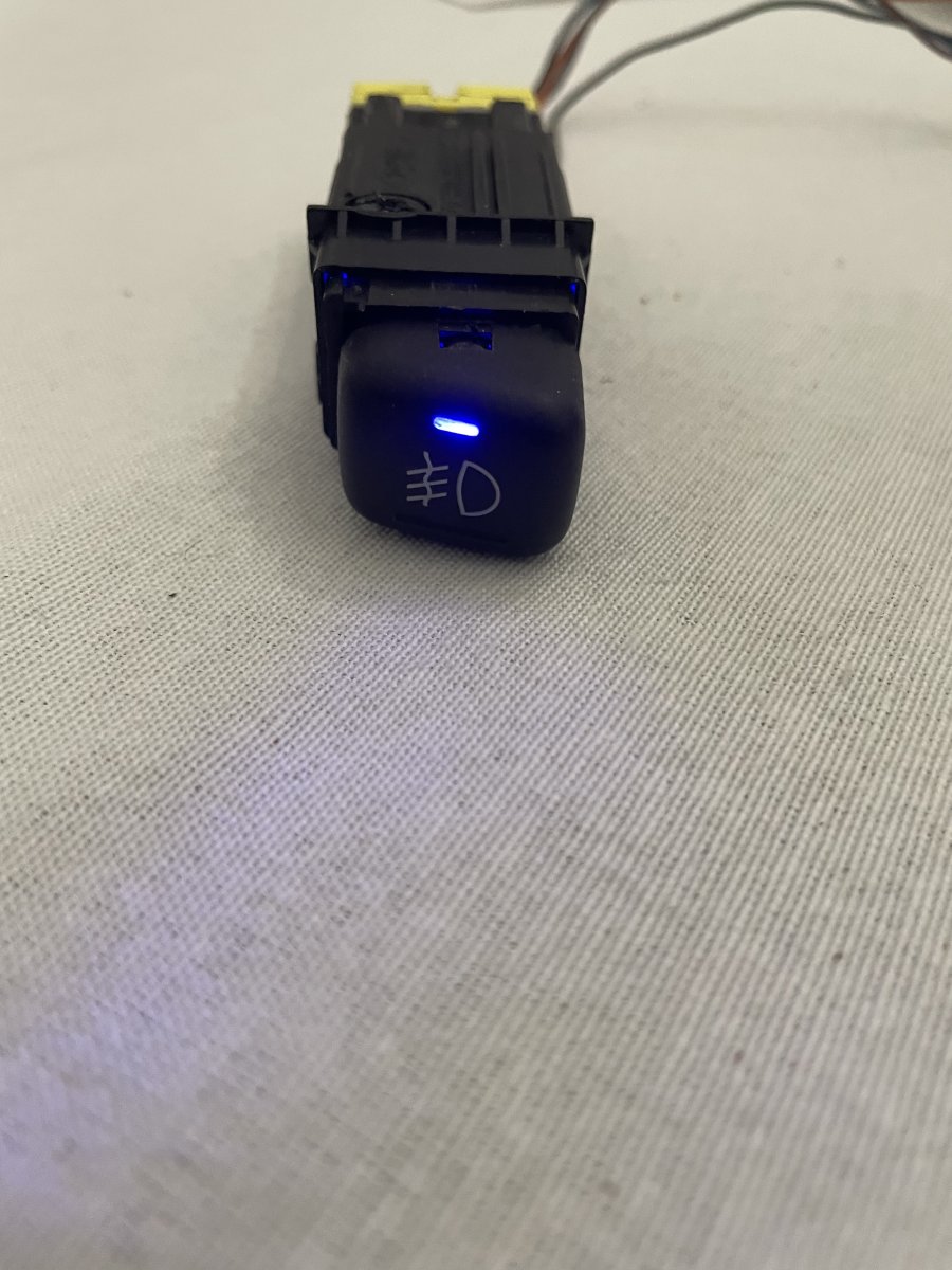

I just saw this. Maybe the GEM makes it momentary, not the switch? I opened up the defroster and fog switches and they look the same. I moded the defroster switch with blue LEDs and put a fog button on it. To satisfy my curiosity, I may just have to try it.
