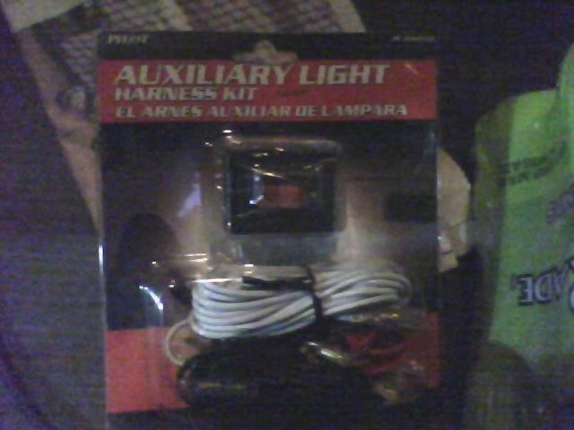

I just have one question, Do I really need the relay? I bought a wiring kit from A-zone (pic below) and all it has is a 15 amp fuse. I really don't feel like tapping into wires since I don't know which wires do what. I already tapped into the Radio 12V power to adapt the overhead console, so I don't know what else to tap into. I really don't want to use a relay because of the fact that you need to run more wires.
I know it will be harder without relay since the Factory switch runs through Ground, but if I pull it of, will I have any problems? Or do you just recommend to use a relay?

Use the relay - I did it the wrong way and burnt out my switch. It melted the insides into a glob. With that switch, you will have to find a secure place to mount it that is easy to reach - not always easy on the 95 dash, I should know.
It can be done without a relay, but you will have to run a completely new wiring system JUST for the lights.
Good Luck
DITTO on usin the relay!
