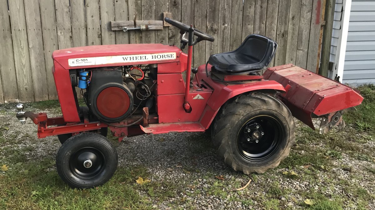

I put ag tires on my wheel horse & filled them with windshield fluid, heavy and works well. It has a rear tiller & front hitch on it. 3 + 2 speed gear drive. Awesome little garden tractor. Put skinny wheelbarrow tires up front, acts like power steering!
