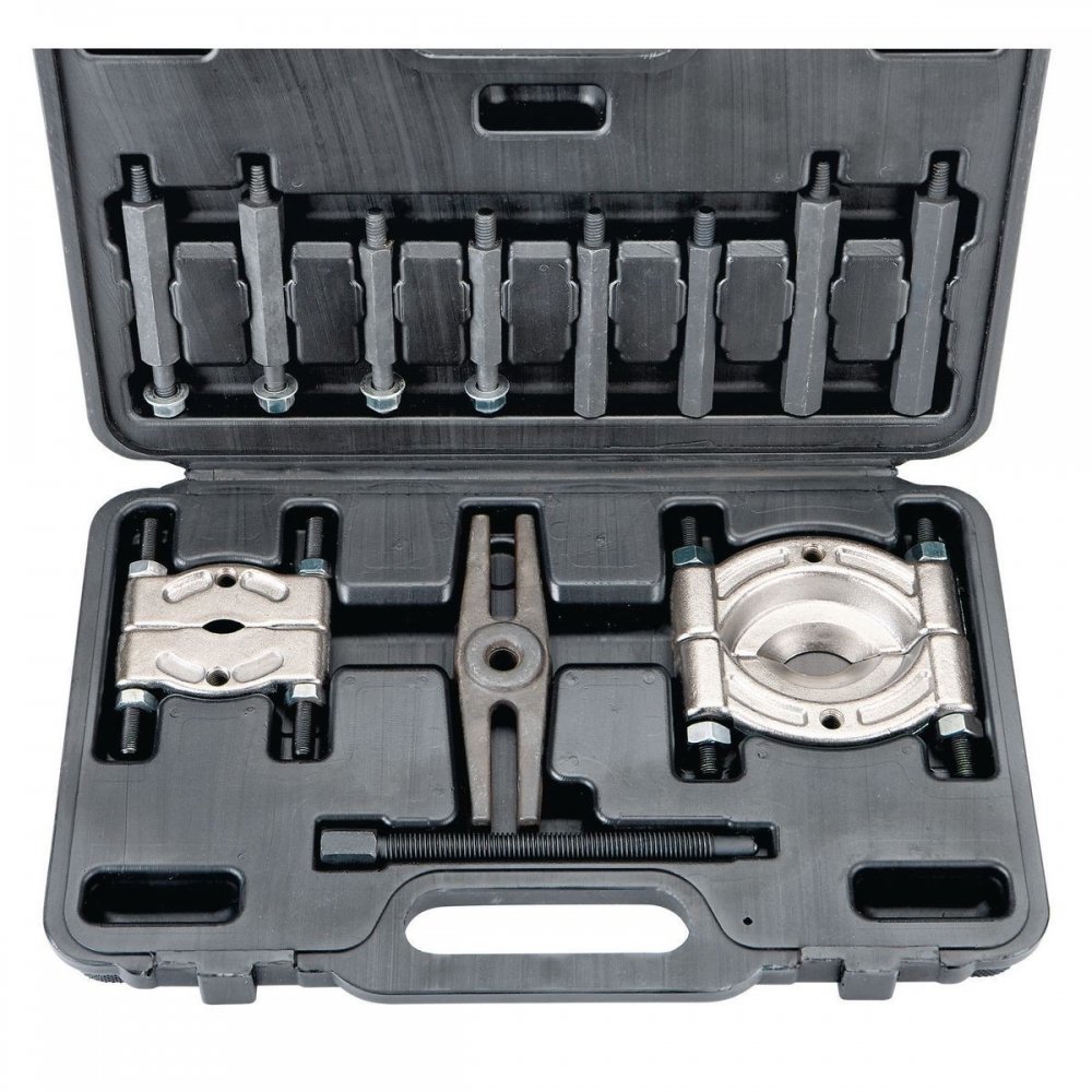

A set up like this will get the job done. Just make sure the size on the separator will meet your needs.

Funny, that was my first thought, I figured I could use my big bearing splitter to grab the snap ring groove... did NOT work! I worked on that stupid thing for over an hour and made zero progress. My splitter is kind of cheap but I bent the all thread I had holding it together.

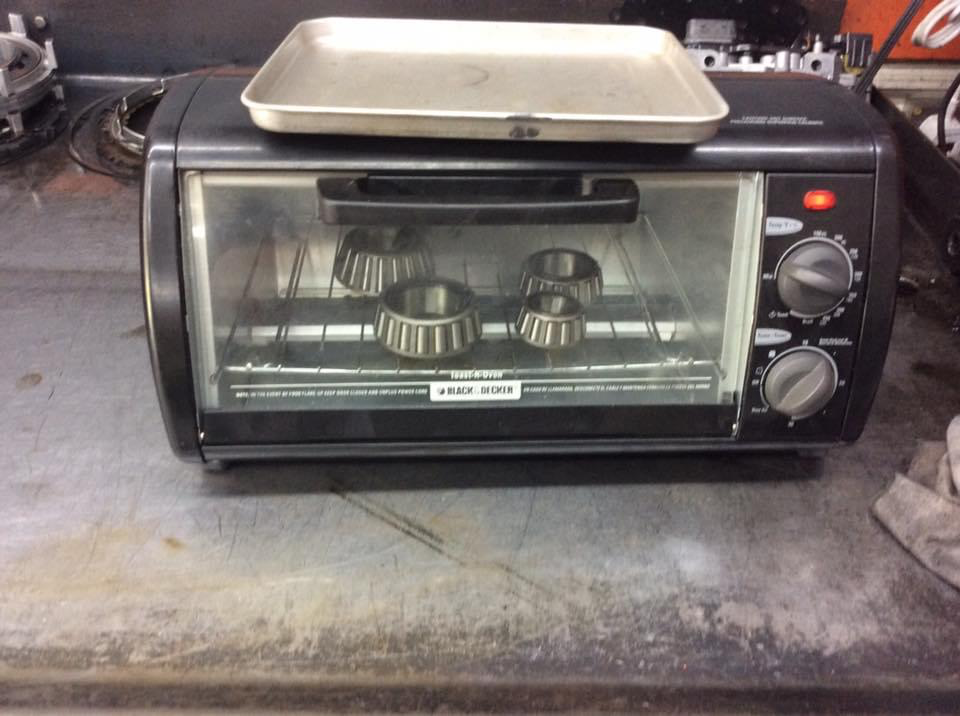

No worries man, glad to help when I can. Just FYI , for ease of putting new bearings on the shafts is to heat them in a toaster oven or on a hot plate. No more than 300 degrees. This is what I use with inferred thermometer.
