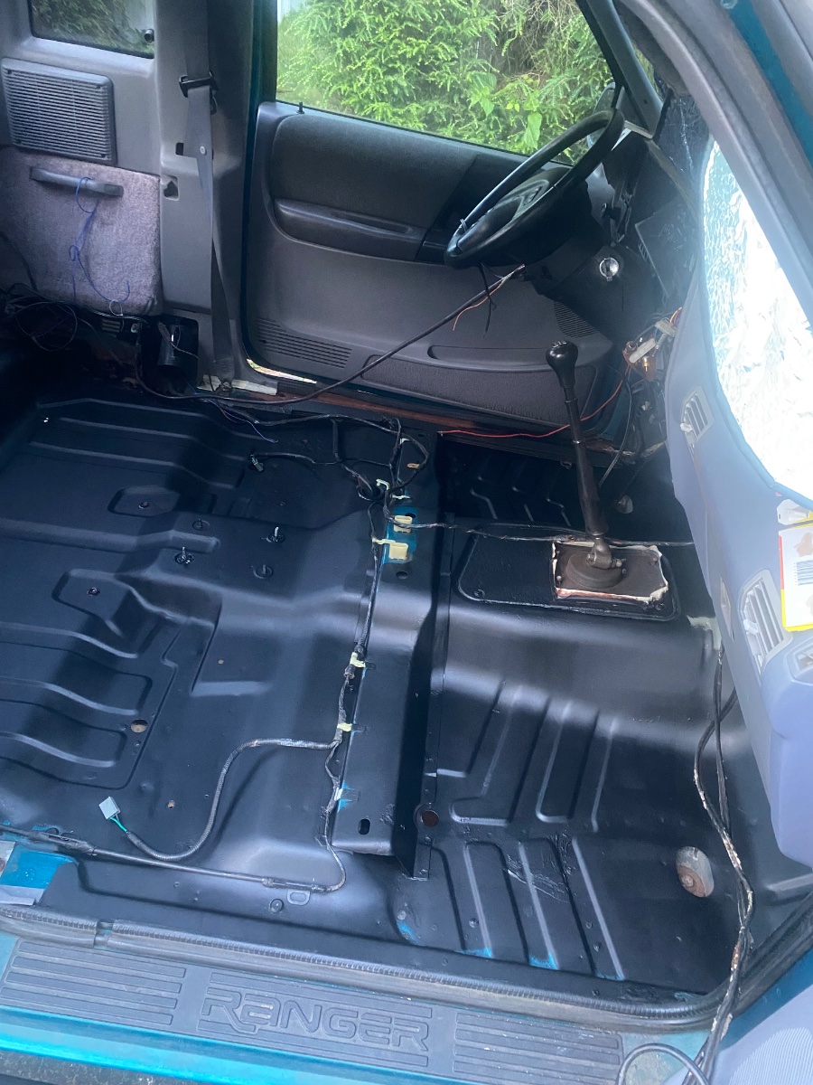

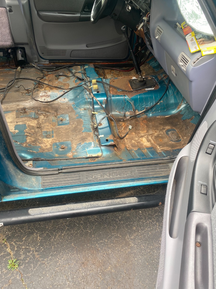

Took the carpet out to pressure wash it, and noticed the floors were rusting from inside out. Treated the rust, primed and painted. How important is the sound deadener. I had to remove the factory stuff to get at the rust.
This is a budget build I’m just trying to make a reliable driver, it was sitting for 20 years.

That's some nice work there.

Wow! I would hate to desicrate that floor with anything. Looks great.
Large flat areas are the main points that will resonate and transmit noise the most. You don't have to cover every square inch. Carpet, itself should dampen and absorb some sound. Try it without and see how much the sound bothers you.
Thanks guys,I think I will try it without any sound deadener for now. I mean there is jute on the back of the carpet so that should quiet it somewhat.
