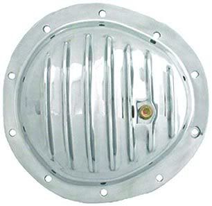

I did a quick search online and found:
A 10-bolt
and
A D44
Hope this helps.

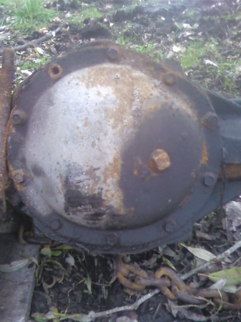

Well, AKBronco had it right on the first guess. After taking a good look at it, the cover definitely looks like a 10 bolt.
Here, Decide for yourself:
Yep, looks like a 10 bolt to me too.
