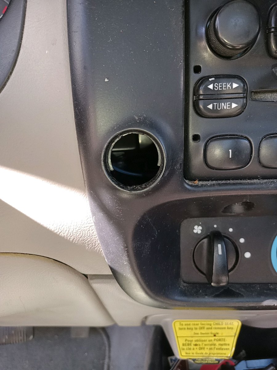

This cig lighter is pushed and fallen inside. I think the plastic clips might have given way. I was thinking of using huge washer that would go over the hole (paint it black to match dashboard). Looking for ideas on how to fix this or maybe swap it out with a usb outlet charger.

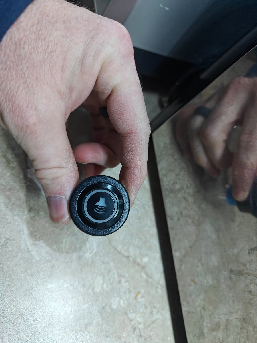

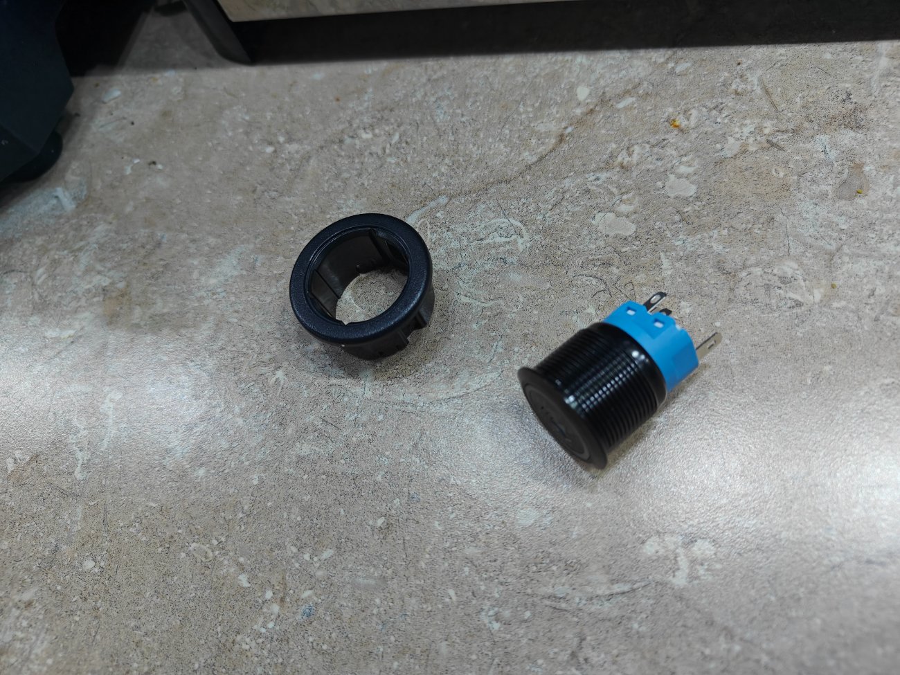

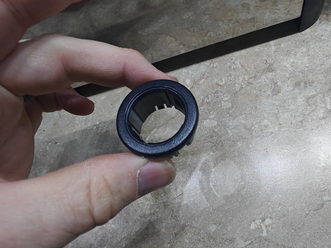

I put a 22mm switch in mine. The trim ring fits it perfectly. Grind down the back some to seat the nut.

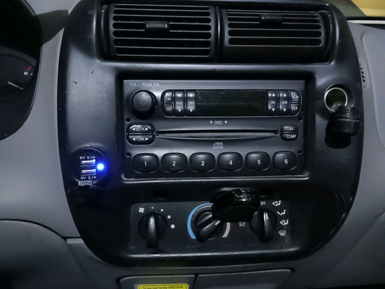

Thanx guys for the different ideas. Fixed this by installing a TEMU $3 usb charger, aided by a Dremel sander. Now the truck has a charging port like it’s the future baby, making the interior tech situation go from roughly “FM radio and a prayer.” IDK why I never did this earlier cos every time I needed to charge the phone I was always fumbling around with a janky adapter that took up the whole right side 12V outlet dangling like a Christmas ornament and this hole on left side just staring back at me like do something. Honestly, for three bucks, it’s the lowest-effort, highest-reward mod.
Thanx guys for the different ideas. Fixed this by installing a TEMU $3 usb charger. EZ PZ. Used a Dremel to sand off the holding "lip" and then this plug slid right into the 12V socket hole, held in place by a fastening ring on the inside. Now the truck has a charging port like it’s the future. Honestly, for three bucks, it’s the lowest-effort, highest-reward mod.
