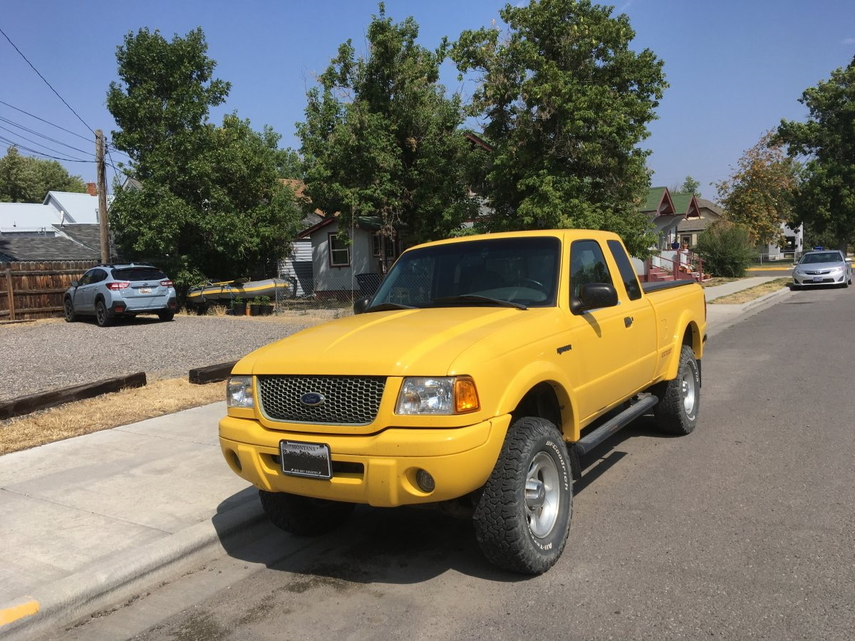

Got my ‘01 Edge 4x4 4.0 SOHC in August 2020 with 196k miles and I’m loving it so far. Its running well but has some minor things that need replaced. I wanna bring it back to great condition, so I’m trying to replace everything I can tell it might need, and do any preventative maintenance I can and learn a lot along the way.

That's a nice looking truck
Yeah I’m really happy with the condition! The previous owner bought it off a kid who moved up here to Montana from Arizona, so the undercarriage is just as pretty!

Nice truck! WOW I'm impressed you even matched the undercarriage to the paint job! Looks absolutely great - the lights go perfect with the thicc stance
For now I'm just worrying about the mechanics - but if I get a good chunk of cash down the road I'll definitely get the exterior touched up and the underside rust proofed.
