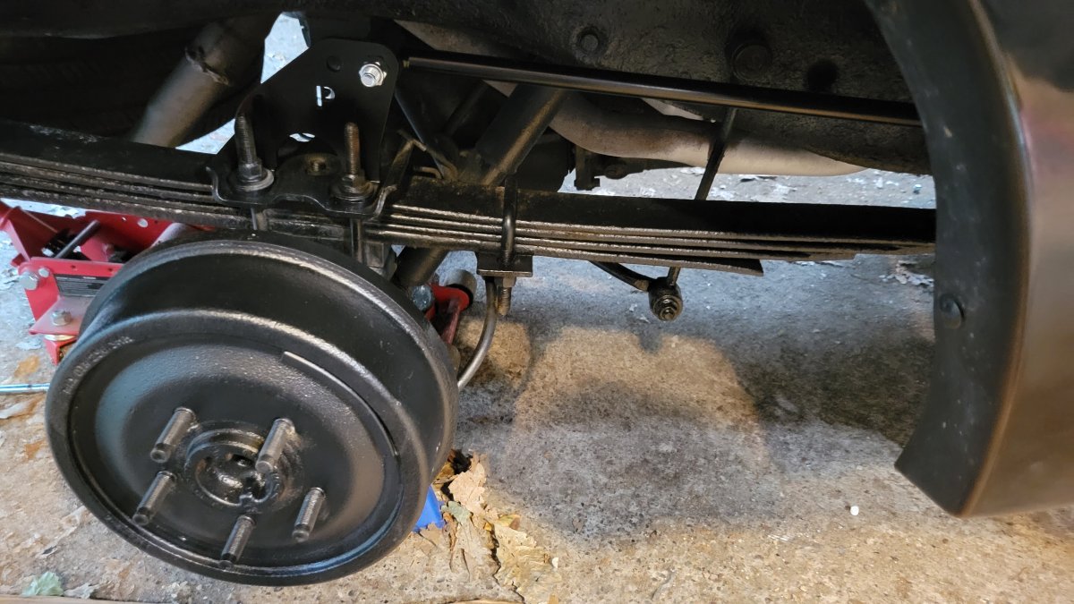

There are a few upgrades you might want to try. The cheapest is a pair of leaf spring clamps ($20.00) which will add a nominal amount of strength to the back. They also work a little like a sway bar, keeping the bed more level on tighter turns.
You might also want to look at suspension products made by James Duff. I rather like his traction bars. They are helpful on rough roads. I like them because they reduce axle wrap and make for a cleaner feeling on shifts.
I prefer a more stable ride with tighter steering. I installed a junkyard 1" Explorer sway bar. Some feel the ride is more harsh. It's a matter of choice. Read the tech library if you are interested.
Note the James Duff traction bar mounted up above the leaf spring. Also note the leaf spring clamp six inches in front of the axle.
Note the one inch thick Explorer sway bar and link pin.
I prefer a more stable ride with tighter steering. I installed a junkyard 1" Explorer sway bar. Some feel the ride is more harsh. It's a matter of choice. Read the tech library if you are interested.View attachment 114624
