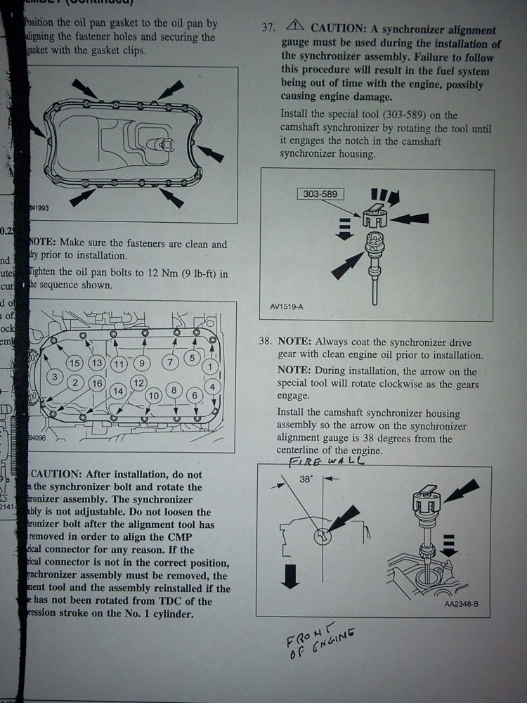

Just learning how to use the site, I saw the pics showing the 38 degree then i responded before I read the thread. Thanks for the educated response. It makes a lot of sense. The alignment tool that came with the sync unit holds the tab just off the center of the cut out. Would it be better if I center the tab before I tighten the hold down bolt ?

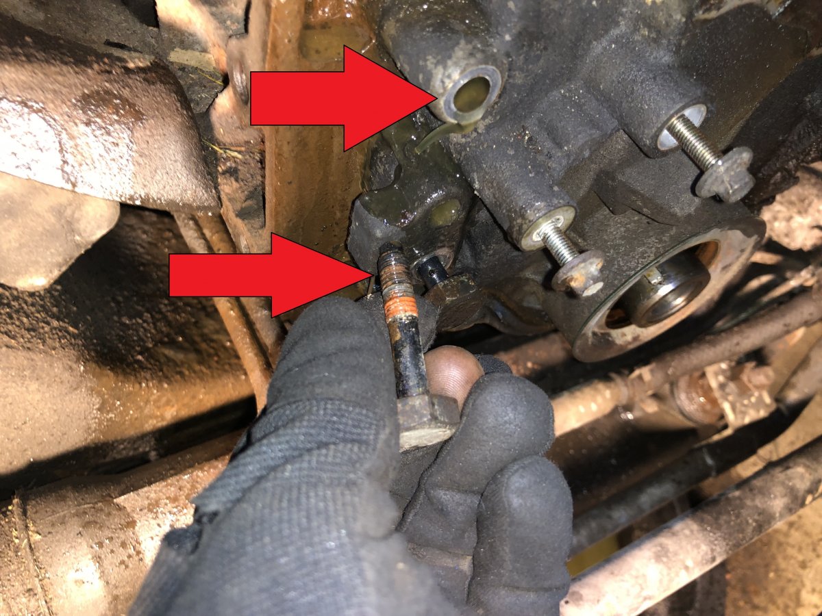

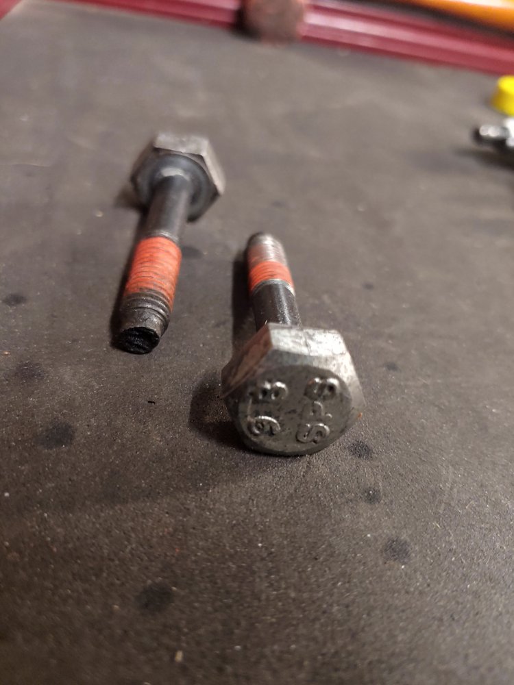

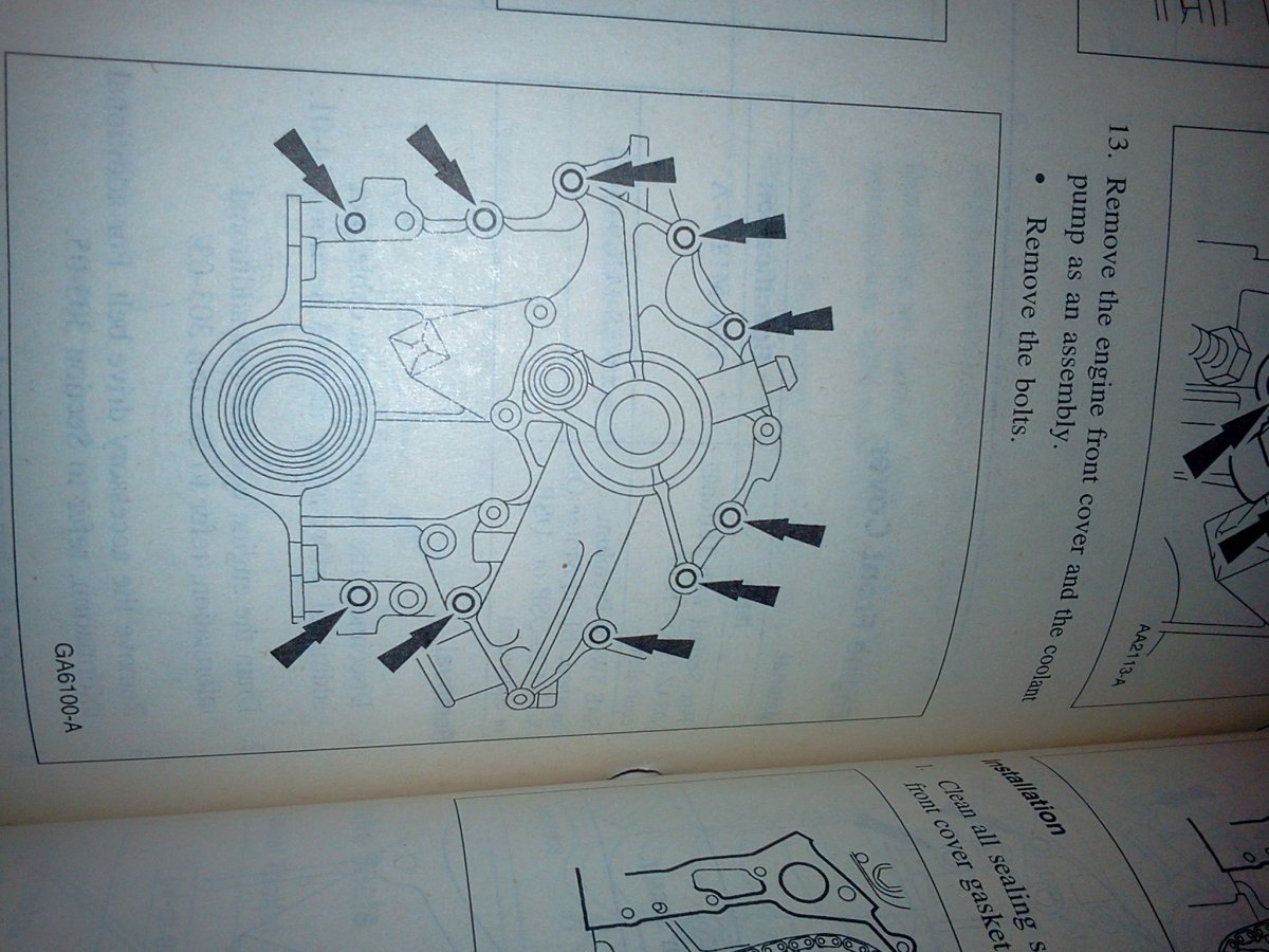

Thank you for your help, I can tell you are an encyclopedia of information with you mechanical knowledge. Not to many people out here to go to. I've got one more thing. I've got a place for two bolts and I have two bolts left, but I'm pretty sure these are not the bolts that go in these holes. The bolts are odd,
8mm with 17mm head, and the 2 holes are at the bottom of the timing chain cover I have marked. Do you know where these bolts go ?

I'll have to go out and look tomorrow at the bolts,,just to be sure. they do go in the lower portion of the timing cover but I want to look before say exactly where.

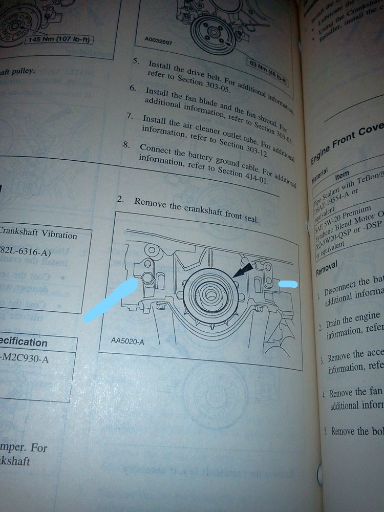

still too lazy to go out and look. but i did find these pics in the manual. it shows the left bolt having a big head.
70105
70107

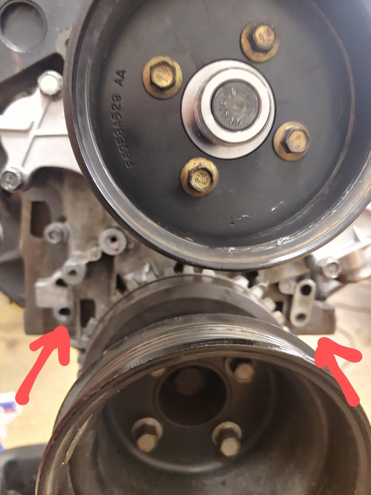

crawled under my 2000, the big headed bolts are in the left(picture) which is the passenger side bottom and next up from bottom.
so mine are both on the bottom left as you look at the engine.
note, the second hole up on each side is for the dowel pins in the block. no screws in those 2 holes.

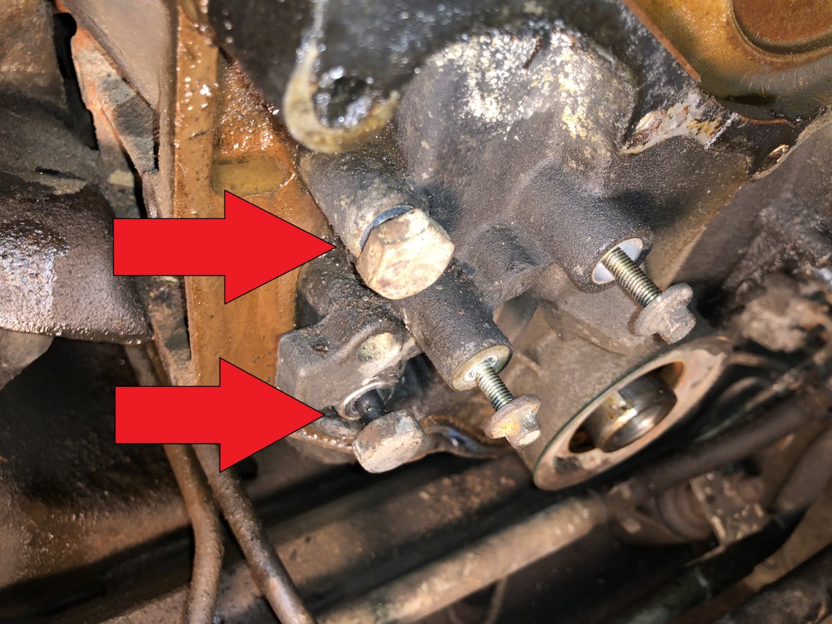

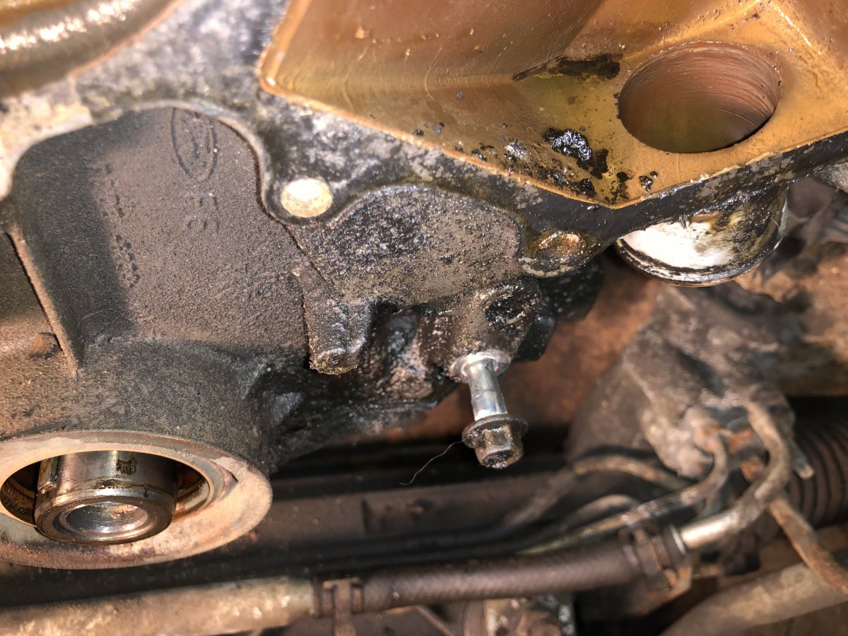

Here are some pics I took when doing work on my truck in December on my 2001. Not the best photos, was just a self note of where some of the bolts went in case I forgot.
But yes, the two larger bolts are on the passenger side, and a smaller one on the driver side.
