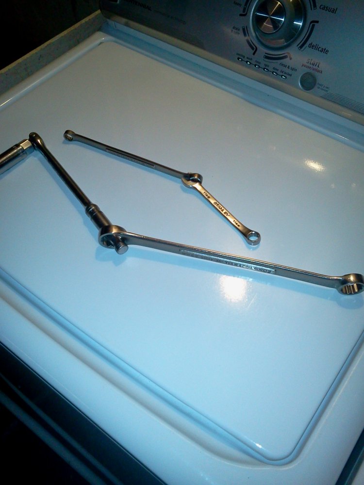

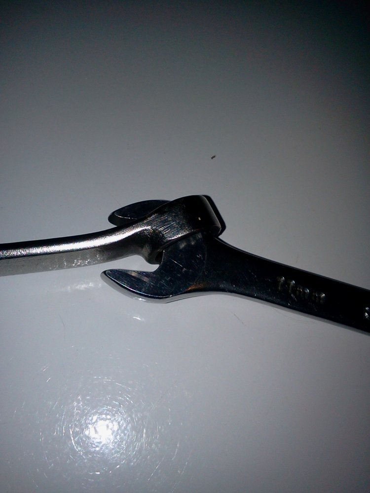

I go to pick up my wrenches at home depot at 6am. The gear head is in the locker. Yes, but not any longer than a typical combo. The extra long double box-end wrench is at the service desk. They hand me a can of lime wash. DO NOT trust home depot for anything important. So what, another week or longer if I can't break the torque with this wrench? I got an 8" pipe that I'll have to squash to make it fit on the wrench. At least I have a propane torch to heat it, but galvanized pipe is pretty tough. Home Depot is incompetent. I don't have time for stupid, like that.
I could've bought a "set" of impact, swivel sockets. $75. I don't think so.
That sucks; sorry to hear that you had trouble with the order. For what it's worth, some of the handiest homemade tools I have are assorted sections of pipe, some flattened, to fit on wrenches and ratchets as a "torque amplifier".
Hang in there, you'll get it done.
like alwaysfloored said, use one wrench to extend the other. get creative with what tools you do have.

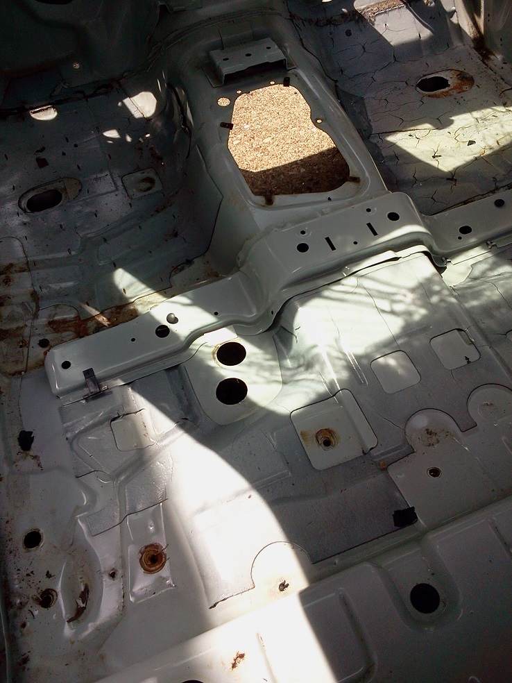

if you remove the shifter floor plate can you access the top bolts thru that hole?

Yes, I've know how to do this for many years, but if you aren't in the best circumstances they'll slip. This is far from an applicable situation for that technique, but I appreciate the suggestion. What do you mean, remove the shifter floor plate? Mine isn't bolted down, it's glued. The image was before I removed the shifter. ...or do you mean remove the tunnel?

As suggested, can my shift covered (glued and stapled in place) be removed so I can access the upper bolts more directly...and then glue it back in effectively?

can't vouch for a 1997, but this is what a 1998 floor looks like. had a big removable plate around the shifter.
