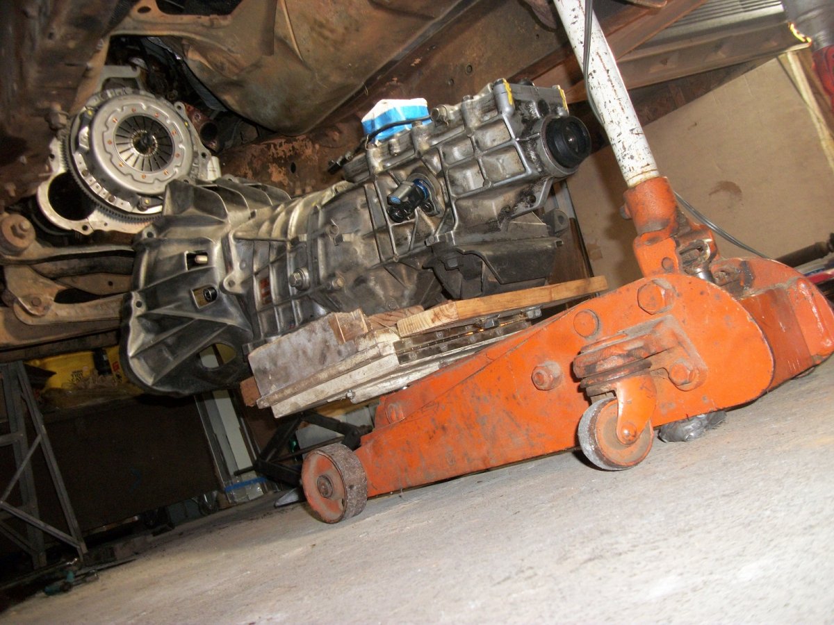

* I use a floor jack with a homemade adapter, just like you're doing:
62505
(but yours looks a hell of lot better than mine, BTW!).
What really helps is to match the angle of the transmission so that it removes and installs as straight as possible to the engine. My "Bubba adapter" is a clam-shell design with a hinge (seen on the rear), and I tap in a plastic wedge on the front to get the angle just right. You can use wood scrap on yours to accomplish the same thing: cradling the mission and matching the angle. I've used the rig in the pic to R&R transmissions behind a 2.3, 2.8, 2.9 and 4.0, autos and manuals. Not pretty, but it has worked fine for me for years.

Your jack works well. I have no clue how mine will. Wedges for front to rear angle is a good idea. I'm still adding some blocks on each side and piece of plywood or siding underneath.
With any luck, I'll use my jack this way one time, put the saddle back on and never see the trans rig again....tho I won't throw it away.

You're doing good. Just make sure the transmission is cradled well or secured to the jack.
Cradled with staps thru the frame?
Sorry; what I meant was, make sure that the transmission is fastened securely to your jack, either by making a cradle of wood scraps on your adapter plate and/or strapping it to jack's adapter plate.
