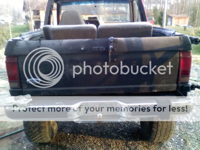

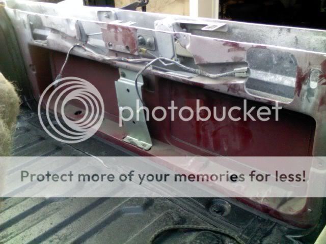

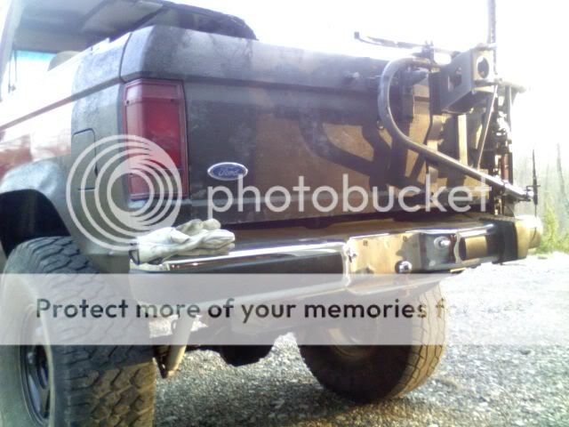

im uploading some pics of my back hatch I cut down and put in place for now to see if I want to just use that and make it swing down or use a ranger tailgate. Im going to get some sheet metal and cover the inside of the tailgate so it will be all smooth looking if i decide to stick with it.
heres some pics... not even close to done. still have alot more in store.

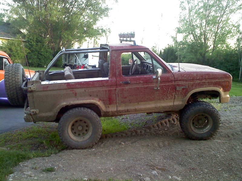

i would do 1.5 thats what mine is and its just the right size i attached a pic of what it looked like when i first got it done last spring. i can take some more close up ones tonight when i go work on the manual swap if you want.
yea man, if you dont mind take some more photos of how its mounted and in the cab part. i need to get some more ideas.

B2Guy can you tell me how the cut down hatch is secured? Maybe some pictures too? Thanks.
Steve
right now the hatch is just latched on like normal which makes it loose on the bottom so im going to have to figure something out to keep it tight...
I wonder if you could use the tailgate hinges from a ranger? Would hold the bottom in place n u still have the BII latch up top?? How are you planning to close the opening at the top where u cut the hatch? Any ideals?
Also can you take some other pictures of the lift gate? Maybe with it off? If possible could you also take some pictures of the cab where you chopped it. Maybe some of the area right behind the seats (part of cab going up, front of the window area) and across top of cab? Different views?
