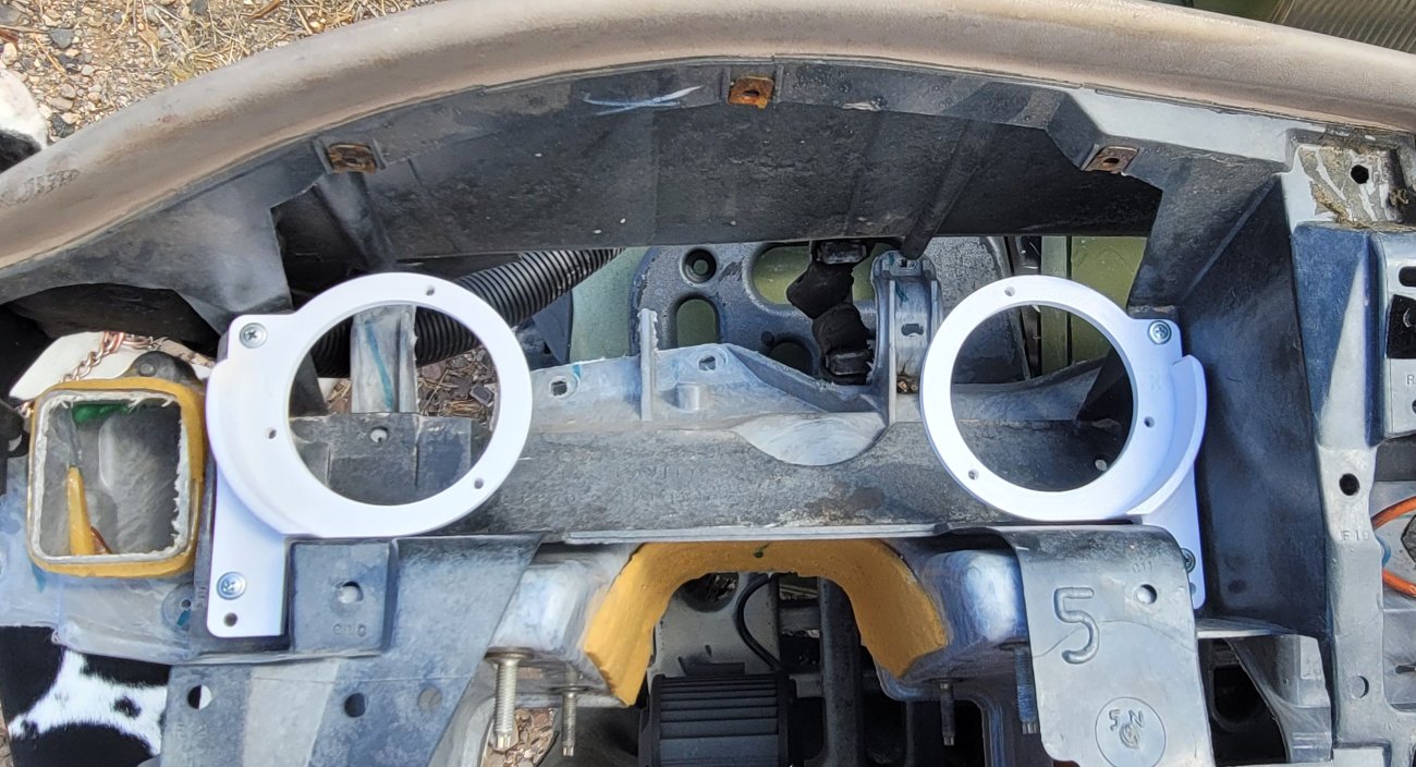

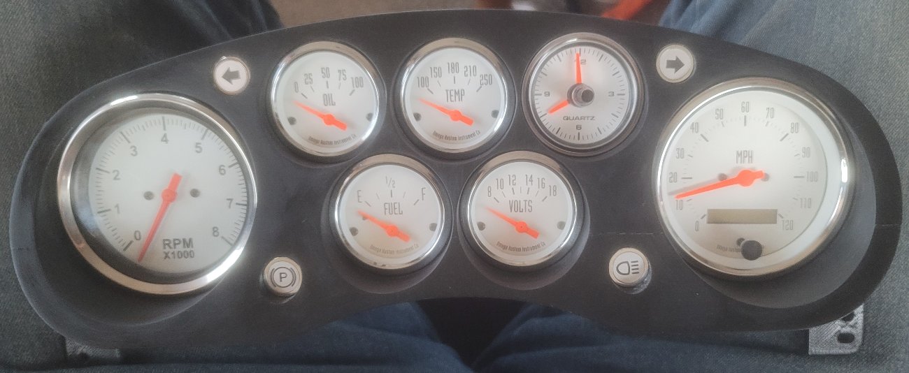

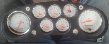

Here's the gauge bezel I modeled up and printed for my 98 ranger I used a set of Omega Kustom gauges from Speedway Motors.
You'll need a pretty big printer to print the bezel, I used an ender 5 plus and had to put it on the build plate diagonally.

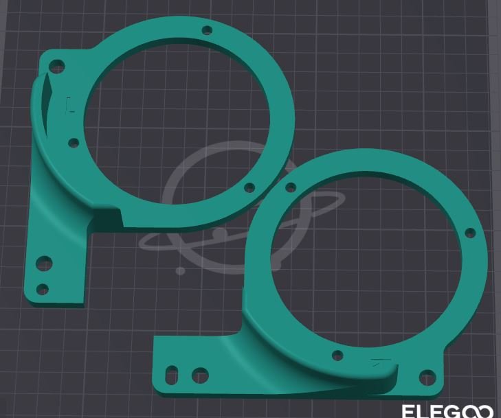

  • Right Flange.stl
    Right Flange.stl
  • Left Flange.stl
    Left Flange.stl

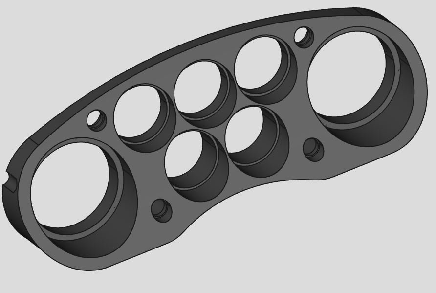

  • Ranger Gauges 7.stl
    Ranger Gauges 7.stl
