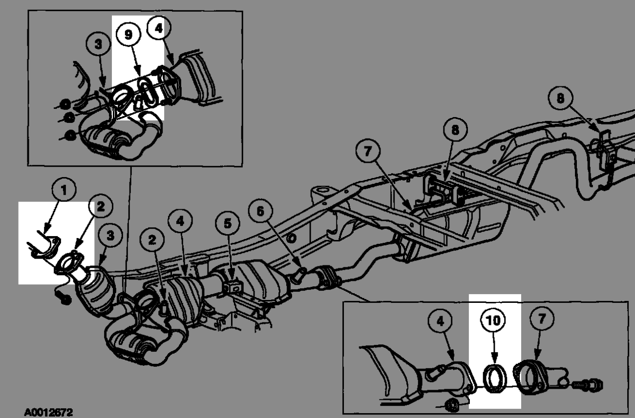

I fighting a number of exhaust leaks. At #1-#2 left and right (exhaust manifold to Y-pipe). At gasket #9 and donut gasket #10.
I've replaced #9 and #10 and re-torqued nuts at #1-#2. But the same leaks remain.
